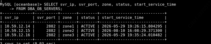

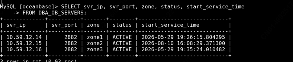

– 3. 查看 server 状态
SELECT svr_ip, svr_port, zone, status, start_service_time
FROM DBA_OB_SERVERS;

3、
用这两个命令 修复一下副本PAXOS 成员信息
ALTER SYSTEM REMOVE REPLICA LS = 1 SERVER = ‘10.59.12.15:2882’ PAXOS_REPLICA_NUM = 2 TENANT = ‘CMDBXZZC’;
ALTER SYSTEM REMOVE REPLICA LS = 1001 SERVER = ‘10.59.12.15:2882’ PAXOS_REPLICA_NUM = 2 TENANT = ‘CMDBXZZC’;
