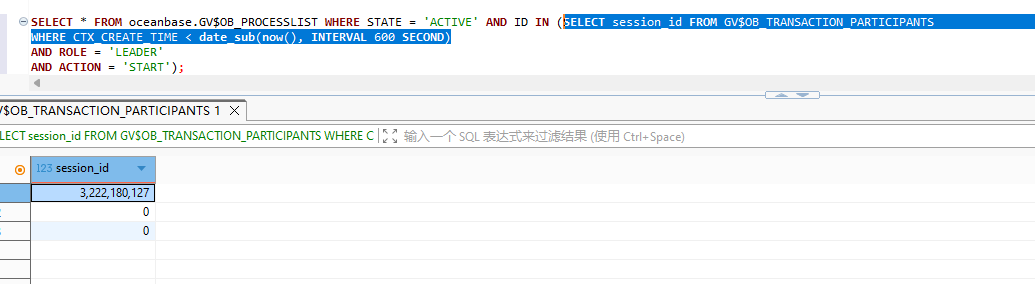

SHOW VARIABLES like ‘version_comment’; 具体的版本信息查看一下 可以查看一下长事务的信息
SELECT *
FROM GV$OB_TRANSACTION_PARTICIPANTS
WHERE CTX_CREATE_TIME < date_sub(now(), INTERVAL 600 SECOND)
AND ROLE = ‘LEADER’
AND ACTION = ‘START’;

SELECT *
AND ROLE = ‘LEADER’
TENANT_ID|SVR_IP |SVR_PORT|SESSION_ID|SCHEDULER_ADDR |TX_TYPE |TX_ID |LS_ID|PARTICIPANTS|CTX_CREATE_TIME |TX_EXPIRED_TIME |STATE |ACTION|PENDING_LOG_SIZE|FLUSHED_LOG_SIZE|ROLE |COORD|LAST_REQUEST_TIME |FORMATID|GLOBALID|BRANCHID|
1002|172.14.202.52| 2882|3221539899|“172.14.202.52:2882”|UNDECIDED|29051501| 1| |2025-11-24 17:21:31.765|2025-11-25 17:21:31.761|ACTIVE|START | 0| 0|LEADER| -1|2025-11-24 17:21:31.765| -1| | |

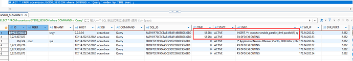

昨天清掉了 今天又有新的

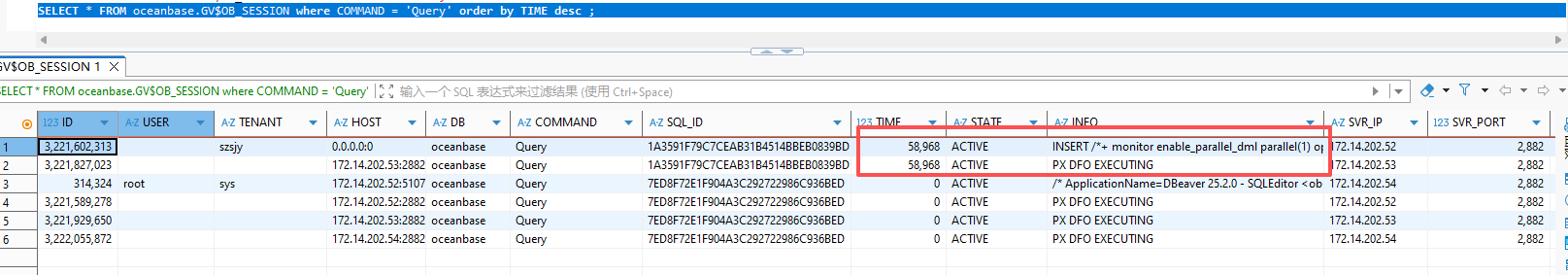

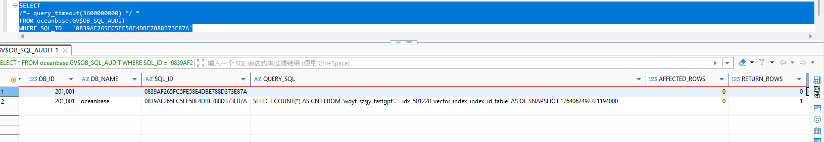

INSERT /*+ monitor enable_parallel_dml parallel(1) opt_param(‘ddl_execution_id’, 1) opt_param(‘ddl_task_id’, 36033726) opt_param(‘enable_newsort’, ‘false’) use_px /INTO wdyf_szsjy_fastgpt.__idx_501228_idx_1764062492773017_index_snapshot_data_table (__key_17_1761297681614082, __vid_1761297679523485, __vector_17_1761297680423739, __data_17_1761297681614480) SELECT /+ index(modeldata primary) ob_ddl_schema_version(modeldata, 1764062764008680) */ __key_17_1761297681614082 AS __key_17_1761297681614082, __vid_1761297679523485 AS __vid_1761297679523485, __vector_17_1761297680423739 AS __vector_17_1761297680423739, __data_17_1761297681614480 AS __data_17_1761297681614480 from wdyf_szsjy_fastgpt.modeldata as of snapshot 1764062821489761000 order by 1
这是内部生成的sql吗 每天固定时间执行十几个小时

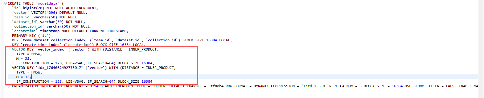

CREATE TABLE modeldata (
id bigint(20) NOT NULL AUTO_INCREMENT,
vector VECTOR(4096) DEFAULT NULL,
team_id varchar(50) NOT NULL,
dataset_id varchar(50) NOT NULL,
collection_id varchar(50) NOT NULL,
createtime timestamp NULL DEFAULT CURRENT_TIMESTAMP,
PRIMARY KEY (id),
KEY team_dataset_collection_index (team_id, dataset_id, collection_id) BLOCK_SIZE 16384 LOCAL,
KEY create_time_index (createtime) BLOCK_SIZE 16384 LOCAL,
VECTOR KEY vector_index (vector) WITH (DISTANCE = INNER_PRODUCT,
TYPE = HNSW,
M = 32,
EF_CONSTRUCTION = 128, LIB=VSAG, EF_SEARCH=64) BLOCK_SIZE 16384,
VECTOR KEY idx_1764062492773017 (vector) WITH (DISTANCE = INNER_PRODUCT,
TYPE = HNSW,
M = 32,
) ORGANIZATION INDEX AUTO_INCREMENT = 916044 AUTO_INCREMENT_MODE = ‘ORDER’ DEFAULT CHARSET = utf8mb4 ROW_FORMAT = DYNAMIC COMPRESSION = ‘zstd_1.3.8’ REPLICA_NUM = 3 BLOCK_SIZE = 16384 USE_BLOOM_FILTER = FALSE ENABLE_MACRO_BLOCK_BLOOM_FILTER = FALSE TABLET_SIZE = 134217728 PCTFREE = 0;

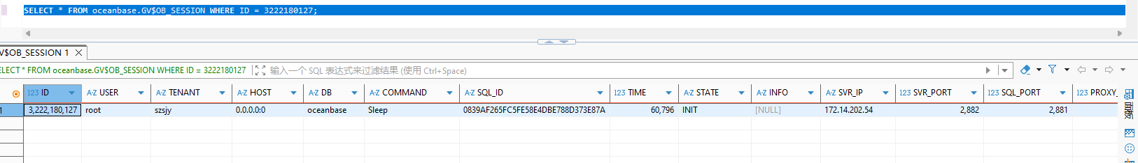

idx_1764062492773017 是数据库生成的吗 业务说没建这个

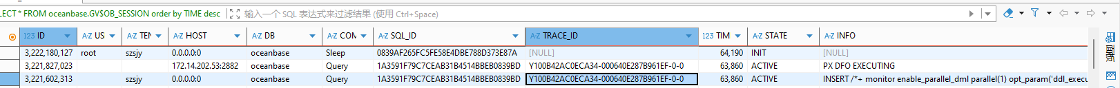

你们查到的长事务的语句 是这个插入的语句么?

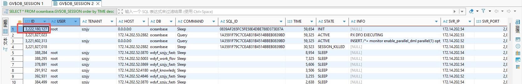

差不到是哪个sql 看SESSION表猜测的
告警的是3222180127会话 但是他没有sql

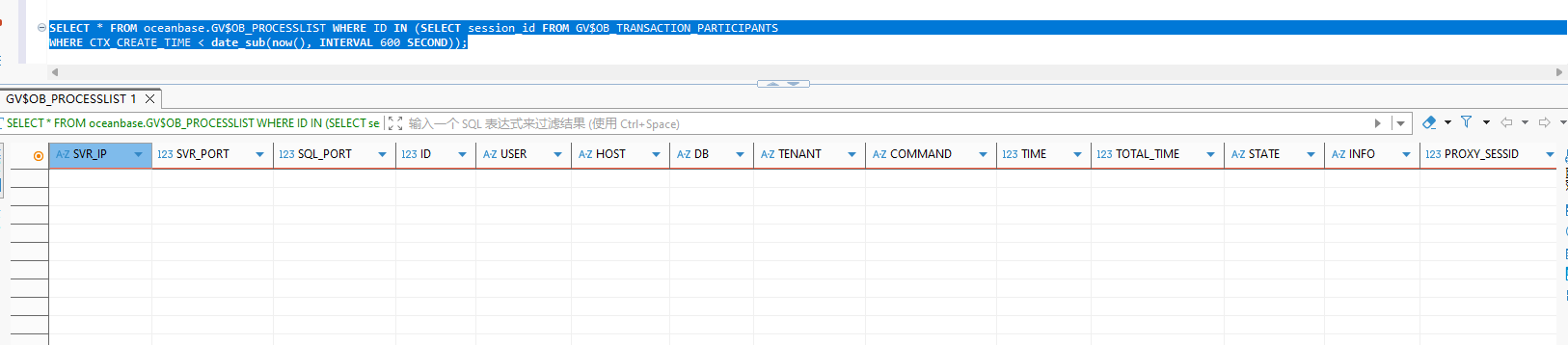

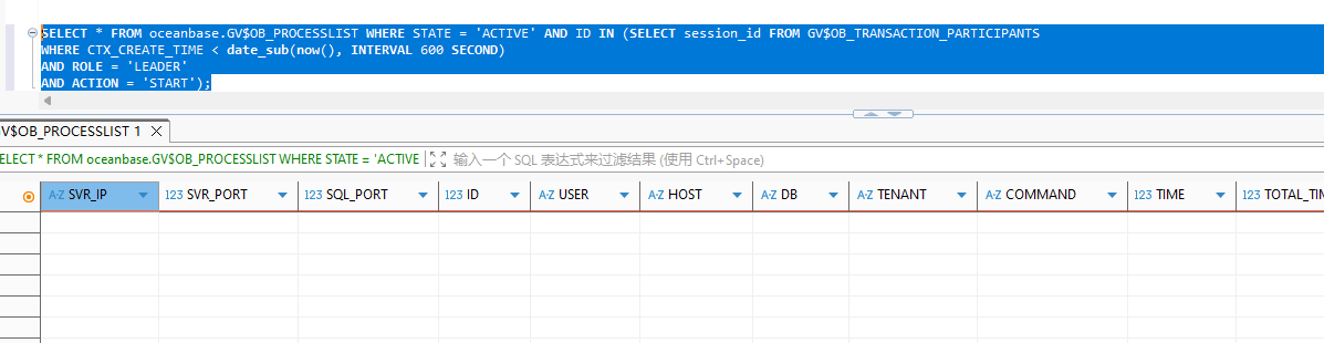

SELECT * FROM oceanbase.GV$OB_PROCESSLIST WHERE STATE = ‘ACTIVE’ AND ID IN (SELECT session_id FROM GV$OB_TRANSACTION_PARTICIPANTS
AND ROLE = ‘LEADER’
AND ACTION = ‘START’);
–可以这样查一下 看看 是哪个语句
空的
