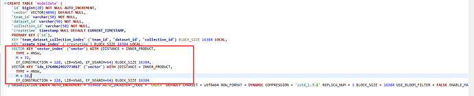

CREATE TABLE modeldata (
id bigint(20) NOT NULL AUTO_INCREMENT,
vector VECTOR(4096) DEFAULT NULL,
team_id varchar(50) NOT NULL,
dataset_id varchar(50) NOT NULL,
collection_id varchar(50) NOT NULL,
createtime timestamp NULL DEFAULT CURRENT_TIMESTAMP,
PRIMARY KEY (id),
KEY team_dataset_collection_index (team_id, dataset_id, collection_id) BLOCK_SIZE 16384 LOCAL,
KEY create_time_index (createtime) BLOCK_SIZE 16384 LOCAL,
VECTOR KEY vector_index (vector) WITH (DISTANCE = INNER_PRODUCT,
TYPE = HNSW,
M = 32,
EF_CONSTRUCTION = 128, LIB=VSAG, EF_SEARCH=64) BLOCK_SIZE 16384,
VECTOR KEY idx_1764062492773017 (vector) WITH (DISTANCE = INNER_PRODUCT,
TYPE = HNSW,
M = 32,
) ORGANIZATION INDEX AUTO_INCREMENT = 916044 AUTO_INCREMENT_MODE = ‘ORDER’ DEFAULT CHARSET = utf8mb4 ROW_FORMAT = DYNAMIC COMPRESSION = ‘zstd_1.3.8’ REPLICA_NUM = 3 BLOCK_SIZE = 16384 USE_BLOOM_FILTER = FALSE ENABLE_MACRO_BLOCK_BLOOM_FILTER = FALSE TABLET_SIZE = 134217728 PCTFREE = 0;
idx_1764062492773017 是数据库生成的吗 业务说没建这个

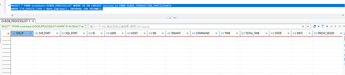

SELECT * FROM oceanbase.GV$OB_PROCESSLIST WHERE STATE = ‘ACTIVE’ AND ID IN (SELECT session_id FROM GV$OB_TRANSACTION_PARTICIPANTS
WHERE CTX_CREATE_TIME < date_sub(now(), INTERVAL 600 SECOND)
AND ROLE = ‘LEADER’
AND ACTION = ‘START’);
–可以这样查一下 看看 是哪个语句
空的
那有可能该长事务的session不是active 你这样查一下
SELECT * FROM oceanbase.GV$OB_PROCESSLIST WHERE ID IN (SELECT session_id FROM GV$OB_TRANSACTION_PARTICIPANTS
AND ROLE = ‘LEADER’
条件都去掉也没有

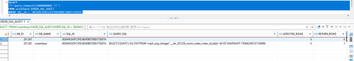

根据这个sql_id查一下gv$ob_sql_audit看看
SVR_IP |SVR_PORT|REQUEST_ID|SQL_EXEC_ID|TRACE_ID |SID |CLIENT_IP|CLIENT_PORT|TENANT_ID|TENANT_NAME|EFFECTIVE_TENANT_ID|USER_ID|USER_NAME|USER_GROUP|USER_CLIENT_IP|DB_ID |DB_NAME |SQL_ID |QUERY_SQL |AFFECTED_ROWS|RETURN_ROWS|PLAN_ID|PARTITION_CNT|RET_CODE|QC_ID|DFO_ID|SQC_ID|WORKER_ID|EVENT|P1TEXT|P1|P2TEXT|P2|P3TEXT|P3|LEVEL|WAIT_CLASS_ID|WAIT_CLASS#|WAIT_CLASS|STATE |WAIT_TIME_MICRO|TOTAL_WAIT_TIME_MICRO|TOTAL_WAITS|RPC_COUNT|PLAN_TYPE|IS_INNER_SQL|IS_EXECUTOR_RPC|IS_HIT_PLAN|REQUEST_TIME |ELAPSED_TIME|NET_TIME|NET_WAIT_TIME|QUEUE_TIME|DECODE_TIME|GET_PLAN_TIME|EXECUTE_TIME|APPLICATION_WAIT_TIME|CONCURRENCY_WAIT_TIME|USER_IO_WAIT_TIME|SCHEDULE_TIME|ROW_CACHE_HIT|BLOOM_FILTER_CACHE_HIT|BLOCK_CACHE_HIT|DISK_READS|RETRY_CNT|TABLE_SCAN|CONSISTENCY_LEVEL|MEMSTORE_READ_ROW_COUNT|SSSTORE_READ_ROW_COUNT|DATA_BLOCK_READ_CNT|DATA_BLOCK_CACHE_HIT|INDEX_BLOCK_READ_CNT|INDEX_BLOCK_CACHE_HIT|BLOCKSCAN_BLOCK_CNT|BLOCKSCAN_ROW_CNT|PUSHDOWN_STORAGE_FILTER_ROW_CNT|REQUEST_MEMORY_USED|EXPECTED_WORKER_COUNT|USED_WORKER_COUNT|SCHED_INFO|FUSE_ROW_CACHE_HIT|PS_CLIENT_STMT_ID|PS_INNER_STMT_ID|TX_ID |SNAPSHOT_VERSION |REQUEST_TYPE|IS_BATCHED_MULTI_STMT|OB_TRACE_INFO|PLAN_HASH |LOCK_FOR_READ_TIME|PARAMS_VALUE|RULE_NAME|PARTITION_HIT|TX_INTERNAL_ROUTING|TX_STATE_VERSION|FLT_TRACE_ID|PL_TRACE_ID|PLSQL_EXEC_TIME|FORMAT_SQL_ID|STMT_TYPE|TOTAL_MEMSTORE_READ_ROW_COUNT|TOTAL_SSSTORE_READ_ROW_COUNT|PROXY_USER|SEQ_NUM |NETWORK_WAIT_TIME|PLSQL_COMPILE_TIME|
172.14.202.53| 2882| 165984| -1|YB42AC0ECA34-000640E287B961EF-0-0|3221816523|0.0.0.0 | 0| 1002| | 1002| 200001| | 0|0.0.0.0 |201001| |0839AF265FC5FE58E4DBE788D373E87A| | 0| 0| 1172| 0| 0| 0| 0| 0| 0| | | 0| | 0| | 0| 0| 100| 0|OTHER |MAX_WAIT TIME ZERO| 0| 0| 0| 0| 1| 1| 1| 1|1764062492750963| 18875| 172| 20| 68| 233| 0| 3848| 0| 0| 0| 0| 0| 0| 0| 0| 0| 0| 3| 0| 0| 3| 0| 1| 0| 3| 4602| 0| 2503880| 0| 0| | 0| -1| -1| 0| 0| 3| 0| | 0| 0| | | 1| 0| 0| | | 0| |SELECT | 0| 0| | 0| 0| 0|
172.14.202.54| 2882| 28181098| 182213313|YB42AC0ECA34-000640E287B961EF-0-0|3222180127|0.0.0.0 | 0| 1002|szsjy | 1002| 200001|root | 0|0.0.0.0 |201001|oceanbase|0839AF265FC5FE58E4DBE788D373E87A|SELECT COUNT(*) AS CNT FROM wdyf_szsjy_fastgpt.__idx_501228_vector_index_index_id_table AS OF SNAPSHOT 1764062492721194000| 0| 1| 64399| 1| 0| 0| 0| 0| 0| | | 0| | 0| | 0| 0| 100| 0|OTHER |MAX_WAIT TIME ZERO| 0| 19978| 2| 2| 2| 1| 0| 0|1764062492747967| 22291| 0| 0| 0| 0| 2105| 20186| 0| 0| 0| 0| 0| 0| 0| 0| 0| 1| 3| 0| 0| 0| 0| 0| 0| 0| 0| 0| 117591056| 0| 0| | 0| -1| -1|32017765|1764062492749855000| 1| 0| |5717739935154354293| 0| | | 0| 0| 0| | | 0| |SELECT | 0| 0| |1764062492749856| 0| 0|
这个看着是你们的库呀 不像是内部的库的信息呀 看着像是在闪回查询呀

这个insert是在干啥啊 每天同一时间生成 也跑了十几个小时 这个表一共才89w记录 看TRACE_ID感觉跟那个select有点关联 而且这表两个一样的VECTOR索引 删掉idx那个 自己又创建
这个看着是向量索引的用法
