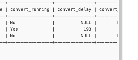

MySQL [(none)]> show binlog instances;
| name       | ob_cluster  | ob_tenant | ip            | port | zone | region | group | running | state   | obcdc_running | obcdc_state | service_mode | convert_running | convert_delay | convert_rps | convert_eps | convert_iops | dumpers | version                                         | odp_addr |
| c9a3jwsy4h | ob-abd72194 | tpmom     | 10.210.xxx.x5 | 8100 |      |        |       | Yes     | Running | Yes           | Running     | enabled      | No              |          NULL |        NULL |        NULL |         NULL |    NULL | 4.2.10-a6346ceda92b1a56b88a3f58493784ae40b9a982 | NULL     |
| cwp7jqrqxg | ob-abd72194 | tpmom     | 10.210.xxx.x3 | 8100 |      |        |       | Yes     | Running | Yes           | Running     | enabled      | Yes             |           193 |         351 |         595 |       206350 |       0 | 4.2.10-a6346ceda92b1a56b88a3f58493784ae40b9a982 | NULL     |
| mxjxcdp6v1 | ob-abd72194 | tpmom     | 10.210.xxx.x4 | 8100 |      |        |       | Yes     | Running | Yes           | Running     | enabled      | No              |          NULL |        NULL |        NULL |         NULL |    NULL | 4.2.10-a6346ceda92b1a56b88a3f58493784ae40b9a982 | NULL     |
3 rows in set (0.01 sec)

版本看着是支持的
但是看着转化的这个状态有问题呀
