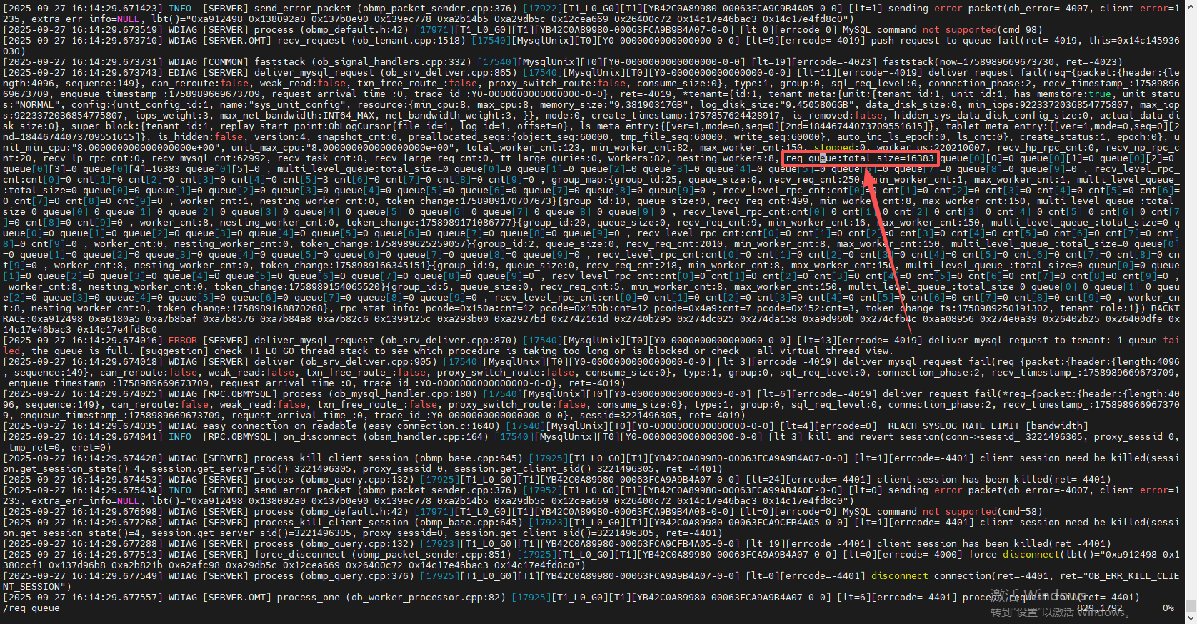

[2025-09-27 16:14:29.674016] ERROR [SERVER] deliver_mysql_request (ob_srv_deliver.cpp:870) [17540][MysqlUnix][T0][Y0-0000000000000000-0-0] [lt=13][errcode=-4019] deliver mysql request to tenant: 1 queue failed, the queue is full. [suggestion] check T1_L0_G0 thread stack to see which procedure is taking too long or is blocked or check __all_virtual_thread view.

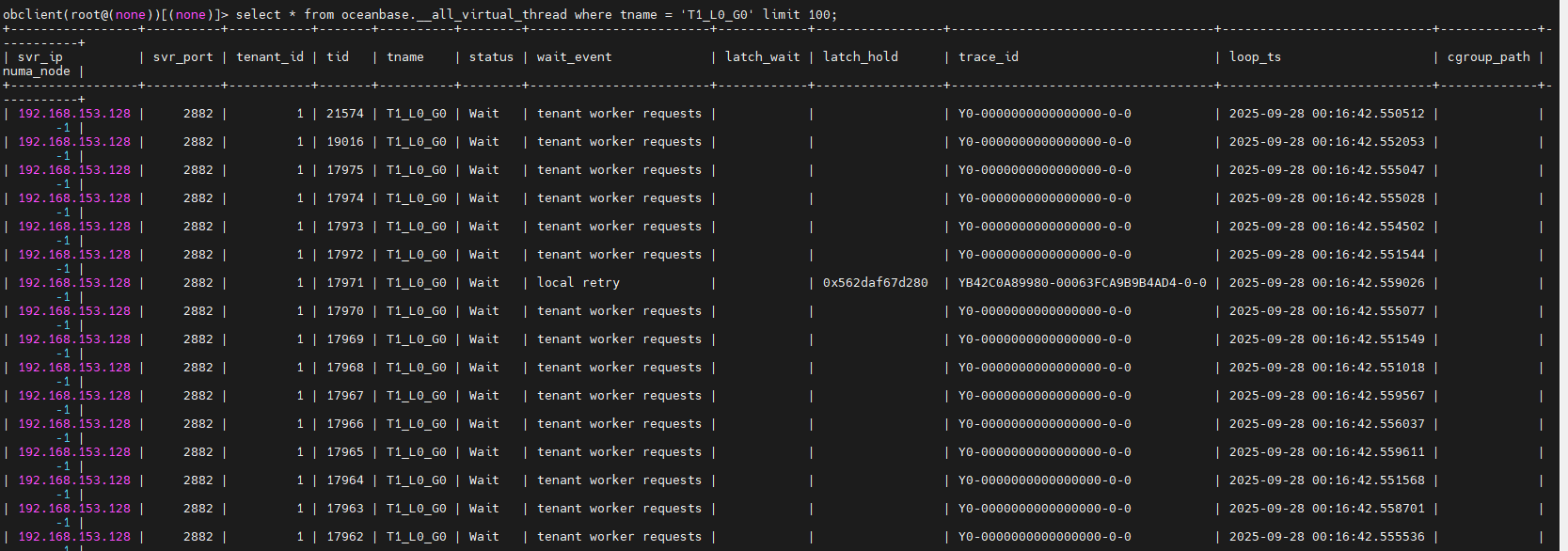

T1_L0_G0 线程状态:
obclient(root@(none))[test]> select count(*) from oceanbase.__all_virtual_thread where tname = 'T1_L0_G0' limit 100;
| count(*) |
|       82 |
1 row in set (0.003 sec)
T1_L0_G0大部分处于Wait状态,只有一个处于local retry ,然后trace_id 为:YB42C0A89980-00063FCA9B9B4AD4-0-0。

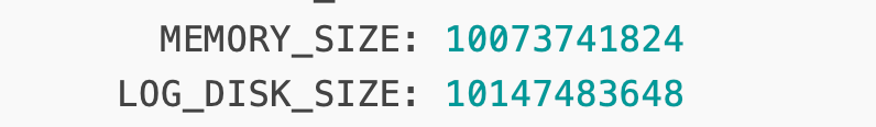

使用的是sys租户,租户的unit为:
obclient(root@(none))[(none)]> SELECT * FROM oceanbase.DBA_OB_UNIT_CONFIGS WHERE UNIT_CONFIG_ID='1' \G
      UNIT_CONFIG_ID: 1
         CREATE_TIME: 2025-09-14 21:47:07.638365
         MODIFY_TIME: 2025-09-27 17:58:27.760171
             MAX_CPU: 8
             MIN_CPU: 8
         MEMORY_SIZE: 10073741824
       LOG_DISK_SIZE: 10147483648
      DATA_DISK_SIZE: NULL
            MAX_IOPS: 9223372036854775807
            MIN_IOPS: 9223372036854775807
         IOPS_WEIGHT: 3
   MAX_NET_BANDWIDTH: 9223372036854775807
NET_BANDWIDTH_WEIGHT: 3
1 row in set (0.002 sec)

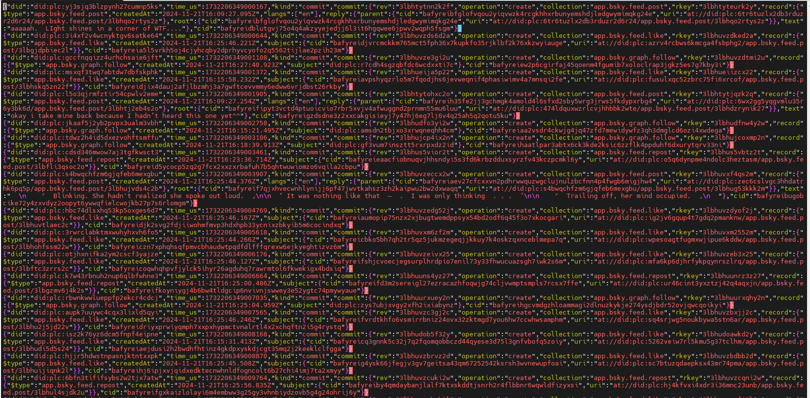

导入的json数据为:
见上

还有一个queue_size,但不确定是不是与这个错误有关:
看报错是租户队列满,队列满 一般是通过重启observer解决,然后再扩容资源,你这里load data是向sys租户导入数据吗?
另外这个log_disk_size配置不合理,log_disk_size一般要配置为memory_size的3~4倍
