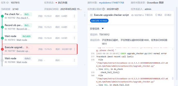

使用ocp升级ob集群4.3.5.1至4.3.5.3卡住
【 使用环境 】POC环境
【 OB or 其他组件 】OB &OCP

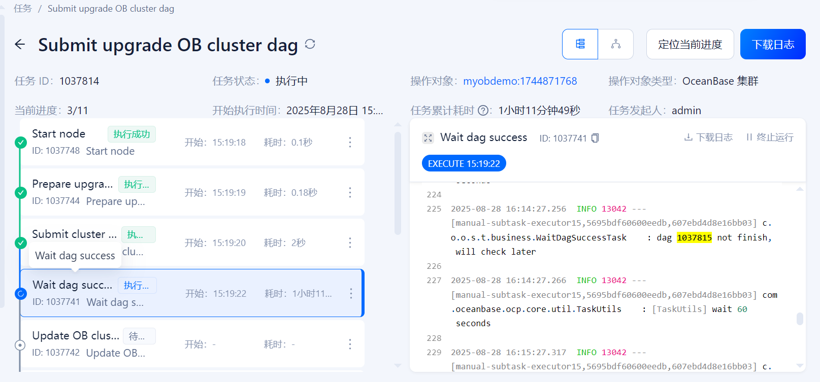

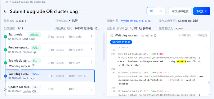

1.使用ocp升级ob集群 4.3.5.1至4.3.5.3 卡住如下图:
  1. 卡在dag 1037815 not finish will check later 如下日志
2025-08-28 16:25:27.933 INFO 13042 — [manual-subtask-executor15,5695bdf60600eedb,607ebd4d8e16bb03] c.o.o.s.t.business.WaitDagSuccessTask : dag 1037815 not finish, will check later
2025-08-28 16:25:27.947 INFO 13042 — [manual-subtask-executor15,5695bdf60600eedb,607ebd4d8e16bb03] com.oceanbase.ocp.core.util.TaskUtils : [TaskUtils] wait 60 seconds
2025-08-28 16:26:27.985 INFO 13042 — [manual-subtask-executor15,5695bdf60600eedb,607ebd4d8e16bb03] c.o.o.s.t.business.WaitDagSuccessTask : dag 1037815 not finish, will check later
2025-08-28 16:26:27.999 INFO 13042 — [manual-subtask-executor15,5695bdf60600eedb,607ebd4d8e16bb03] com.oceanbase.ocp.core.util.TaskUtils : [TaskUtils] wait 60 seconds
2025-08-28 16:27:28.047 INFO 13042 — [manual-subtask-executor15,5695bdf60600eedb,607ebd4d8e16bb03] c.o.o.s.t.business.WaitDagSuccessTask : dag 1037815 not finish, will check later
2025-08-28 16:27:28.060 INFO 13042 — [manual-subtask-executor15,5695bdf60600eedb,607ebd4d8e16bb03] com.oceanbase.ocp.core.util.TaskUtils : [TaskUtils] wait 60 seconds
2025-08-28 16:28:28.116 INFO 13042 — [manual-subtask-executor15,5695bdf60600eedb,607ebd4d8e16bb03] c.o.o.s.t.business.WaitDagSuccessTask : dag 1037815 not finish, will check later
2025-08-28 16:28:28.127 INFO 13042 — [manual-subtask-executor15,5695bdf60600eedb,607ebd4d8e16bb03] com.oceanbase.ocp.core.util.TaskUtils : [TaskUtils] wait 60 seconds
2025-08-28 16:29:28.177 INFO 13042 — [manual-subtask-executor15,5695bdf60600eedb,607ebd4d8e16bb03] c.o.o.s.t.business.WaitDagSuccessTask : dag 1037815 not finish, will check later
2025-08-28 16:29:28.193 INFO 13042 — [manual-subtask-executor15,5695bdf60600eedb,607ebd4d8e16bb03] com.oceanbase.ocp.core.util.TaskUtils : [TaskUtils] wait 60 seconds

subtask_1037787.log (91.3 KB)

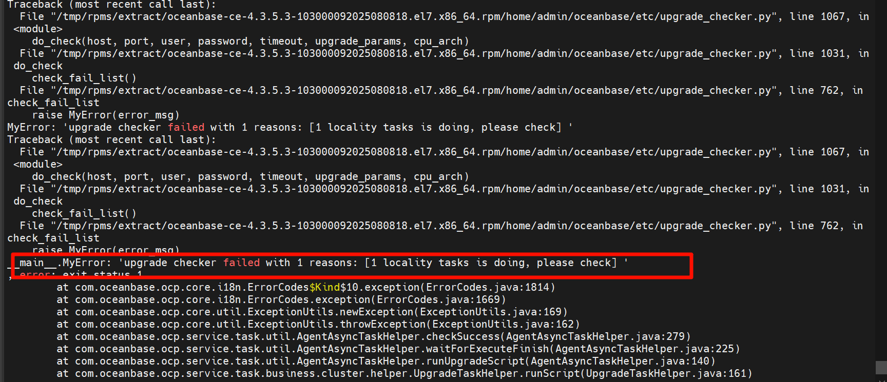

有如下的报错提示:但是我没有执行中的任务如何查看确定?
MyError: 'upgrade checker failed with 1 reasons: [1 locality tasks is doing, please check] ’
obclient(root@(none))[oceanbase]> SELECT * FROM oceanbase.DBA_OB_TENANT_JOBS WHERE JOB_STATUS<>‘SUCCESS’\G
JOB_ID: 56
JOB_TYPE: ALTER_TENANT_PRIMARY_ZONE
JOB_STATUS: INPROGRESS
RESULT_CODE: NULL
PROGRESS: 0
START_TIME: 2025-08-20 15:44:43.051974
MODIFY_TIME: 2025-08-20 15:44:43.051974
TENANT_ID: 1006
SQL_TEXT: ALTER TENANT bk_test PRIMARY_ZONE = ‘zone1,zone2,zone3,zone4,zone5’
EXTRA_INFO: FROM: ‘zone2;zone1;zone3;zone4;zone5’, TO: ‘zone1,zone2,zone3,zone4,zone5’
RS_SVR_IP: 10.16.xx.x
RS_SVR_PORT: 2882
1 row in set (0.010 sec)

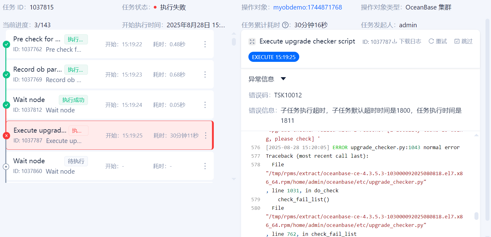

二.MyError: 'upgrade checker failed with 1 reasons: [1 locality tasks is doing, please check] ’(该问题已经解决)
我在ocp界面修改了 PRIMARY_ZONE为以下这个错不在报了。

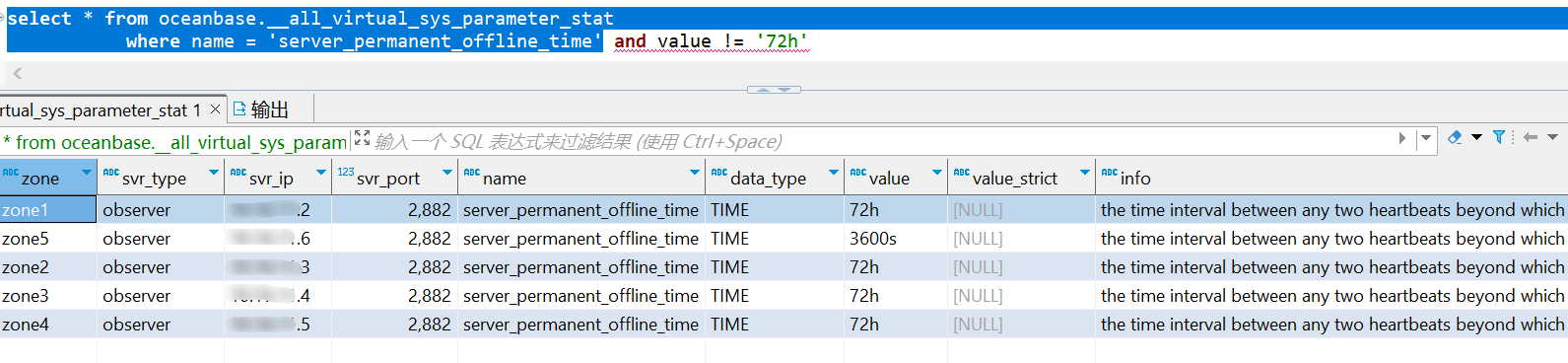

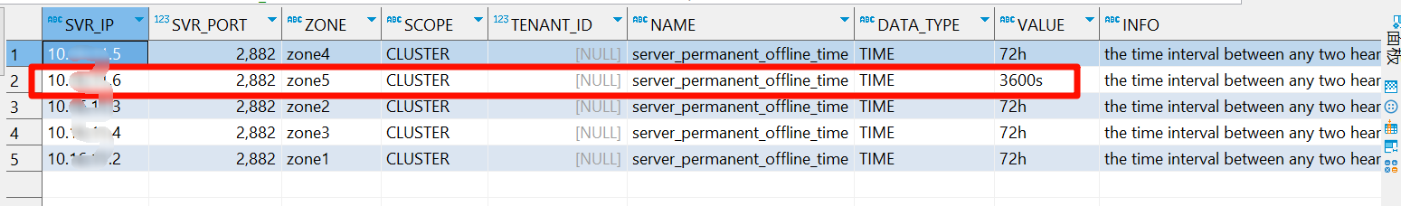

三。新问题。是在升级界面发现如下错误:
File “/tmp/rpms/extract/oceanbase-ce-4.3.5.3-103000092025080818.el7.x86_64.rpm/home/admin/oceanbase/etc/upgrade_checker.py”, line 531, in modify_server_permanent_offline_time
** set_parameter(cur, ‘server_permanent_offline_time’, ‘72h’)**
** File "/tmp/rpms/extract/oceanbase-ce-4.3.5.3-**

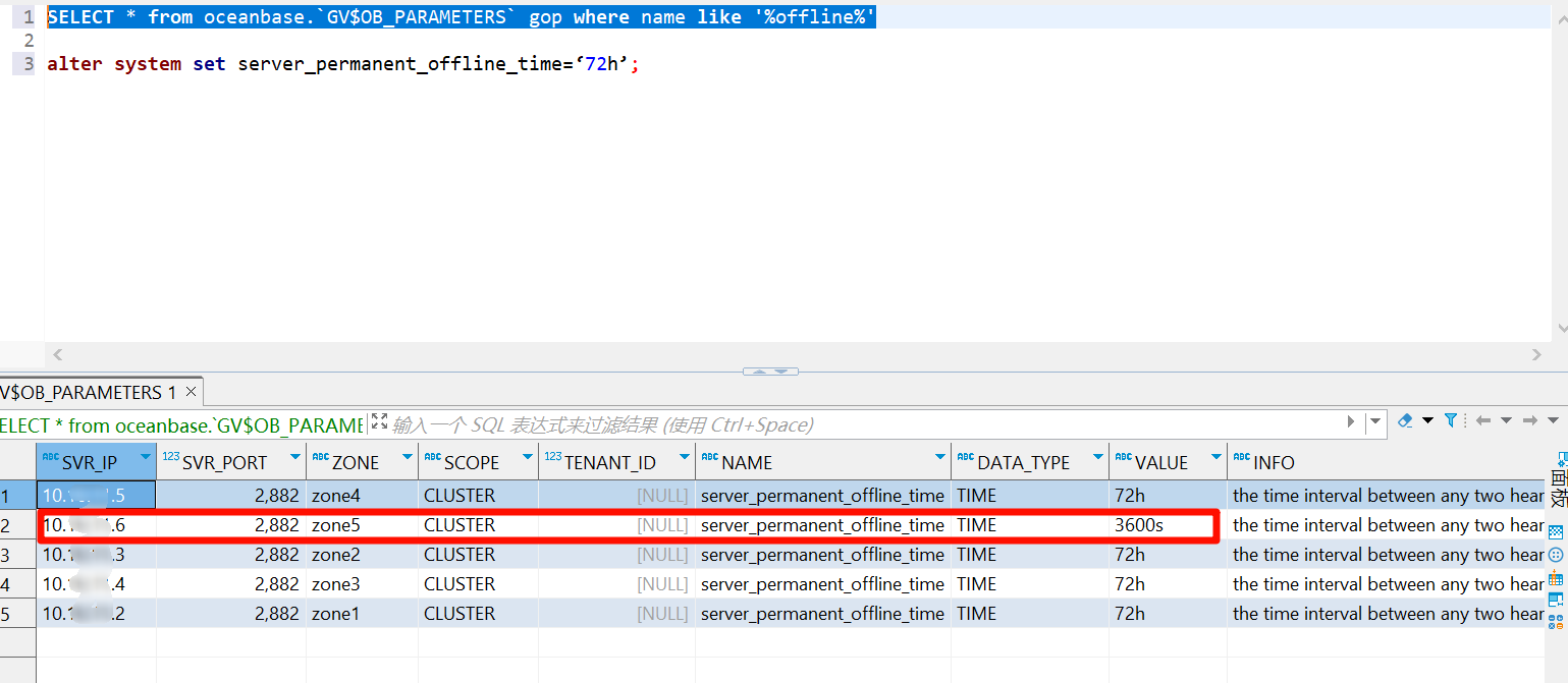

*.6服务器 无论如何修改都是3600s 修改不过来,统一修改成3600s 还是变成如上图效果,很奇怪。
obclient(root@(none))[oceanbase]> alter system set server_permanent_offline_time=‘72h’;
Query OK, 0 rows affected (0.029 sec)
obclient(root@(none))[oceanbase]> alter system set server_permanent_offline_time=‘3600s’;
Query OK, 0 rows affected (0.026 sec)

obclient(root@(none))[oceanbase]> SET ob_enable_show_trace=on;
Query OK, 0 rows affected (0.001 sec)
Query OK, 0 rows affected (0.028 sec)
obclient(root@(none))[oceanbase]> select last_trace_id();
| last_trace_id() |
| YB420A100B06-00063A16B3D82B7C-0-0 |
1 row in set (0.037 sec)
obclient(root@(none))[oceanbase]> select query_sql,svr_ip from gv$ob_sql_audit where trace_id=‘YB420A100B06-00063A16B3D82B7C-0-0’;
| query_sql | svr_ip |
| INSERT INTO __all_sys_parameter (zone, svr_type, svr_ip, svr_port, name, value, info, config_version, gmt_modified, section, scope, sou rce, edit_level, data_type) VALUES (’’, ‘observer’, ‘ANY’, 0, ‘server_permanent_offline_time’, ‘72h’, ‘’, 1756432800565909, usec_to_time( 1756432800565909), ‘ROOT_SERVICE’, ‘CLUSTER’, ‘DEFAULT’, ‘DYNAMIC_EFFECTIVE’, ‘TIME’) ON DUPLICATE KEY UPDATE value = ‘72h’, info = ‘’, c onfig_version = 1756432800565909, gmt_modified = usec_to_time(1756432800565909), section = ‘ROOT_SERVICE’, scope = ‘CLUSTER’, source = ‘D EFAULT’, edit_level = ‘DYNAMIC_EFFECTIVE’, data_type = ‘TIME’ | 10.xx.xx.2 |
| START TRANSACTION | 10.xx.xx.2 |
| UPDATE __all_zone SET value = 1756432800565909, info = ‘’, gmt_modified = now(6) WHERE zone = ‘’ AND name = ‘config_version’ | 10.xx.xx.2 |
| UPDATE __all_zone SET value = 1756432800571954, info = ‘’, gmt_modified = now(6) WHERE zone = ‘’ AND name = ‘lease_info_version’ | 10.xx.xx.2 |
| COMMIT | 10.xx.xx.2 |
5 rows in set (2.387 sec)
3.修改结果
observer日志肯定会记录到的,你换个节点找下10.xx.xx.2
老师,10.xx.xx.2 上没有,10.xx.xx.6 上有一点日志,我登陆的是 10.xx.xx.6 执行的命令,日志如下:
[admin@localhost log]$ grep -i “YB420A100B06-00063A16B3D82B7C-0-0” observer.log*
observer.log.20250829100629692:[2025-08-29 10:00:45.783845] INFO [SHARE] add_event (ob_event_history_table_operator.h:266) [9710][T1_L0_G0][T1][YB420A100B06-00063A16B3D82B7C-0-0] [lt=71] event table add task(ret=0, event_table_name="__all_server_event_history", sql=INSERT INTO __all_server_event_history (gmt_create, module, event, name1, value1, name2, value2, name3, value3, name4, value4, value5, value6, svr_ip, svr_port) VALUES (usec_to_time(1756432845783771), ‘sql’, ‘execute_cmd’, ‘cmd_type’, 177, ‘sql_text’, X’2A2A2A’, ‘return_code’, 0, ‘tenant_id’, 1, ‘’, ‘’, ‘10.xx.xx.6’, 2882))
老师在10.xx.xx.2 节点又重新操作了一次 结果还是没改过来如下图:
详细操作如下:日志见附件
20250829-2-observer.log (896 字节)
20250829-2-rootservice.log (4.0 KB)
obclient(root@(none))[oceanbase]> SET ob_enable_show_trace=‘on’;
Query OK, 0 rows affected (0.040 sec)
| last_trace_id() |
| YB420A100B02-000633866FCFC7DE-0-0 |
1 row in set (0.016 sec)
obclient(root@(none))[oceanbase]> select query_sql,svr_ip from gv$ob_sql_audit where trace_id=‘YB420A100B02-000633866FCFC7D0-0’;
| query_sql | svr_ip
| INSERT INTO __all_sys_parameter (zone, svr_type, svr_ip, svr_port, name, value, info, config_version, gmt_modified, secti, scope, source, edit_level, data_type) VALUES (’’, ‘observer’, ‘ANY’, 0, ‘server_permanent_offline_time’, ‘72h’, ‘’, 17564114254569, usec_to_time(1756455114254569), ‘ROOT_SERVICE’, ‘CLUSTER’, ‘DEFAULT’, ‘DYNAMIC_EFFECTIVE’, ‘TIME’) ON DUPLICATE Y UPDATE value = ‘72h’, info = ‘’, config_version = 1756455114254569, gmt_modified = usec_to_time(1756455114254569), sectio= ‘ROOT_SERVICE’, scope = ‘CLUSTER’, source = ‘DEFAULT’, edit_level = ‘DYNAMIC_EFFECTIVE’, data_type = ‘TIME’ | 10.xx.xx.2
| UPDATE __all_zone SET value = 1756455114254569, info = ‘’, gmt_modified = now(6) WHERE zone = ‘’ AND name = ‘config_versi’ | 10.xx.xx.2
| UPDATE __all_zone SET value = 1756455114268693, info = ‘’, gmt_modified = now(6) WHERE zone = ‘’ AND name = ‘lease_info_vsion’ | 10.xx.xx.2
| COMMIT | 10.xx.xx.2
5 rows in set (2.605 sec)

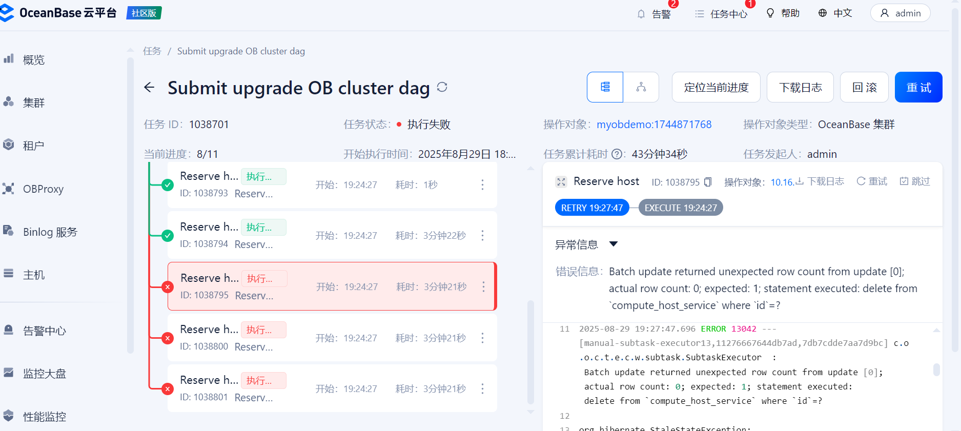

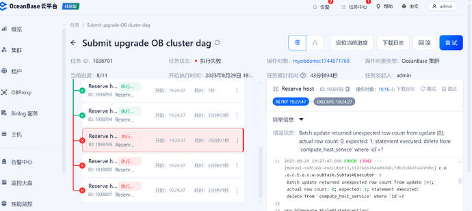

老师,我使用ocp 重启10.xx.xx.6 这个server 没起来,帮忙看看什么原因,日志如下:
1.重启失败
[admin@localhost log]$ more observer.log.wf
[2025-08-29 16:46:49.163192] INFO New syslog file info: [address: “10.xx.xx.6:2882”, observer version: OceanBase_CE 4.3.5.1, revision: 10100004
2025031818-b6d5706eb3d2c5f501c7fa646ddbf32f3dc87069, sysname: Linux, os release: 3.10.0-1160.119.1.el7.x86_64, machine: x86_64, tz GMT offset: 0
8:00]
[2025-08-29 16:47:44.924744] ERROR [SERVER] start (ob_service.cpp:274) [15590][observer][T0][YB420A100B06-00063D7D134883DF-0-0] [lt=62][errcode=
-4395] observice start process has failure(msg=“observice start() has failure”, ret=-4000, ret=“OB_ERROR”)
[2025-08-29 16:47:44.924881] ERROR [SERVER] start (ob_server.cpp:1165) [15590][observer][T0][YB420A100B06-00063D7D134883DF-0-0] [lt=78][errcode=
-4000] [server_start 9/18] observer instance start fail. you may find solutions in previous error logs or seek help from official technicians.
[2025-08-29 16:47:44.958576] ERROR [SERVER] start (ob_server.cpp:1239) [15590][observer][T0][YB420A100B06-00063D7D134883DF-0-0] [lt=84][errcode=

看下这台机器和其它时间的时间差异多大
1.旭辉老师威武,确实 10.xx.xx.6 这台机器的ntp服务出了一些问题时间上比其它机器快了40多秒,时间修正好后,10.xx.xx.6 参数恢复正常,重启server正常启动,旭辉老师太牛了感谢感谢,
obclient(root@(none))[oceanbase]> show parameters like ‘%offline%’\G
zone: zone5
svr_type: observer
svr_ip: 10.xx.xx.6
svr_port: 2882
data_type: TIME
value: 72h
info: the time interval between any two heartbeats beyond which a server is considered to be ‘permanently’ offline. Range: [20s,+∞)
section: ROOT_SERVICE
scope: CLUSTER
source: DEFAULT
edit_level: DYNAMIC_EFFECTIVE
default_value: 3600s
isdefault: 0
2.后续正常升级从4.3.5.1 升级到 4.3.5.3出现了点小问题如下图
不过集群版本到是升上来了如下图:
→ select @@version;
| @@version |
| 5.7.25-OceanBase_CE-v4.3.5.3 |
1 row in set (0.001 sec)
错误信息如下:
log_task_1038701.zip (21.2 KB)
Batch update returned unexpected row count from update [0]; actual row count: 0; expected: 1; statement executed: delete from compute_host_service where id=?
2025-08-29 19:27:47.696 ERROR 13042 — [manual-subtask-executor13,11276667644db7ad,7db7cdde7aa7d9bc] c.o.o.c.t.e.c.w.subtask.SubtaskExecutor : Batch update returned unexpected row count from update [0]; actual row count: 0; expected: 1; statement executed: delete from compute_host_service where id=?
org.hibernate.StaleStateException: Batch update returned unexpected row count from update [0]; actual row count: 0; expected: 1; statement executed: delete from compute_host_service where id=?
at org.hibernate.jdbc.Expectations$BasicExpectation.checkBatched(Expectations.java:67)
at org.hibernate.jdbc.Expectations$BasicExpectation.verifyOutcome(Expectations.java:54)
at org.hibernate.engine.jdbc.batch.internal.NonBatchingBatch.addToBatch(NonBatchingBatch.java:47)

Set state for subtask: 1038795, operation:RETRY, state: FAILED
没遇到过这种报错
NTP相差40s 参数修改节点异常问题应该就是这个导致的。现在升级成功了么
辞霜老师又遇到了点问题升级最后阶段如下图,感谢感谢
麻烦在OCP meta租户下meta_database库查下,另外看下 任务 “Upgrade OB cluster” 中有没有失败的子任务?
select * from compute_host_service;
