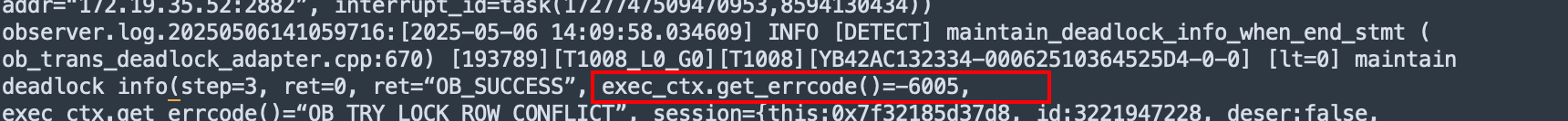

observer.log.20250506141059716:[2025-05-06 14:09:58.034609] INFO [DETECT] maintain_deadlock_info_when_end_stmt (ob_trans_deadlock_adapter.cpp:670) [193789][T1008_L0_G0][T1008][YB42AC132334-00062510364525D4-0-0] [lt=0] maintain deadlock info(step=3, ret=0, ret=“OB_SUCCESS”, exec_ctx.get_errcode()=-6005, exec_ctx.get_errcode()=“OB_TRY_LOCK_ROW_CONFLICT”, session={this:0x7f32185d37d8, id:3221947228, deser:false, tenant:“ZABBIX”, tenant_id:1008, effective_tenant:“ZABBIX”, effective_tenant_id:1008, database:“nd_zabbix”, user:“a_zabbix@%”, consistency_level:3, session_state:2, autocommit:true, tx:0x7f3719bde8e0}, desc=NULL, is_rollback=true, conflict_txs=[])

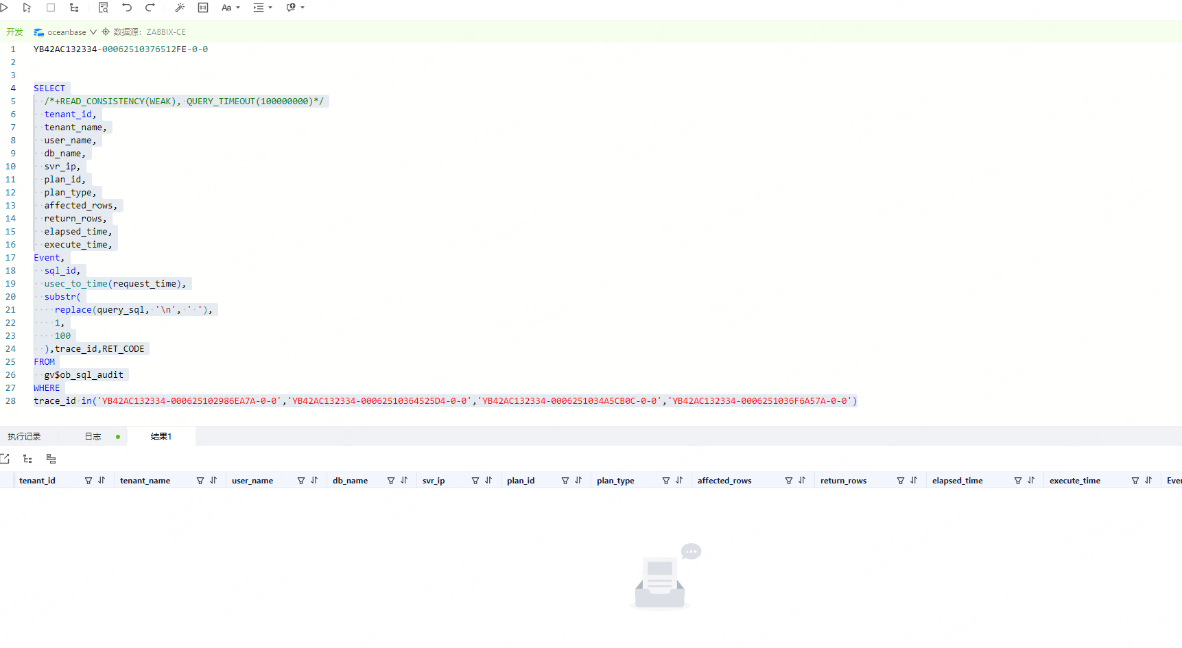

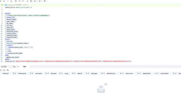

–根据时间和执行语句查询trace_id
select query_sql,svr_ip,TRACE_ID,client_ip,TENANT_NAME,user_name,DB_NAME,ELAPSED_TIME,RET_CODE,FROM_UNIXTIME(ROUND(REQUEST_TIME/1000/1000),’%Y-%m-%d %H:%i:%S’) from GV$OB_SQL_AUDIT
WHERE REQUEST_TIME>=‘2024-04-05 14:34:00’ and lower(query_sql) like ‘%select%’;

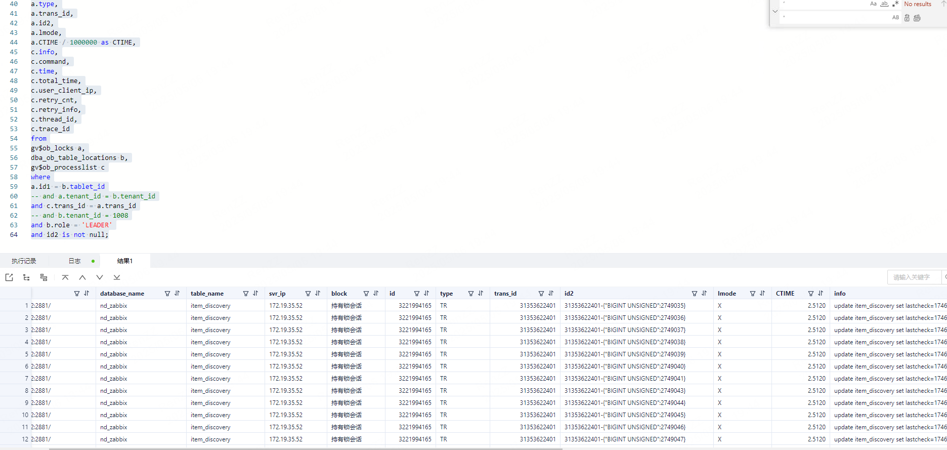

可以通过下面的语句查一下 试试
select
/+DYNAMIC_SAMPLING(1)/
concat(‘kill ‘,c.svr_ip,’ /’,c.svr_ip,’:2881/’) as kill_sid,
b.database_name,
b.table_name,
a.svr_ip,
case when block = 0 then ‘持有锁会话’ ELSE ‘等待锁会话’ END AS block,
c.id,
a.type,
a.trans_id,
a.id2,
a.lmode,
a.CTIME / 1000000 as CTIME,
c.info,
c.command,
c.time,
c.total_time,
c.user_client_ip,
c.retry_cnt,
c.retry_info,
c.thread_id,
c.trace_id
from
gv$ob_locks a,
oceanbase.cdb_ob_table_locations b,
gv$ob_processlist c
where
a.id1 = b.tablet_id
and a.tenant_id = b.tenant_id
and c.trans_id = a.trans_id
and b.tenant_id = 租户id
and b.role = ‘LEADER’
and id2 is not null;

你可以查询一下这个信息 看看有没有 一般情况下 有死锁会有6005的错误
select * from __all_virtual_processlist where retry_info like ‘%-6005%’ and total_time > 100 order by total_time limit 10\G
单从我的后台日志看有6005的报错,确实是有死锁的信息是吧, 但是根据gv$ob_sql_audit查不到具体的sql 这个是为什么? __all_virtual_processlist 只能实时看

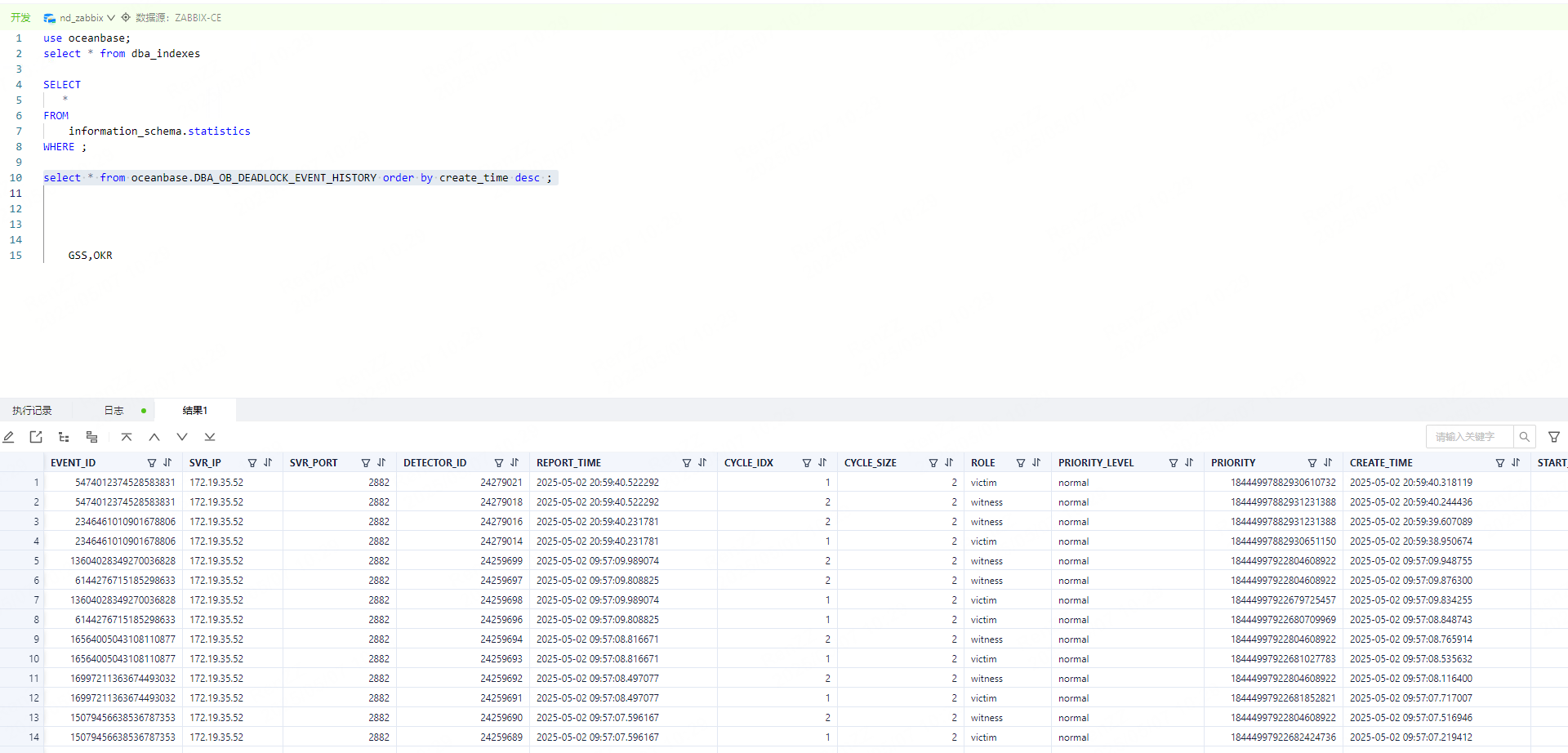

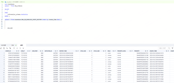

应该是有死锁 如果是历史的 你可以通过下面的信息 查看一下 一个是当前的业务租户 一个是sys租户下
select * from oceanbase.DBA_OB_DEADLOCK_EVENT_HISTORY;
select * from oceanbase.CDB_OB_DEADLOCK_EVENT_HISTORY;
这个只有0502日的,没有昨天的,昨天下午14点多后台有不少6005的信息
