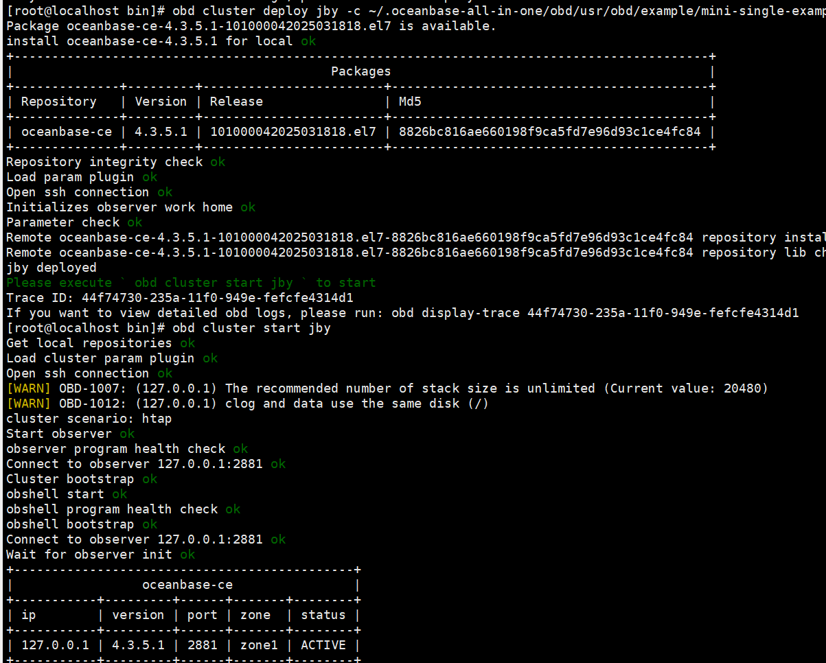

部署obd工具
tar -zxvf oceanbase-all-in-one-*.tar.gz
cd oceanbase-all-in-one/bin/
./install.sh
source ~/.oceanbase-all-in-one/bin/env.sh
修改初始化配置文件
vi ~/.oceanbase-all-in-one/obd/usr/obd/example/mini-single-example.yaml
部署OceanBase数据库
obd cluster deploy jby -c ~/.oceanbase-all-in-one/obd/usr/obd/example/mini-single-example.yaml
启动 OceanBase 数据库
obd cluster start jby

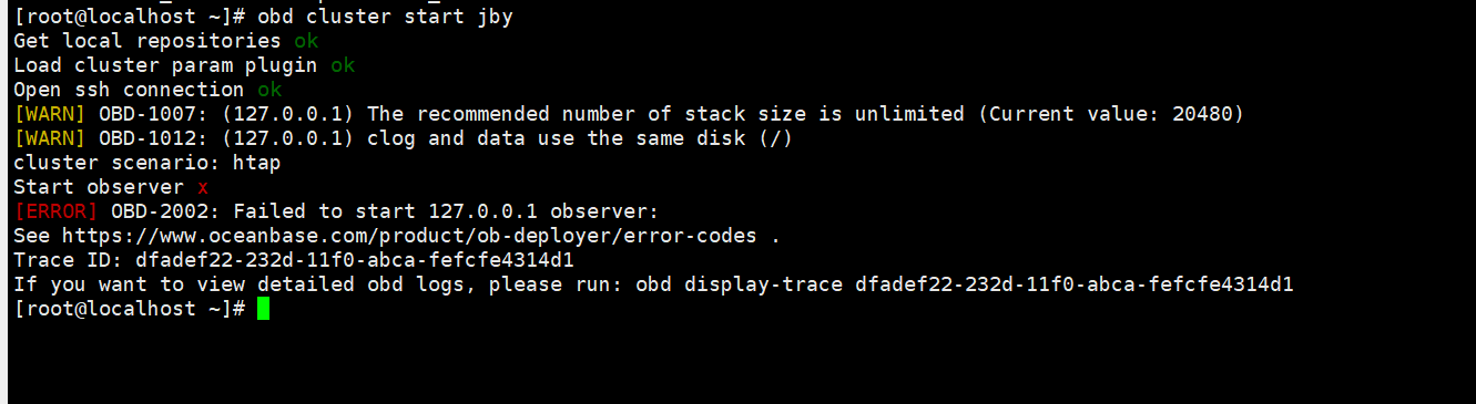

[root@localhost ~]# obd cluster start jby
Get local repositories ok
Load cluster param plugin ok
Open ssh connection ok
[WARN] OBD-1007: (127.0.0.1) The recommended number of stack size is unlimited (Current value: 20480)
[WARN] OBD-1012: (127.0.0.1) clog and data use the same disk (/)
cluster scenario: htap
Start observer x
[ERROR] OBD-2002: Failed to start 127.0.0.1 observer:
Trace ID: dfadef22-232d-11f0-abca-fefcfe4314d1
If you want to view detailed obd logs, please run: obd display-trace dfadef22-232d-11f0-abca-fefcfe4314d1
[root@localhost ~]# obd display-trace dfadef22-232d-11f0-abca-fefcfe4314d1

[2025-04-27 14:07:19.590] [INFO] Start observer
[2025-04-27 14:07:19.591] [DEBUG] – starting 127.0.0.1 observer
[2025-04-27 14:07:19.592] [DEBUG] – root@127.0.0.1 export LD_LIBRARY_PATH=’/usr/local/observer/lib:’
[2025-04-27 14:07:19.593] [DEBUG] – local execute: cd /usr/local/observer; /usr/local/observer/bin/observer -r ‘127.0.0.1:2882:2881’ -p 2881 -P 2882 -z ‘zone1’ -n ‘jby’ -c 1 -d ‘/usr/local/observer/store’ -I ‘127.0.0.1’ -o __min_full_resource_pool_memory=2147483648,memory_limit=‘32G’,datafile_size=‘2G’,datafile_next=‘2G’,datafile_maxsize=‘20G’,log_disk_size=‘14G’,cpu_count=16,enable_syslog_wf=False,max_syslog_file_count=4,large_query_threshold=‘600s’,enable_record_trace_log=False,enable_syslog_recycle=1
[2025-04-27 14:07:20.159] [DEBUG] – exited code -4, error output:
[2025-04-27 14:07:20.160] [DEBUG] – root@127.0.0.1 delete env LD_LIBRARY_PATH
[2025-04-27 14:07:20.245] [ERROR] OBD-2002: Failed to start 127.0.0.1 observer:
[2025-04-27 14:07:20.246] [DEBUG] - sub start ref count to 0
[2025-04-27 14:07:20.246] [DEBUG] - export start
[2025-04-27 14:07:20.246] [DEBUG] - plugin oceanbase-ce-py_script_start-3.1.0 result: None
[2025-04-27 14:07:20.251] [DEBUG] - share lock /root/.obd/lock/mirror_and_repo release, count 1
[2025-04-27 14:07:20.251] [DEBUG] - share lock /root/.obd/lock/mirror_and_repo release, count 0
[2025-04-27 14:07:20.251] [DEBUG] - unlock /root/.obd/lock/mirror_and_repo
[2025-04-27 14:07:20.251] [DEBUG] - exclusive lock /root/.obd/lock/deploy_jby release, count 0
[2025-04-27 14:07:20.252] [DEBUG] - unlock /root/.obd/lock/deploy_jby
[2025-04-27 14:07:20.252] [DEBUG] - share lock /root/.obd/lock/global release, count 0
[2025-04-27 14:07:20.252] [DEBUG] - unlock /root/.obd/lock/global
[2025-04-27 14:07:20.252] [INFO] See https://www.oceanbase.com/product/ob-deployer/error-codes .
[2025-04-27 14:07:20.252] [INFO] Trace ID: dfadef22-232d-11f0-abca-fefcfe4314d1
[2025-04-27 14:07:20.252] [INFO] If you want to view detailed obd logs, please run: obd display-trace dfadef22-232d-11f0-abca-fefcfe4314d1

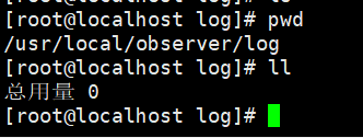

    • 检查日志文件 /usr/local/observer/log/observer.log 以获取更多详细信息。

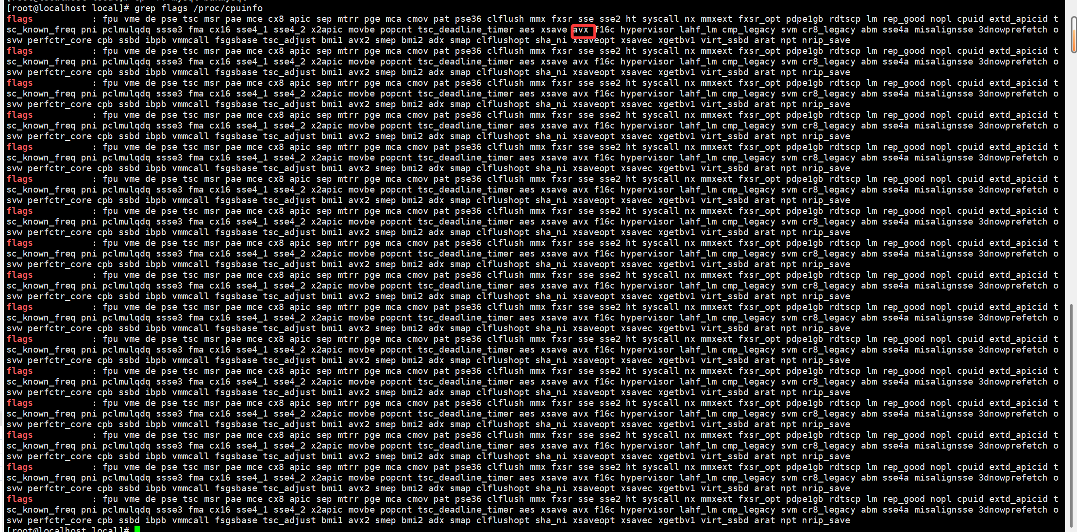

麻烦提供一份yaml文件,和observer日志~/xxx/oceanbase/log

log是空的
obd cluster list看一下集群状态
确认下你的主机有120G内存么memory_limit是内存参数。
我改成32G也不行

我之前部署过其他的,都没问题,就这次有问题了

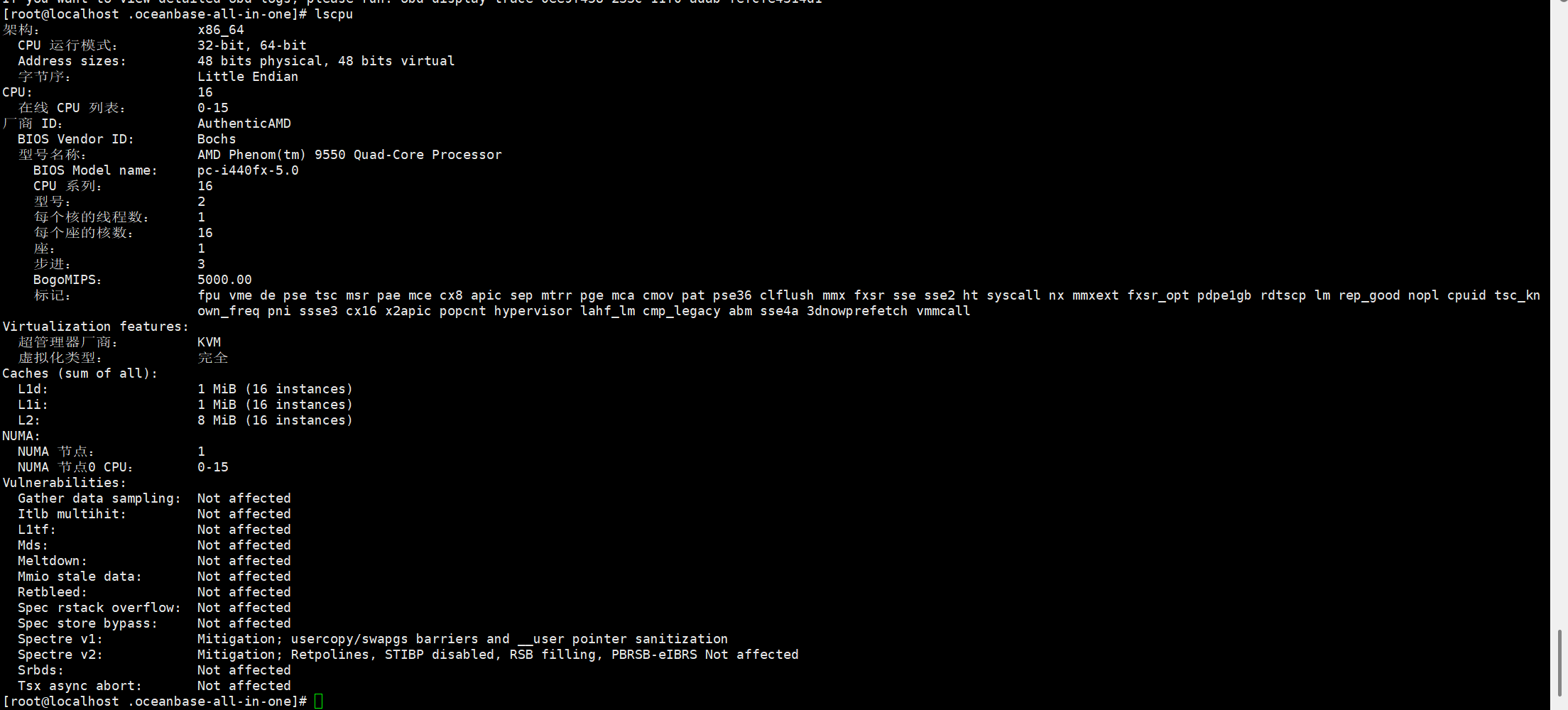

有生成observer日志么,lscpu看一下是否有avx指令集
lscpu
没有生成observer日志,只有obd display-trace 9ba3320e-233e-11f0-837a-fefcfe4314d1这种

没有avx指令集,是无法安装运行ob的。建议更换cpu。或者你尝试安装老版本 421.0试试
:+1: :+1: :+1:牛逼(破音)!确实是这个问题,已解决。非常感谢!
