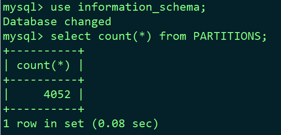

测试,用这个建表语句,建几百张表后,再建新表就会出现ERROR 1499 (HY000): Too many partitions (including subpartitions) were defined 这个报错ERROR 1499 (HY000): Too many partitions (including subpartitions) were defined

SHOW PARTITIONS,在数据库中没有对应项,数据库版本是OceanBase_CE 4.2.1.3版本 for mysql
@社区小助手
单表分区数量受max_partition_num限制,MySQL模式默认是8192,从你前面的查询结果看设置的是65535,
另外每个 OBServer 节点的分区副本数可根据租户内存大小来预估,1G 内存约支持约 2 万 tablet(内存的计算需要扣除meta租户,2万tablet 受变量 _max_tablet_cnt_per_gb 控制)
–查看下租户资源配置
SELECT c.TENANT_ID, e.TENANT_NAME, concat(c.NAME, ': ', d.NAME)`pool:conf`,concat(c.UNIT_COUNT, ' unit: ', d.min_cpu, 'C/', ROUND(d.MEMORY_SIZE/1024/1024/1024,0), "G") unit_info FROM DBA_OB_RESOURCE_POOLS c, DBA_OB_UNIT_CONFIGS d, DBA_OB_TENANTS e WHERE c.UNIT_CONFIG_ID=d.UNIT_CONFIG_ID AND c.TENANT_ID=e.TENANT_ID AND c.TENANT_ID>1000 ORDER BY c.TENANT_ID;
查看指定表是否为分区表
select DATABASE_NAME,TABLE_NAME,PARTITION_NAME,SUBPARTITION_NAME from cdb_ob_table_locations where TABLE_NAME='abc' and TENANT_ID=xxx;
查看指定租户当前的分区表详情
select DATABASE_NAME,TABLE_NAME,PARTITION_NAME,SUBPARTITION_NAME from cdb_ob_table_locations where TENANT_ID=xxx and PARTITION_NAME <>'NULL';
