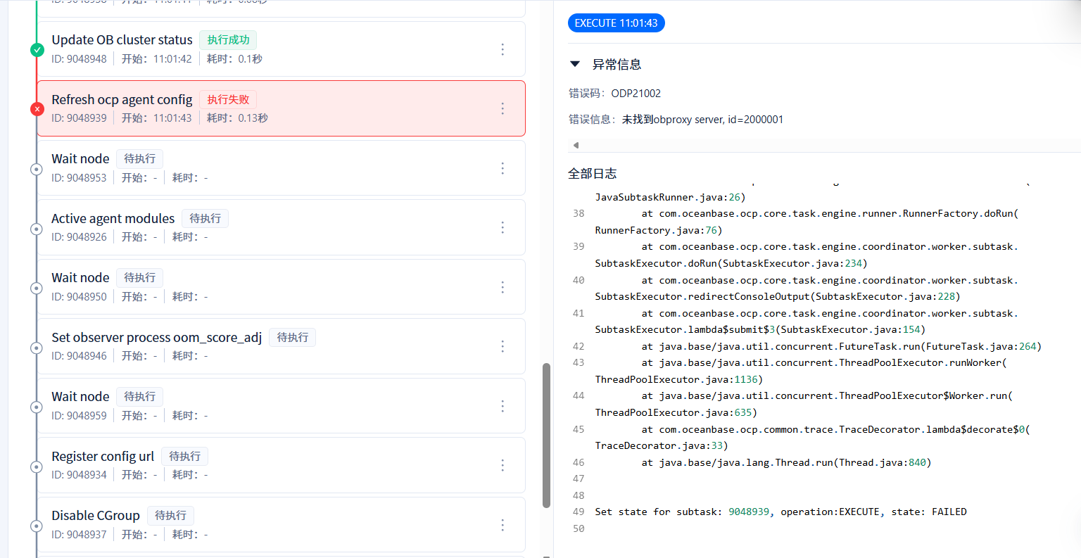

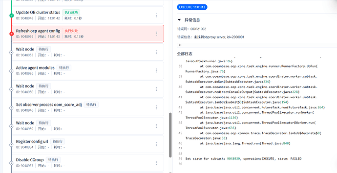

创建 oceanbase 442 集群报错
2026-09-10 11:01:43.853 ERROR 11 — [manual-subtask-executor14,e13843f6930a478e,87df2f940a335f78] c.o.ocp.core.util.ExceptionUtils : Checked Exception: com.oceanbase.ocp.core.exception.UnexpectedException occurred with code error.obproxy.server.not.found, and args [2000001]
2026-09-10 11:01:43.862 ERROR 11 — [manual-subtask-executor14,e13843f6930a478e,87df2f940a335f78] c.o.o.c.t.e.c.w.subtask.SubtaskExecutor : The OBProxy server with the ID of 2,000,001 is not found.
com.oceanbase.ocp.core.exception.UnexpectedException: [OCP UnexpectedException]: status=500 INTERNAL_SERVER_ERROR, errorCode=OBPROXY_SERVER_NOT_FOUND, args=2000001

Set state for subtask: 9048939, operation:EXECUTE, state: FAILED

看日志是刷新 Agent 配置时,这台主机上挂了 OB_PROXY 服务,OCP 按 hostId 去查 obproxy_server,记录不存在,任务失败。
常见原因:该主机以前装过 / 登记过 OBProxy,卸载不干净;或 host_service 脏数据。

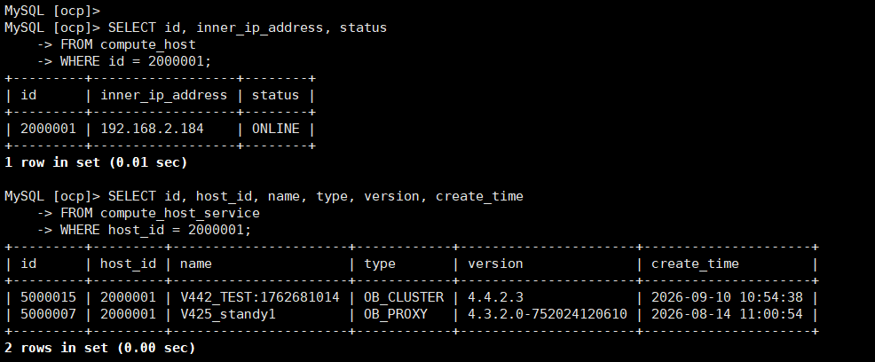

登录 OCP 元数据库(一般是 ocp_meta),执行:
– 主机
SELECT id, inner_ip_address, status
FROM compute_host
WHERE id = 2000001;
– 该主机上登记的服务(重点看有没有 OB_PROXY)
SELECT id, host_id, name, type, version, create_time
FROM compute_host_service
WHERE host_id = 2000001;

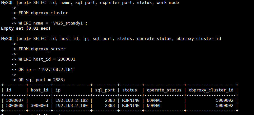

– OBProxy 实例(失败就是这里查不到)
SELECT id, host_id, ip, sql_port, status, operate_status, obproxy_cluster_id
FROM obproxy_server
OR ip = ‘192.168.2.184’;

在查一下
SELECT id, name, sql_port, exporter_port, status, work_mode
FROM obproxy_cluster
WHERE name = ‘V425_standy1’;
FROM obproxy_server
OR sql_port = 2883;
425 是之前安装的,后面又删掉了,可能是没有删除干净。
要删除 5000007 | 2000001 这条记录吗

进程没了再改元数据(只删 OB_PROXY,保留 OB_CLUSTER):
SELECT id, name, type FROM compute_host_service
DELETE FROM compute_host_service
WHERE host_id = 2000001 AND type = ‘OB_PROXY’ AND name = ‘V425_standy1’;
然后重试子任务 Refresh ocp agent config。
