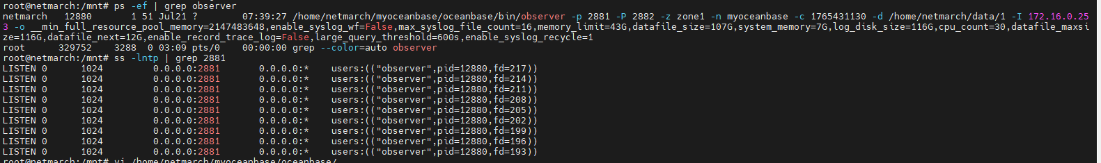

现象:

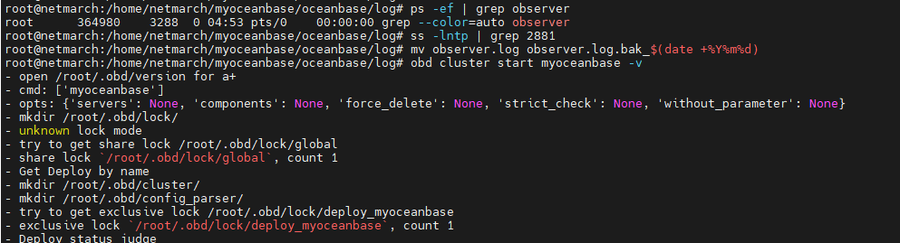

  • 执行 obd cluster start myoceanbase 后,observer 进程能拉起,但 OBD 持续连接 :2881 失败,最终报:
    OBD-1006: Failed to connect to oceanbase-ce
  • observer 日志中关键报错:

  • 根因看起来不是端口、密码或磁盘空间问题,而是启动恢复阶段回放 tenant_1002 的存储元数据/日志失败

  1. obd 启动失败主报错
[ERROR] OBD-1006: Failed to connect to oceanbase-ce
pymysql.err.OperationalError: (2003, “Can’t connect to MySQL server on ‘xxx.xxx.xxx.xxx’ ([Errno 111] Connection refused)”)

[2026-07-21 08:53:42.163] [aa17ad6e-84e1-11f1-87ca-000c2988f524] [DEBUG] - Found for oceanbase-ce-py_script_workflow_start-4.2.5.0 for oceanbase-ce-4.2.5.0
[2026-07-21 08:53:42.163] [aa17ad6e-84e1-11f1-87ca-000c2988f524] [DEBUG] - Searching start template for components …
[2026-07-21 08:53:42.163] [aa17ad6e-84e1-11f1-87ca-000c2988f524] [DEBUG] - Call workflow obproxy-ce-py_script_workflow_start-3.2.1 for obproxy-ce-4.3.5.0-3.el7-f17b277b681adb1c86bfc3cfda369ad88896da9d
[2026-07-21 08:53:42.164] [aa17ad6e-84e1-11f1-87ca-000c2988f524] [DEBUG] - import start
[2026-07-21 08:53:42.164] [aa17ad6e-84e1-11f1-87ca-000c2988f524] [DEBUG] - add start ref count to 1
[2026-07-21 08:53:42.164] [aa17ad6e-84e1-11f1-87ca-000c2988f524] [DEBUG] - sub start ref count to 0
[2026-07-21 08:53:42.164] [aa17ad6e-84e1-11f1-87ca-000c2988f524] [DEBUG] - export start
[2026-07-21 08:53:42.164] [aa17ad6e-84e1-11f1-87ca-000c2988f524] [DEBUG] - plugin obproxy-ce-py_script_workflow_start-3.2.1 result: True
[2026-07-21 08:53:42.164] [aa17ad6e-84e1-11f1-87ca-000c2988f524] [DEBUG] - Found for obproxy-ce-py_script_workflow_start-3.2.1 for obproxy-ce-3.2.1
[2026-07-21 08:53:42.165] [aa17ad6e-84e1-11f1-87ca-000c2988f524] [DEBUG] - Searching configserver_pre plugin for components …
[2026-07-21 08:53:42.165] [aa17ad6e-84e1-11f1-87ca-000c2988f524] [DEBUG] - Searching configserver_pre plugin for oceanbase-ce-4.3.5.4-104000042025090916.el7-a30a15dd7a80f6acd0f113993bb70b2e56d40f80
[2026-07-21 08:53:42.165] [aa17ad6e-84e1-11f1-87ca-000c2988f524] [DEBUG] - Found for oceanbase-ce-py_script_configserver_pre-3.1.0 for oceanbase-ce-4.3.5.4
[2026-07-21 08:53:42.165] [aa17ad6e-84e1-11f1-87ca-000c2988f524] [DEBUG] - Call plugin oceanbase-ce-py_script_configserver_pre-3.1.0 for oceanbase-ce-4.3.5.4-104000042025090916.el7-a30a15dd7a80f6acd0f113993bb70b2e56d40f80
[2026-07-21 08:53:42.166] [aa17ad6e-84e1-11f1-87ca-000c2988f524] [DEBUG] - import configserver_pre
[2026-07-21 08:53:42.167] [aa17ad6e-84e1-11f1-87ca-000c2988f524] [DEBUG] - add configserver_pre ref count to 1
[2026-07-21 08:53:42.167] [aa17ad6e-84e1-11f1-87ca-000c2988f524] [DEBUG] - sub configserver_pre ref count to 0
[2026-07-21 08:53:42.167] [aa17ad6e-84e1-11f1-87ca-000c2988f524] [DEBUG] - export configserver_pre
[2026-07-21 08:53:42.167] [aa17ad6e-84e1-11f1-87ca-000c2988f524] [DEBUG] - plugin oceanbase-ce-py_script_configserver_pre-3.1.0 result: True
[2026-07-21 08:53:42.167] [aa17ad6e-84e1-11f1-87ca-000c2988f524] [DEBUG] - Searching start_pre plugin for components …
[2026-07-21 08:53:42.167] [aa17ad6e-84e1-11f1-87ca-000c2988f524] [DEBUG] - Searching start_pre plugin for oceanbase-ce-4.3.5.4-104000042025090916.el7-a30a15dd7a80f6acd0f113993bb70b2e56d40f80
[2026-07-21 08:53:42.168] [aa17ad6e-84e1-11f1-87ca-000c2988f524] [DEBUG] - Found for oceanbase-ce-py_script_start_pre-4.2.5.0 for oceanbase-ce-4.3.5.4
[2026-07-21 08:53:42.168] [aa17ad6e-84e1-11f1-87ca-000c2988f524] [DEBUG] - Call plugin oceanbase-ce-py_script_start_pre-4.2.5.0 for oceanbase-ce-4.3.5.4-104000042025090916.el7-a30a15dd7a80f6acd0f113993bb70b2e56d40f80
[2026-07-21 08:53:42.168] [aa17ad6e-84e1-11f1-87ca-000c2988f524] [DEBUG] - import start_pre
[2026-07-21 08:53:42.170] [aa17ad6e-84e1-11f1-87ca-000c2988f524] [DEBUG] - add start_pre ref count to 1
[2026-07-21 08:53:42.171] [aa17ad6e-84e1-11f1-87ca-000c2988f524] [INFO] cluster scenario: complex_oltp
[2026-07-21 08:53:42.171] [aa17ad6e-84e1-11f1-87ca-000c2988f524] [DEBUG] – netmarch@172.16.0.253 execute: ls /home/netmarch/data/1/clog/tenant_1/
[2026-07-21 08:53:42.209] [aa17ad6e-84e1-11f1-87ca-000c2988f524] [DEBUG] – exited code 0
[2026-07-21 08:53:42.209] [aa17ad6e-84e1-11f1-87ca-000c2988f524] [DEBUG] – netmarch@172.16.0.253 execute: cat /home/netmarch/myoceanbase/oceanbase/run/observer.pid
[2026-07-21 08:53:42.256] [aa17ad6e-84e1-11f1-87ca-000c2988f524] [DEBUG] – exited code 0
[2026-07-21 08:53:42.256] [aa17ad6e-84e1-11f1-87ca-000c2988f524] [DEBUG] – netmarch@172.16.0.253 execute: ls /proc/9934
[2026-07-21 08:53:42.304] [aa17ad6e-84e1-11f1-87ca-000c2988f524] [DEBUG] – exited code 0
[2026-07-21 08:53:42.305] [aa17ad6e-84e1-11f1-87ca-000c2988f524] [DEBUG] - sub start_pre ref count to 0
[2026-07-21 08:53:42.305] [aa17ad6e-84e1-11f1-87ca-000c2988f524] [DEBUG] - export start_pre
[2026-07-21 08:53:42.305] [aa17ad6e-84e1-11f1-87ca-000c2988f524] [DEBUG] - plugin oceanbase-ce-py_script_start_pre-4.2.5.0 result: True
[2026-07-21 08:53:42.305] [aa17ad6e-84e1-11f1-87ca-000c2988f524] [DEBUG] - Searching start plugin for components …
[2026-07-21 08:53:42.305] [aa17ad6e-84e1-11f1-87ca-000c2988f524] [DEBUG] - Searching start plugin for oceanbase-ce-4.3.5.4-104000042025090916.el7-a30a15dd7a80f6acd0f113993bb70b2e56d40f80
[2026-07-21 08:53:42.305] [aa17ad6e-84e1-11f1-87ca-000c2988f524] [DEBUG] - Found for oceanbase-ce-py_script_start-3.1.0 for oceanbase-ce-4.3.5.4
[2026-07-21 08:53:42.306] [aa17ad6e-84e1-11f1-87ca-000c2988f524] [DEBUG] - Call plugin oceanbase-ce-py_script_start-3.1.0 for oceanbase-ce-4.3.5.4-104000042025090916.el7-a30a15dd7a80f6acd0f113993bb70b2e56d40f80
[2026-07-21 08:53:42.306] [aa17ad6e-84e1-11f1-87ca-000c2988f524] [DEBUG] - import start
[2026-07-21 08:53:42.306] [aa17ad6e-84e1-11f1-87ca-000c2988f524] [DEBUG] - add start ref count to 1
[2026-07-21 08:53:42.307] [aa17ad6e-84e1-11f1-87ca-000c2988f524] [INFO] Start observer
[2026-07-21 08:53:42.438] [aa17ad6e-84e1-11f1-87ca-000c2988f524] [DEBUG] – need_bootstrap: False
[2026-07-21 08:53:42.438] [aa17ad6e-84e1-11f1-87ca-000c2988f524] [DEBUG] - sub start ref count to 0
[2026-07-21 08:53:42.438] [aa17ad6e-84e1-11f1-87ca-000c2988f524] [DEBUG] - export start
[2026-07-21 08:53:42.438] [aa17ad6e-84e1-11f1-87ca-000c2988f524] [DEBUG] - plugin oceanbase-ce-py_script_start-3.1.0 result: True
[2026-07-21 08:53:42.438] [aa17ad6e-84e1-11f1-87ca-000c2988f524] [DEBUG] - Searching health_check plugin for components …
[2026-07-21 08:53:42.438] [aa17ad6e-84e1-11f1-87ca-000c2988f524] [DEBUG] - Searching health_check plugin for oceanbase-ce-4.3.5.4-104000042025090916.el7-a30a15dd7a80f6acd0f113993bb70b2e56d40f80
[2026-07-21 08:53:42.439] [aa17ad6e-84e1-11f1-87ca-000c2988f524] [DEBUG] - Found for oceanbase-ce-py_script_health_check-3.1.0 for oceanbase-ce-4.3.5.4
[2026-07-21 08:53:42.439] [aa17ad6e-84e1-11f1-87ca-000c2988f524] [DEBUG] - Call plugin oceanbase-ce-py_script_health_check-3.1.0 for oceanbase-ce-4.3.5.4-104000042025090916.el7-a30a15dd7a80f6acd0f113993bb70b2e56d40f80
[2026-07-21 08:53:42.439] [aa17ad6e-84e1-11f1-87ca-000c2988f524] [DEBUG] - import health_check
[2026-07-21 08:53:42.440] [aa17ad6e-84e1-11f1-87ca-000c2988f524] [DEBUG] - add health_check ref count to 1
[2026-07-21 08:53:42.440] [aa17ad6e-84e1-11f1-87ca-000c2988f524] [INFO] observer program health check
[2026-07-21 08:53:45.444] [aa17ad6e-84e1-11f1-87ca-000c2988f524] [DEBUG] – 172.16.0.253 program health check
[2026-07-21 08:53:45.975] [aa17ad6e-84e1-11f1-87ca-000c2988f524] [DEBUG] – netmarch@172.16.0.253 execute: cat /home/netmarch/myoceanbase/oceanbase/run/observer.pid
[2026-07-21 08:53:45.979] [aa17ad6e-84e1-11f1-87ca-000c2988f524] [DEBUG] – exited code 0
[2026-07-21 08:53:45.980] [aa17ad6e-84e1-11f1-87ca-000c2988f524] [DEBUG] – netmarch@172.16.0.253 execute: ls /proc/9934
[2026-07-21 08:53:46.028] [aa17ad6e-84e1-11f1-87ca-000c2988f524] [DEBUG] – exited code 0
[2026-07-21 08:53:46.028] [aa17ad6e-84e1-11f1-87ca-000c2988f524] [DEBUG] – 172.16.0.253 observer[pid: 9934] started
[2026-07-21 08:53:46.092] [aa17ad6e-84e1-11f1-87ca-000c2988f524] [DEBUG] - sub health_check ref count to 0
[2026-07-21 08:53:46.093] [aa17ad6e-84e1-11f1-87ca-000c2988f524] [DEBUG] - export health_check
[2026-07-21 08:53:46.093] [aa17ad6e-84e1-11f1-87ca-000c2988f524] [DEBUG] - plugin oceanbase-ce-py_script_health_check-3.1.0 result: True
[2026-07-21 08:53:46.093] [aa17ad6e-84e1-11f1-87ca-000c2988f524] [DEBUG] - Searching connect plugin for components …
[2026-07-21 08:53:46.093] [aa17ad6e-84e1-11f1-87ca-000c2988f524] [DEBUG] - Searching connect plugin for oceanbase-ce-4.3.5.4-104000042025090916.el7-a30a15dd7a80f6acd0f113993bb70b2e56d40f80
[2026-07-21 08:53:46.093] [aa17ad6e-84e1-11f1-87ca-000c2988f524] [DEBUG] - Found for oceanbase-ce-py_script_connect-3.1.0 for oceanbase-ce-4.3.5.4
[2026-07-21 08:53:46.093] [aa17ad6e-84e1-11f1-87ca-000c2988f524] [DEBUG] - Call plugin oceanbase-ce-py_script_connect-3.1.0 for oceanbase-ce-4.3.5.4-104000042025090916.el7-a30a15dd7a80f6acd0f113993bb70b2e56d40f80
[2026-07-21 08:53:46.094] [aa17ad6e-84e1-11f1-87ca-000c2988f524] [DEBUG] - import connect
[2026-07-21 08:53:46.094] [aa17ad6e-84e1-11f1-87ca-000c2988f524] [DEBUG] - add connect ref count to 1
[2026-07-21 08:53:46.095] [aa17ad6e-84e1-11f1-87ca-000c2988f524] [INFO] Connect to observer
[2026-07-21 08:53:46.095] [aa17ad6e-84e1-11f1-87ca-000c2988f524] [DEBUG] – mysql connect 172.16.0.253 -P2881 -uroot -p******
[2026-07-21 08:53:49.097] [aa17ad6e-84e1-11f1-87ca-000c2988f524] [DEBUG] – mysql connect 172.16.0.253 -P2881 -uroot -p
[2026-07-21 08:53:52.100] [aa17ad6e-84e1-11f1-87ca-000c2988f524] [DEBUG] – mysql connect 172.16.0.253 -P2881 -uroot -p******
[2026-07-21 08:53:55.344] [aa17ad6e-84e1-11f1-87ca-000c2988f524] [DEBUG] – mysql connect 172.16.0.253 -P2881 -uroot -p
[2026-07-21 08:53:58.347] [aa17ad6e-84e1-11f1-87ca-000c2988f524] [DEBUG] – mysql connect 172.16.0.253 -P2881 -uroot -p******
[2026-07-21 08:54:01.350] [aa17ad6e-84e1-11f1-87ca-000c2988f524] [DEBUG] – mysql connect 172.16.0.253 -P2881 -uroot -p
[2026-07-21 08:54:04.354] [aa17ad6e-84e1-11f1-87ca-000c2988f524] [DEBUG] – mysql connect 172.16.0.253 -P2881 -uroot -p******
[2026-07-21 08:54:07.358] [aa17ad6e-84e1-11f1-87ca-000c2988f524] [DEBUG] – mysql connect 172.16.0.253 -P2881 -uroot -p
[2026-07-21 08:54:10.361] [aa17ad6e-84e1-11f1-87ca-000c2988f524] [DEBUG] – mysql connect 172.16.0.253 -P2881 -uroot -p******
[2026-07-21 08:54:13.364] [aa17ad6e-84e1-11f1-87ca-000c2988f524] [DEBUG] – mysql connect 172.16.0.253 -P2881 -uroot -p
[2026-07-21 08:54:16.368] [aa17ad6e-84e1-11f1-87ca-000c2988f524] [DEBUG] – mysql connect 172.16.0.253 -P2881 -uroot -p******
[2026-07-21 08:54:20.268] [aa17ad6e-84e1-11f1-87ca-000c2988f524] [DEBUG] – mysql connect 172.16.0.253 -P2881 -uroot -p
[2026-07-21 08:54:23.272] [aa17ad6e-84e1-11f1-87ca-000c2988f524] [DEBUG] – mysql connect 172.16.0.253 -P2881 -uroot -p******
[2026-07-21 08:54:29.552] [aa17ad6e-84e1-11f1-87ca-000c2988f524] [DEBUG] – mysql connect 172.16.0.253 -P2881 -uroot -p
[2026-07-21 08:54:32.556] [aa17ad6e-84e1-11f1-87ca-000c2988f524] [DEBUG] – mysql connect 172.16.0.253 -P2881 -uroot -p******
[2026-07-21 08:54:35.820] [aa17ad6e-84e1-11f1-87ca-000c2988f524] [DEBUG] – mysql connect 172.16.0.253 -P2881 -uroot -p
[2026-07-21 08:54:38.824] [aa17ad6e-84e1-11f1-87ca-000c2988f524] [DEBUG] – mysql connect 172.16.0.253 -P2881 -uroot -p******
[2026-07-21 08:54:41.828] [aa17ad6e-84e1-11f1-87ca-000c2988f524] [DEBUG] – mysql connect 172.16.0.253 -P2881 -uroot -p
[2026-07-21 08:54:44.832] [aa17ad6e-84e1-11f1-87ca-000c2988f524] [DEBUG] – mysql connect 172.16.0.253 -P2881 -uroot -p******
[2026-07-21 08:54:47.836] [aa17ad6e-84e1-11f1-87ca-000c2988f524] [DEBUG] – mysql connect 172.16.0.253 -P2881 -uroot -p
[2026-07-21 08:54:50.840] [aa17ad6e-84e1-11f1-87ca-000c2988f524] [DEBUG] – mysql connect 172.16.0.253 -P2881 -uroot -p******
[2026-07-21 08:54:53.844] [aa17ad6e-84e1-11f1-87ca-000c2988f524] [DEBUG] – mysql connect 172.16.0.253 -P2881 -uroot -p
[2026-07-21 08:57:30.418] [aa17ad6e-84e1-11f1-87ca-000c2988f524] [DEBUG] – mysql connect 172.16.0.253 -P2881 -uroot -p******
[2026-07-21 08:57:36.328] [aa17ad6e-84e1-11f1-87ca-000c2988f524] [DEBUG] – mysql connect 172.16.0.253 -P2881 -uroot -p
[2026-07-21 08:57:39.332] [aa17ad6e-84e1-11f1-87ca-000c2988f524] [DEBUG] – mysql connect 172.16.0.253 -P2881 -uroot -p******
[2026-07-21 08:57:45.908] [aa17ad6e-84e1-11f1-87ca-000c2988f524] [DEBUG] – mysql connect 172.16.0.253 -P2881 -uroot -p
[2026-07-21 08:57:48.912] [aa17ad6e-84e1-11f1-87ca-000c2988f524] [DEBUG] – mysql connect 172.16.0.253 -P2881 -uroot -p******
[2026-07-21 08:57:51.916] [aa17ad6e-84e1-11f1-87ca-000c2988f524] [DEBUG] – mysql connect 172.16.0.253 -P2881 -uroot -p
[2026-07-21 08:57:54.920] [aa17ad6e-84e1-11f1-87ca-000c2988f524] [DEBUG] – mysql connect 172.16.0.253 -P2881 -uroot -p******
[2026-07-21 08:57:57.924] [aa17ad6e-84e1-11f1-87ca-000c2988f524] [DEBUG] – mysql connect 172.16.0.253 -P2881 -uroot -p
[2026-07-21 08:58:00.928] [aa17ad6e-84e1-11f1-87ca-000c2988f524] [DEBUG] – mysql connect 172.16.0.253 -P2881 -uroot -p******
[2026-07-21 08:58:03.932] [aa17ad6e-84e1-11f1-87ca-000c2988f524] [DEBUG] – mysql connect 172.16.0.253 -P2881 -uroot -p
[2026-07-21 08:58:06.936] [aa17ad6e-84e1-11f1-87ca-000c2988f524] [DEBUG] – mysql connect 172.16.0.253 -P2881 -uroot -p******
[2026-07-21 08:58:09.940] [aa17ad6e-84e1-11f1-87ca-000c2988f524] [DEBUG] – mysql connect 172.16.0.253 -P2881 -uroot -p
[2026-07-21 08:58:12.944] [aa17ad6e-84e1-11f1-87ca-000c2988f524] [DEBUG] – mysql connect 172.16.0.253 -P2881 -uroot -p******
[2026-07-21 08:58:15.948] [aa17ad6e-84e1-11f1-87ca-000c2988f524] [DEBUG] – mysql connect 172.16.0.253 -P2881 -uroot -p
[2026-07-21 08:58:19.412] [aa17ad6e-84e1-11f1-87ca-000c2988f524] [DEBUG] – mysql connect 172.16.0.253 -P2881 -uroot -p******
[2026-07-21 08:58:22.416] [aa17ad6e-84e1-11f1-87ca-000c2988f524] [DEBUG] – mysql connect 172.16.0.253 -P2881 -uroot -p
[2026-07-21 08:58:25.420] [aa17ad6e-84e1-11f1-87ca-000c2988f524] [DEBUG] – mysql connect 172.16.0.253 -P2881 -uroot -p******
[2026-07-21 08:58:28.424] [aa17ad6e-84e1-11f1-87ca-000c2988f524] [DEBUG] – mysql connect 172.16.0.253 -P2881 -uroot -p
[2026-07-21 08:58:31.428] [aa17ad6e-84e1-11f1-87ca-000c2988f524] [DEBUG] – mysql connect 172.16.0.253 -P2881 -uroot -p******
[2026-07-21 08:58:34.432] [aa17ad6e-84e1-11f1-87ca-000c2988f524] [DEBUG] – mysql connect 172.16.0.253 -P2881 -uroot -p
[2026-07-21 08:58:37.436] [aa17ad6e-84e1-11f1-87ca-000c2988f524] [DEBUG] – mysql connect 172.16.0.253 -P2881 -uroot -p******
[2026-07-21 08:58:40.440] [aa17ad6e-84e1-11f1-87ca-000c2988f524] [DEBUG] – mysql connect 172.16.0.253 -P2881 -uroot -p
[2026-07-21 08:58:43.444] [aa17ad6e-84e1-11f1-87ca-000c2988f524] [DEBUG] – mysql connect 172.16.0.253 -P2881 -uroot -p******
[2026-07-21 08:58:46.449] [aa17ad6e-84e1-11f1-87ca-000c2988f524] [DEBUG] – mysql connect 172.16.0.253 -P2881 -uroot -p
[2026-07-21 08:58:49.452] [aa17ad6e-84e1-11f1-87ca-000c2988f524] [DEBUG] – mysql connect 172.16.0.253 -P2881 -uroot -p******
[2026-07-21 08:58:52.456] [aa17ad6e-84e1-11f1-87ca-000c2988f524] [DEBUG] – mysql connect 172.16.0.253 -P2881 -uroot -p
[2026-07-21 08:58:57.316] [aa17ad6e-84e1-11f1-87ca-000c2988f524] [DEBUG] – mysql connect 172.16.0.253 -P2881 -uroot -p******
[2026-07-21 08:59:02.002] [aa17ad6e-84e1-11f1-87ca-000c2988f524] [DEBUG] – mysql connect 172.16.0.253 -P2881 -uroot -p
[2026-07-21 08:59:05.004] [aa17ad6e-84e1-11f1-87ca-000c2988f524] [DEBUG] – mysql connect 172.16.0.253 -P2881 -uroot -p******
[2026-07-21 08:59:08.008] [aa17ad6e-84e1-11f1-87ca-000c2988f524] [DEBUG] – mysql connect 172.16.0.253 -P2881 -uroot -p
[2026-07-21 08:59:11.012] [aa17ad6e-84e1-11f1-87ca-000c2988f524] [DEBUG] – mysql connect 172.16.0.253 -P2881 -uroot -p******
[2026-07-21 08:59:17.411] [aa17ad6e-84e1-11f1-87ca-000c2988f524] [DEBUG] – mysql connect 172.16.0.253 -P2881 -uroot -p
[2026-07-21 08:59:20.416] [aa17ad6e-84e1-11f1-87ca-000c2988f524] [DEBUG] – mysql connect 172.16.0.253 -P2881 -uroot -p******
[2026-07-21 08:59:23.420] [aa17ad6e-84e1-11f1-87ca-000c2988f524] [DEBUG] – mysql connect 172.16.0.253 -P2881 -uroot -p
[2026-07-21 08:59:26.424] [aa17ad6e-84e1-11f1-87ca-000c2988f524] [DEBUG] – mysql connect 172.16.0.253 -P2881 -uroot -p******
[2026-07-21 08:59:26.426] [aa17ad6e-84e1-11f1-87ca-000c2988f524] [ERROR] Traceback (most recent call last):
[2026-07-21 08:59:26.426] [aa17ad6e-84e1-11f1-87ca-000c2988f524] [ERROR] File “core.py”, line 2277, in start_cluster
[2026-07-21 08:59:26.426] [aa17ad6e-84e1-11f1-87ca-000c2988f524] [ERROR] File “core.py”, line 2348, in _start_cluster
[2026-07-21 08:59:26.426] [aa17ad6e-84e1-11f1-87ca-000c2988f524] [ERROR] File “core.py”, line 256, in run_workflow
[2026-07-21 08:59:26.426] [aa17ad6e-84e1-11f1-87ca-000c2988f524] [ERROR] File “core.py”, line 298, in run_plugin_template
[2026-07-21 08:59:26.426] [aa17ad6e-84e1-11f1-87ca-000c2988f524] [ERROR] File “core.py”, line 347, in call_plugin
[2026-07-21 08:59:26.426] [aa17ad6e-84e1-11f1-87ca-000c2988f524] [ERROR] File “_plugin.py”, line 348, in call
[2026-07-21 08:59:26.426] [aa17ad6e-84e1-11f1-87ca-000c2988f524] [ERROR] File “_plugin.py”, line 304, in _new_func
[2026-07-21 08:59:26.426] [aa17ad6e-84e1-11f1-87ca-000c2988f524] [ERROR] File “/root/.obd/plugins/oceanbase-ce/3.1.0/connect.py”, line 68, in connect
[2026-07-21 08:59:26.426] [aa17ad6e-84e1-11f1-87ca-000c2988f524] [ERROR] cursor = Cursor(ip=server.ip, port=server_config.get(‘mysql_port’, 2881), tenant=’’, password=****** if password is not None else ‘’, stdio=stdio)
[2026-07-21 08:59:26.427] [aa17ad6e-84e1-11f1-87ca-000c2988f524] [ERROR] File “_stdio.py”, line 1203, in wrapper
[2026-07-21 08:59:26.427] [aa17ad6e-84e1-11f1-87ca-000c2988f524] [ERROR] File “_stdio.py”, line 1164, in func_wrapper
[2026-07-21 08:59:26.427] [aa17ad6e-84e1-11f1-87ca-000c2988f524] [ERROR] File “tool.py”, line 789, in init
[2026-07-21 08:59:26.427] [aa17ad6e-84e1-11f1-87ca-000c2988f524] [ERROR] File “tool.py”, line 823, in _connect
[2026-07-21 08:59:26.427] [aa17ad6e-84e1-11f1-87ca-000c2988f524] [ERROR] File “pymysql/connections.py”, line 353, in init
[2026-07-21 08:59:26.427] [aa17ad6e-84e1-11f1-87ca-000c2988f524] [ERROR] File “pymysql/connections.py”, line 633, in connect
[2026-07-21 08:59:26.427] [aa17ad6e-84e1-11f1-87ca-000c2988f524] [ERROR] File “pymysql/connections.py”, line 907, in _request_authentication
[2026-07-21 08:59:26.427] [aa17ad6e-84e1-11f1-87ca-000c2988f524] [ERROR] File “pymysql/connections.py”, line 725, in _read_packet
[2026-07-21 08:59:26.427] [aa17ad6e-84e1-11f1-87ca-000c2988f524] [ERROR] File “pymysql/protocol.py”, line 221, in raise_for_error
[2026-07-21 08:59:26.427] [aa17ad6e-84e1-11f1-87ca-000c2988f524] [ERROR] File “pymysql/err.py”, line 143, in raise_mysql_exception
[2026-07-21 08:59:26.427] [aa17ad6e-84e1-11f1-87ca-000c2988f524] [ERROR] pymysql.err.OperationalError: (8001, ‘Server is initializing’)
[2026-07-21 08:59:29.484] [aa17ad6e-84e1-11f1-87ca-000c2988f524] [ERROR] [ERROR] OBD-1006: Failed to connect to oceanbase-ce

ps -ef | grep observer
ss -lntp | grep 2881
提供一下 启动时间的observer.log日志
observer.txt (30.0 MB)
是这些
服务重新关闭 查一下进程是否还在 如果在kill 掉
在启动一下 发一下obd.log observer.log日志 这个日志不全 无法判断具体的问题
