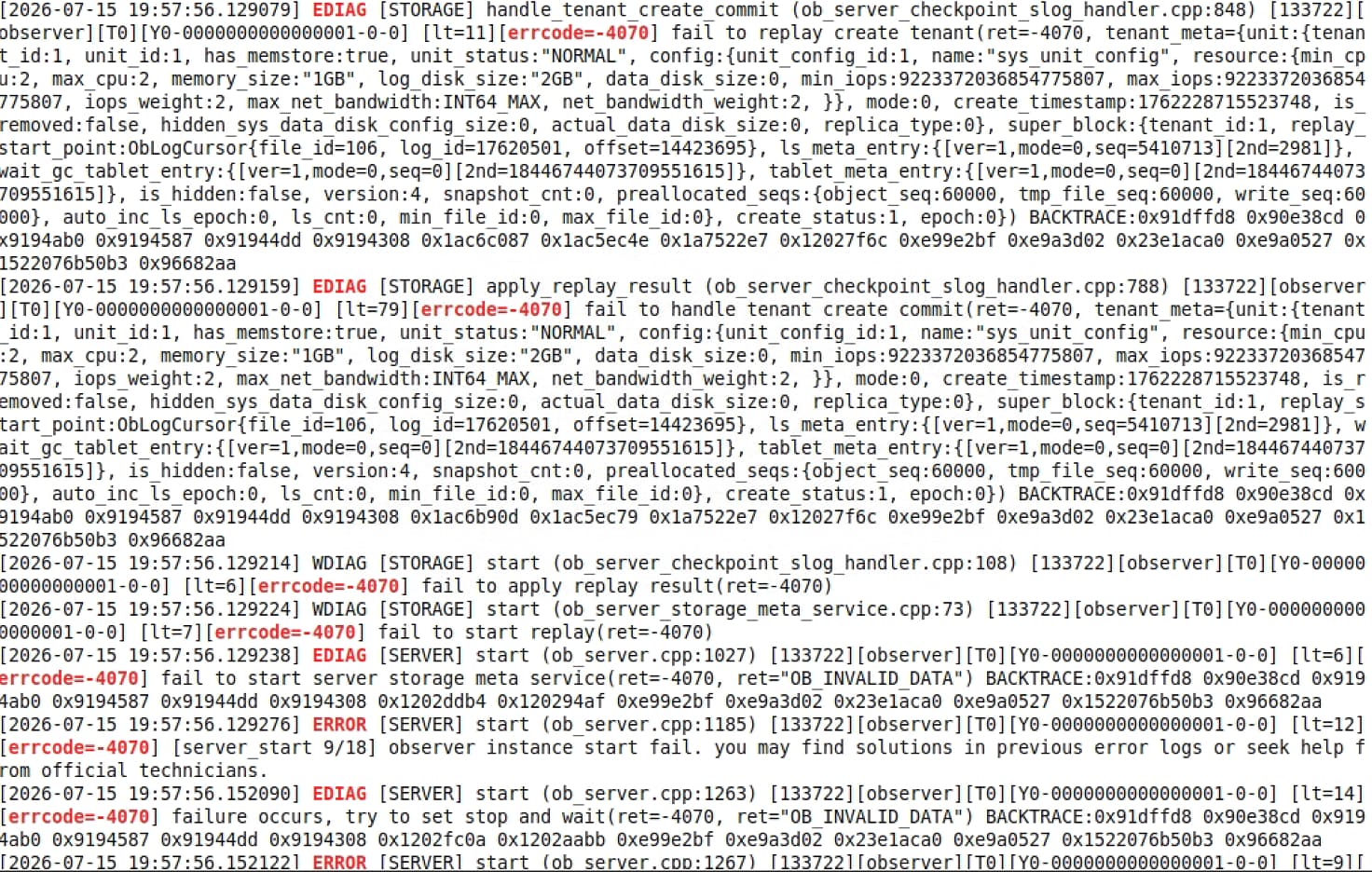

observer 启动后 10 秒自动退出,报错:
ERROR [SERVER] start (ob_server.cpp:1185) [server_start 9/18] observer instance start fail
EDIAG [STORAGE] handle_tenant_create_commit … errcode=-4070 fail to replay create tenant
EDIAG [CLOG] OB_LOG_CHECKSUM_MISMATCH … “invalid data or checksum mismatch”

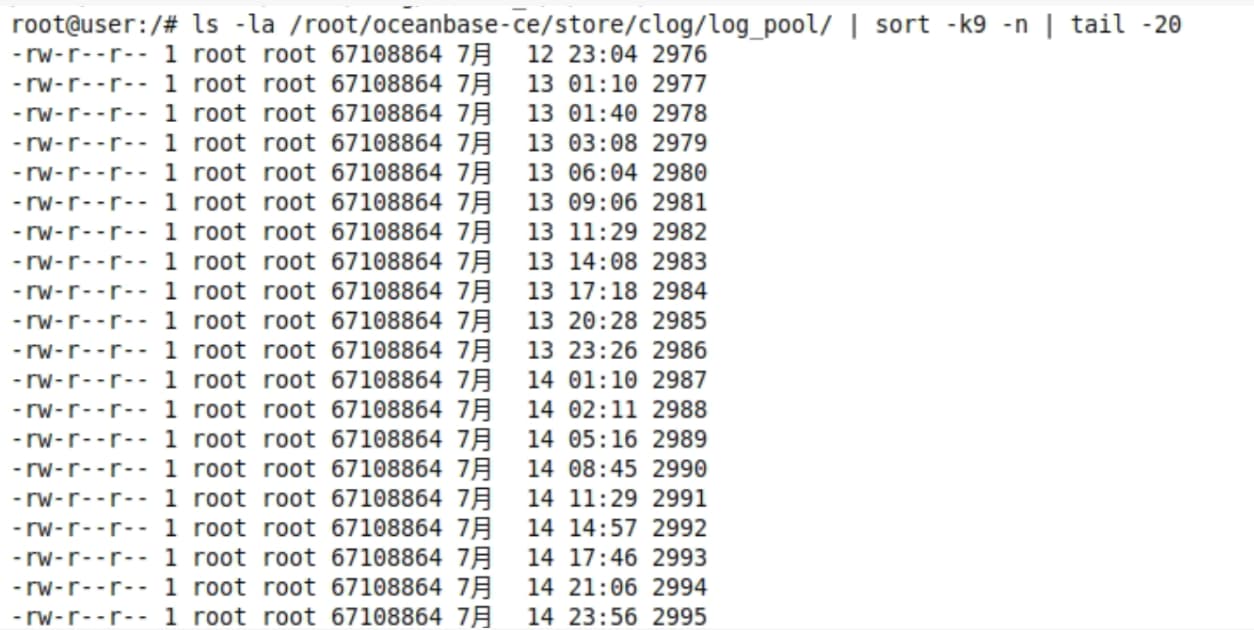

系统崩溃前内存不足(Free: 259M, Need: 6G),observer 写入 clog/log_pool/2981 时被中断,导致该文件 checksum 损坏
SSTable/slog 中的 super_block 硬编码指向 file_id=106, ls_meta_entry[2nd=2981],observer 启动时强制回放到此处
读取 block 2981 → checksum 校验失败 → -4070 → observer 退出
ob_admin log_tool dump_meta 确认:ERROR|CLOG|OB_LOG_CHECKSUM_MISMATCH|-4070|block 2981

你发下这个完整的observer.log 看下

EDIAG [STORAGE] handle tenant create comit (ob server checkpoint s log handler.cpp:848) [1337221tobserver][To][Yo-00000000000001-0-0] [lt-1l][errcode-4070] fail to replay create tenant(ret-4070, tenant meta-funit: ftenan id:1, unit id:1, has memstore:true, unit status:“NoRMAL”, config:funit config id:1, name:“sys unit config”, resource:(min cpu:2, max cpu:2, memory size: “16B”, Log disk size:“26B”, data disk size:0, min iops:9223372036854775807, max iops:9223372036854775807, 1ops weight:2, max net bandwidth: INT64 MAX, net bandvidth veight:2, }, mode:0, create timestamp:176228715523748, istarint 6Lgus0rfite-10 c00g -102050ct0rsct-144201 9 mct ntrver-1.,b=-0cg-5401312nd-2901wait gc tablet entry: ([ver-1,mode-0,seq-0][2nd-18446744073709551615]}, tablet meta entry: {[ver-1, mode-0,seq-0][2nd-1844674407309516151), 1s hidden:fal se, version4, snapshot cnt:0, preallocated segs: object seq:60000, tmp fite seq:60000, write seq:60
09194ab0 0x9194587 091944dd 8x9194308 0x1acoc087 0x1ac5ec4e 0x10752269x12027f0c 0xe99e26r bxe93002 5x23e1aca0oxe90032 0x
1522076b50b3 0x96682aa
2026-07- 15 19:5756.129159] EDIAG [SToRAGE] apply replay result (ob server checkpoint stog handLer.cpp:788) [133722][observer
[To] Y0-000000000000001-0-0] [1t=79errcode-4070] fail to handle tenant create commit(ret=-4070, tenant meta-(unit: (tenantid:1, unit id:1, has memstore:true, unit status:“NoRMAL”, config: funit config id:1, name:“sys unit config”, resource: (min cpu2, max cpu:2, memory size:“1GB”, 1og disk size:“2GB”, data disk size:0, min iops:9223372036854775807, max iops:922337203685475807, 1ops weight:2, max net bandvidth:INT64 MAX, net bandvidth weight:2, , mode:0, create timestamp:1762228715523748, isIemoved:false, hidden sys data disk config size:0, actual data disk size:0, replica type:0), super block:tenant id:1, replay start point:0bLogcursorffile id-10, 1og id=17620501, offset=14423695), 15 meta entry:[ver=1,mode-0,seg-54107131[2nd-2981]), "ait gC tablet entry: ([ver=1, mode-0,seq-0][2nd-18446744073709551651), tablet meta entry:([ver-1, mode-0,seq-0][2nd-184467440737095516151), is hidden:false, version:4, snaphot cnt:, preallocated segs:fobject seq: 60000, tmp file seq: 60000, write seq:6000), auto inc 1s epoch:0, 1s cnt:0, min file id:0, max file id:0), create status:1, epoch:0}) BACKTRACE: 0x91dffd8 ex90e38cd 0
9194ab0 0x9194587 0x91944dd 0x9194308 0x1ac6b9d 0x1ac5ec79 0x1a7522e7 0x12027f6c 0xe99e2f 0xe983d02 0x23elaca0 0xe9a0527 0x1
12026-07- 15 19:57:56.129214] wDIAG [SoRAGE] start (ob server checkpoint stog handler.cpp:108) [133722] [observer] [T0][Y0 -000000000000001-0-0] [lt=6][errcode=-4070] fail to apply replay result(ret=-4070)12026-07- 15 19:57:56.129224] WDIAG [STORAGE] start (ob server storage meta service.cpp:73) [133722]observer][T0] (Y0-000000000000001-0-0] [lt=7][errcode=-4070] fail to start replay(ret=-4070)2026-07-15 19:57:56.129238] EDIAG [SERVER] start (ob server.cpp:1027) [133722]observerl[T0][Y0-000000000000001-0-0] [Lt-61rrcode-- 4070] fail to Start server Storage meta service (ret–4070, ret=“0B INVALID DATA”) BACKTRACE:0x91dffd8 Ox90e38cd Ox9191ab0 0x9194587 0x91944dd 0x9194308 0x1202ddb4 0x120294af 0xe99e2bf 0xe9a3d02 0x23e1aca0 0xe90527 0x1522076b50b3 0x96682aa2026-07- 15 19:57:56.129276] ERROR [SERVER] start (ob server.cp:185) [133722][observer][T0][Y0 -0000000000001-0-0] [Lt-121errcode–4070] [server start 9/18] observer instance start fail. you may find solutions in previous error logs or seek help
rom official technicians
这个observer.log压缩上传一下吧
新用户无法上传附件

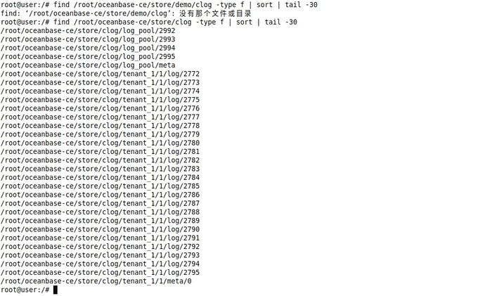

find /root/oceanbase-ce/store/clog -type f | sort | tail -30
ls -la /root/oceanbase-ce/store/clog/log_pool/ | sort -k9 -n | tail -20
查询下
clog 是 OceanBase 的 WAL( redo 日志),palf 要求 block 严格连续、可校验 。现在 block 2981 的 info block checksum 损坏,且它不是尾块,后面还有 2982~2995
  • 删 2981 留后面 → palf 读到不连续日志,仍然会报错。
  • 删 2981~2995 → 会截断 WAL,但 slog 里的 super_block.replay_start_point 仍然硬编码指向 file_id=106, ls_meta_entry[2nd=2981],启动时还会尝试回放 2981。
  • 要同时改 slog super_block + palf manifest + 截断 clog,没有官方工具,手工二进制改风险极高,极易把状态搞得更乱。
