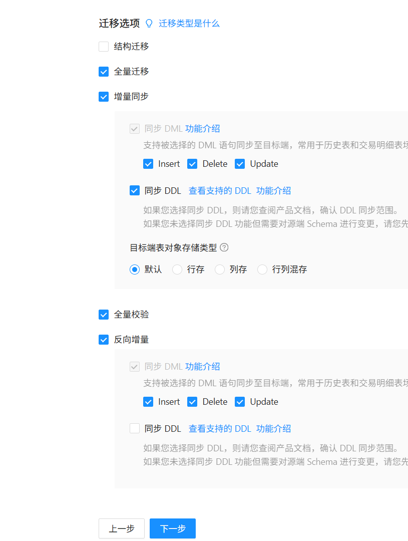

想试一下反向增量的功能, 但是在勾选了反向增量后, 在预检查阶段报错如下:
[GHANA-OPERIE000000]: Could not connect to address=(host=10.0.22.44)(port=2883)(type=master) : Could not connect to 10.0.22.44:2883 : unexpected end of stream, read 0 bytes from 4 (socket was closed by server): Could not connect to address=(host=10.0.22.44)(port=2883)(type=master) : Could not connect to 10.0.22.44:2883 : unexpected end of stream, read 0 bytes from 4 (socket was closed by server)
如果不勾这个反向增量,是没有问题的,也不可能是oms server连不上22.44:2883,因为不勾的情况下全量、增量是没问题的,可能是哪里出了问题,如何排查
