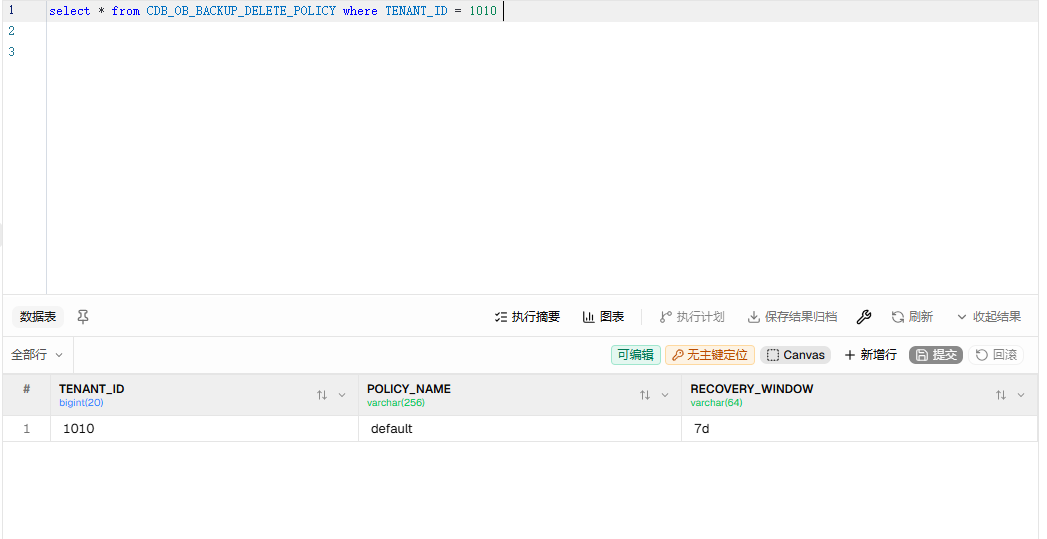

– 1. 确认自动清理是否开启(你截图里可能没显示完整列)
SELECT * FROM CDB_OB_BACKUP_DELETE_POLICY WHERE TENANT_ID = 1010;

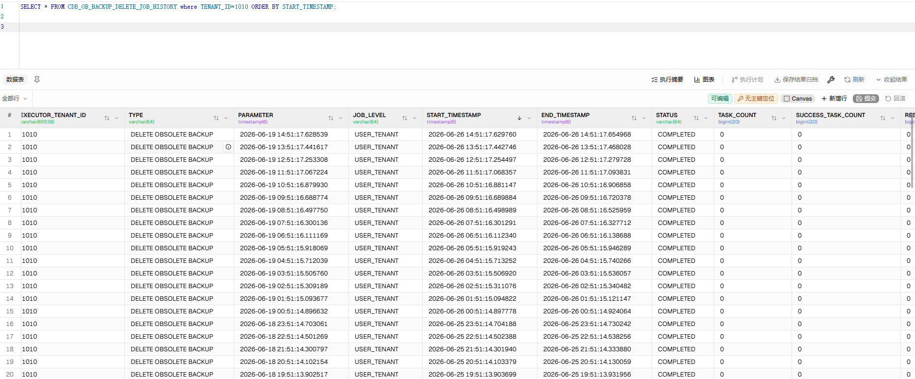

– 2. 查看删除任务详情(关注 TASK_COUNT、PARAMETER 截止时间)
SELECT START_TIMESTAMP, END_TIMESTAMP, STATUS, TASK_COUNT, SUCCESS_TASK_COUNT, PARAMETER
FROM CDB_OB_BACKUP_DELETE_JOB_HISTORY
ORDER BY START_TIMESTAMP DESC
LIMIT 10;

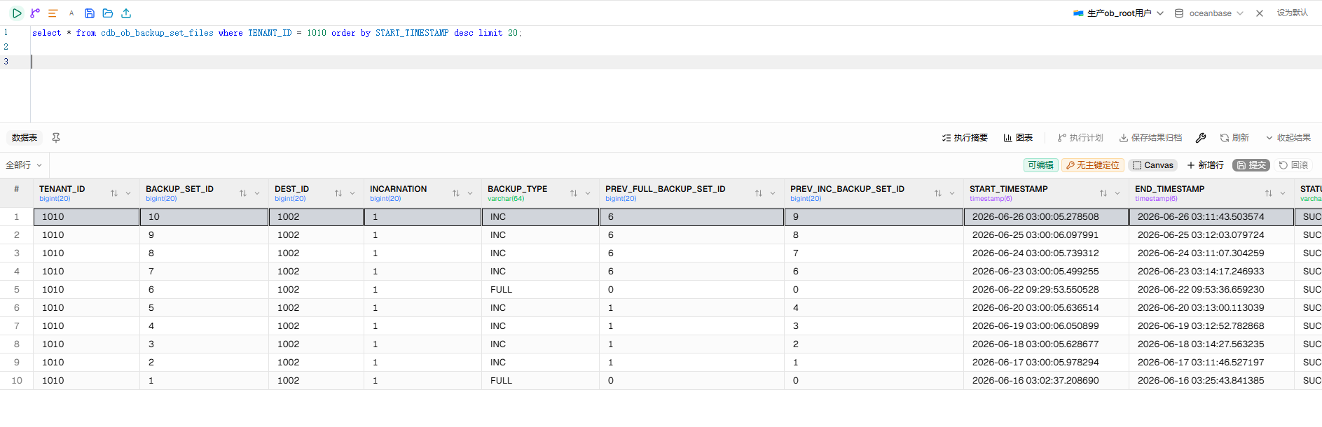

这个信息 也查一下
cdb_ob_backup_set_files
TENANT_ID	POLICY_NAME	RECOVERY_WINDOW
1010	default	7d
#TASK_COUNT 全是0,PARAMETER是对的
START_TIMESTAMP	END_TIMESTAMP	STATUS	TASK_COUNT	SUCCESS_TASK_COUNT	PARAMETER
2026-06-26 14:51:17.629760	2026-06-26 14:51:17.654968	COMPLETED	0	0	2026-06-19 14:51:17.628539
2026-06-26 13:51:17.442746	2026-06-26 13:51:17.468028	COMPLETED	0	0	2026-06-19 13:51:17.441617
2026-06-26 12:51:17.254497	2026-06-26 12:51:17.279728	COMPLETED	0	0	2026-06-19 12:51:17.253308
2026-06-26 11:51:17.068357	2026-06-26 11:51:17.093831	COMPLETED	0	0	2026-06-19 11:51:17.067224
2026-06-26 10:51:16.881147	2026-06-26 10:51:16.906858	COMPLETED	0	0	2026-06-19 10:51:16.879930
2026-06-26 09:51:16.689884	2026-06-26 09:51:16.720378	COMPLETED	0	0	2026-06-19 09:51:16.688774
2026-06-26 08:51:16.498989	2026-06-26 08:51:16.525959	COMPLETED	0	0	2026-06-19 08:51:16.497750
2026-06-26 07:51:16.301291	2026-06-26 07:51:16.327712	COMPLETED	0	0	2026-06-19 07:51:16.300136
2026-06-26 06:51:16.112340	2026-06-26 06:51:16.138688	COMPLETED	0	0	2026-06-19 06:51:16.111169
2026-06-26 05:51:15.919243	2026-06-26 05:51:15.946289	COMPLETED	0	0	2026-06-19 05:51:15.918069

TENANT_ID	BACKUP_SET_ID	DEST_ID	INCARNATION	BACKUP_TYPE	PREV_FULL_BACKUP_SET_ID	PREV_INC_BACKUP_SET_ID	START_TIMESTAMP	END_TIMESTAMP	STATUS	FILE_STATUS	ELAPSED_SECONDES	PLUS_ARCHIVELOG	START_REPLAY_SCN	START_REPLAY_SCN_DISPLAY	MIN_RESTORE_SCN	MIN_RESTORE_SCN_DISPLAY	INPUT_BYTES	OUTPUT_BYTES	OUTPUT_RATE_BYTES	EXTRA_META_BYTES	TABLET_COUNT	FINISH_TABLET_COUNT	MACRO_BLOCK_COUNT	FINISH_MACRO_BLOCK_COUNT	FILE_COUNT	META_TURN_ID	DATA_TURN_ID	RESULT	COMMENT	ENCRYPTION_MODE	PASSWD	TENANT_COMPATIBLE	BACKUP_COMPATIBLE	PATH	CLUSTER_VERSION	CONSISTENT_SCN	MINOR_TURN_ID	MAJOR_TURN_ID
1010	1	1002	1	FULL	0	0	2026-06-16 03:02:37.208690	2026-06-16 03:25:43.841385	SUCCESS	AVAILABLE	1387	OFF	1781550002344113000	2026-06-16 03:00:02.344113	1781551539798217000	2026-06-16 03:25:39.798217000	517759615384	416496197306	300365193.1819	0	7012	7012	386133	246852	0	1	0	0		NONE		4.3.5.5	4	file:///bak_all/ob_bak/gwc_cluster/1767685993/tenant_incarnation_1/1010/data	4.3.5.5	1781550243629327000	1	1
1010	2	1002	1	INC	1	1	2026-06-17 03:00:05.978294	2026-06-17 03:11:46.527197	SUCCESS	AVAILABLE	701	OFF	1781636308930875000	2026-06-17 02:58:28.930875	1781637102727161000	2026-06-17 03:11:42.727161000	455634037270	51760200661	73885206.9275	0	7012	7012	217232	217232	0	1	0	0		NONE		4.3.5.5	4	file:///bak_all/ob_bak/gwc_cluster/1767685993/tenant_incarnation_1/1010/data	4.3.5.5	1781636463167868000	1	1
1010	3	1002	1	INC	1	2	2026-06-18 03:00:05.628677	2026-06-18 03:14:27.563235	SUCCESS	AVAILABLE	862	OFF	1781719200081740009	2026-06-18 02:00:00.081740	1781723663761728000	2026-06-18 03:14:23.761728000	474720625039	66171214650	76770578.5037	0	7012	7012	226332	226332	0	1	0	0		NONE		4.3.5.5	4	file:///bak_all/ob_bak/gwc_cluster/1767685993/tenant_incarnation_1/1010/data	4.3.5.5	1781722875529062000	1	1
1010	4	1002	1	INC	1	3	2026-06-19 03:00:06.050899	2026-06-19 03:12:52.782868	SUCCESS	AVAILABLE	767	OFF	1781800501039779000	2026-06-19 00:35:01.039779	1781809968887165000	2026-06-19 03:12:48.887165000	489829167708	68449685224	89274593.9801	0	7026	7026	273210	233535	0	1	0	0		NONE		4.3.5.5	4	file:///bak_all/ob_bak/gwc_cluster/1767685993/tenant_incarnation_1/1010/data	4.3.5.5	1781809301223543000	1	1
1010	5	1002	1	INC	1	4	2026-06-20 03:00:05.636514	2026-06-20 03:13:00.113039	SUCCESS	AVAILABLE	774	OFF	1781890747189216002	2026-06-20 01:39:07.189216	1781896376289868000	2026-06-20 03:12:56.289868000	496454169343	72155655490	93167001.4014	0	7026	7026	335653	236694	0	1	0	0		NONE		4.3.5.5	4	file:///bak_all/ob_bak/gwc_cluster/1767685993/tenant_incarnation_1/1010/data	4.3.5.5	1781895695284579000	1	1
1010	6	1002	1	FULL	0	0	2026-06-22 09:29:53.550528	2026-06-22 09:53:36.659230	SUCCESS	AVAILABLE	1423	OFF	1782086171730052000	2026-06-22 07:56:11.730052	1782093212706831000	2026-06-22 09:53:32.706831000	503201487875	394540215161	277238284.4729	0	7026	7026	455510	239911	0	1	0	0		NONE		4.3.5.5	4	file:///bak_all/ob_bak/gwc_cluster/1767685993/tenant_incarnation_1/1010/data	4.3.5.5	1782091919947727001	1	1
1010	7	1002	1	INC	6	6	2026-06-23 03:00:05.499255	2026-06-23 03:14:17.246933	SUCCESS	AVAILABLE	852	OFF	1782140501039330000	2026-06-22 23:01:41.039330	1782155653403819000	2026-06-23 03:14:13.403819000	511410287445	81976751443	96245347.7249	0	7031	7031	517432	243825	0	1	0	0		NONE		4.3.5.5	4	file:///bak_all/ob_bak/gwc_cluster/1767685993/tenant_incarnation_1/1010/data	4.3.5.5	1782154908148435000	1	1
1010	8	1002	1	INC	6	7	2026-06-24 03:00:05.739312	2026-06-24 03:11:07.304259	SUCCESS	AVAILABLE	662	OFF	1782237600225106039	2026-06-24 02:00:00.225106	1782241863503847000	2026-06-24 03:11:03.503847000	447698358235	36864733853	55723529.5192	0	7032	7032	213449	213449	0	1	0	0		NONE		4.3.5.5	4	file:///bak_all/ob_bak/gwc_cluster/1767685993/tenant_incarnation_1/1010/data	4.3.5.5	1782241261012772000	1	1
1010	9	1002	1	INC	6	8	2026-06-25 03:00:06.097991	2026-06-25 03:12:03.079724	SUCCESS	AVAILABLE	717	OFF	1782325325695490008	2026-06-25 02:22:05.695490	1782328319216916000	2026-06-25 03:11:59.216916000	464583065007	45454788955	63397415.6703	0	7041	7041	221499	221499	0	1	0	0		NONE		4.3.5.5	4	file:///bak_all/ob_bak/gwc_cluster/1767685993/tenant_incarnation_1/1010/data	4.3.5.5	1782327669757439000	1	1
1010	10	1002	1	INC	6	9	2026-06-26 03:00:05.278508	2026-06-26 03:11:43.503574	SUCCESS	AVAILABLE	698	OFF	1782402113146813001	2026-06-25 23:41:53.146813	1782414699669675000	2026-06-26 03:11:39.669675000	476884518887	50120507692	71782739.0230	0	7063	7063	263848	227364	0	1	0	0		NONE		4.3.5.5	4	file:///bak_all/ob_bak/gwc_cluster/1767685993/tenant_incarnation_1/1010/data	4.3.5.5	1782414085798331000	1	1

链1: FULL(1) 06-16 → INC(2~5) 06-17 ~ 06-20 (依赖 full set 1)
链2: FULL(6) 06-22 → INC(7~10) 06-23 ~ 06-26 (依赖 full set 6)
链1 06-20 03:13 约6.5天 看着都在七天内 不能删除呀 符合预期呀
一个FULL一个FULL的删除吗?等FULL里面的最后一个增量过期后,这个FULL就会被删除是吗?
那比如我只想保留单整个FULL,删除设置天数就是3天或者4天?
肯定呀 要不然你的备份增量有什么意义 他是依赖全备的
只想要 FULL、不要 INC不支持,链内 FULL 和 INC 一起删、一起留
