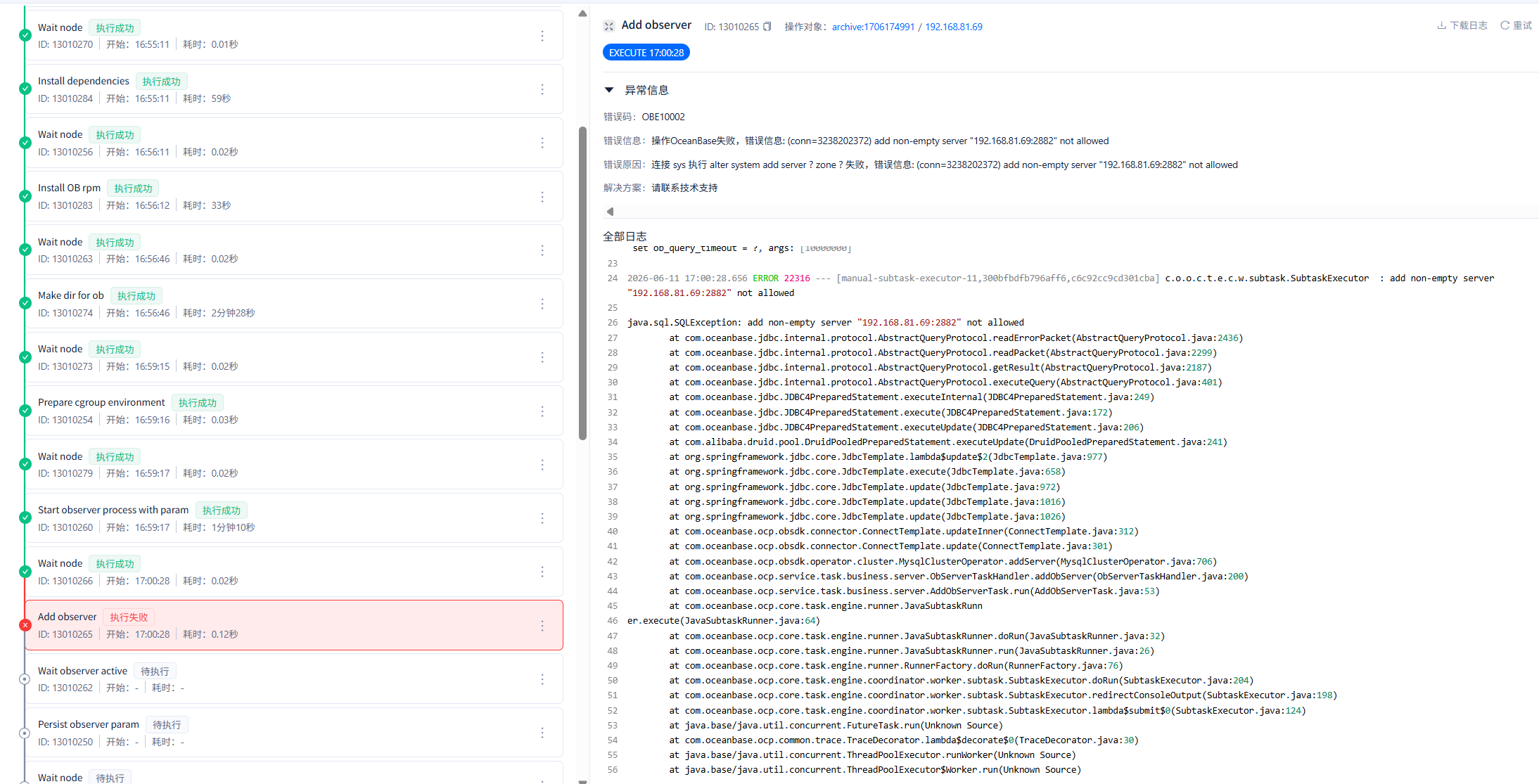

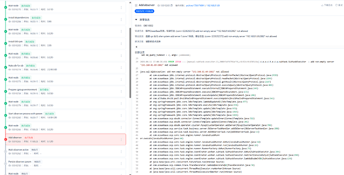

81.69昨天掉盘了,ocp上执行的从集群删除节点成功,今天盘修好了打算加回集群,报错机器非空不让加,现在是需要清理哪里的东西吗?

1、原因是:192.168.81.69 上 observer 本地存储已有数据,因此内核拒绝加入。
Cannot create symbolic link from /data/1/archive/sstable
to /opt/oceanbase/oceanbase/store/archive/sstable
reason: symlink … file exists
结论:之前目录没有删除干净,删除干净以后添加没有问题

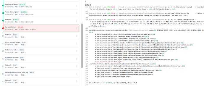

2、重新添加节点磁盘的ops没有过去

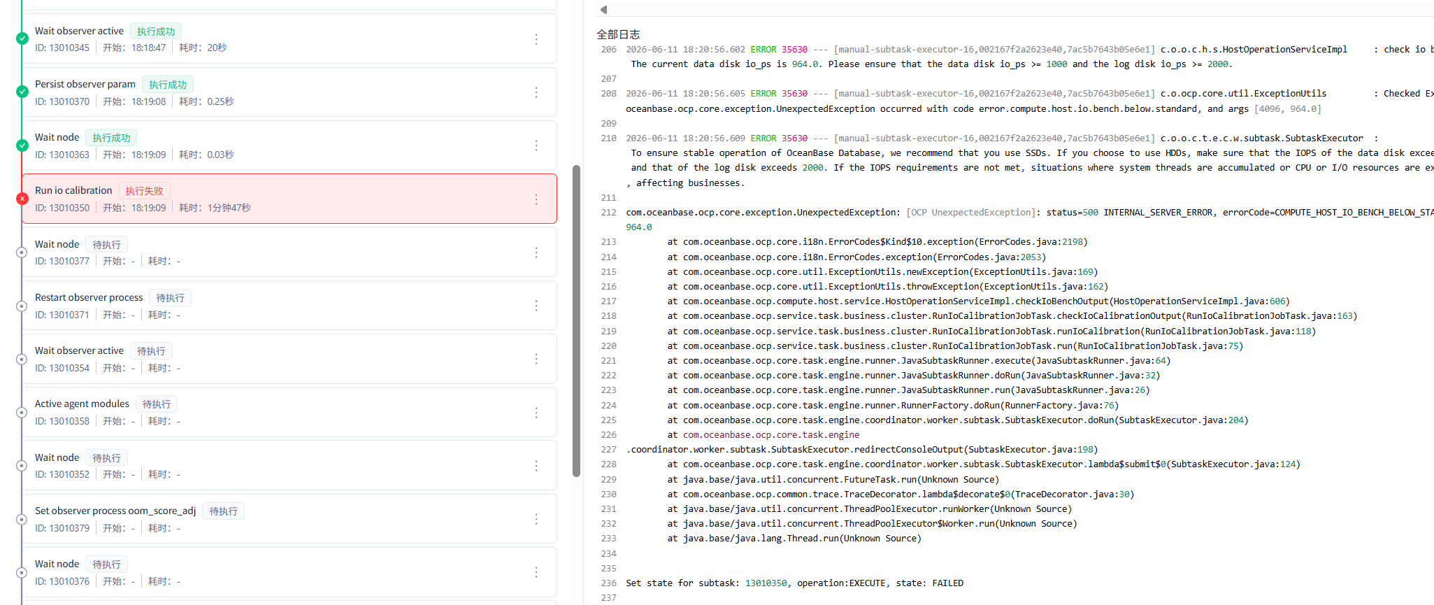

[manual-subtask-executor-16,002167f2a2623e40,110e1dedb56d6df5] c.o.o.c.h.s.HostOperationServiceImpl : check io bench output failed. The current data disk io_ps is 964.0. Please ensure that the data disk io_ps >= 1000 and the log disk io_ps >= 2000

3、手动执行
ALTER SYSTEM RUN JOB “io_calibration” SERVER = ‘192.168.81.69:2882’;
4、检查iops信息
obclient(root@sys)[(none)]> SELECT * FROM oceanbase.GV$OB_IO_BENCHMARK where svr_ip=‘192.168.81.69’;
| SVR_IP | SVR_PORT | STORAGE_NAME | MODE | SIZE | IOPS | MBPS | LATENCY |
| 192.168.81.69 | 2882 | DATA | READ | 4096 | 5103 | 19 | 3136 |
| 192.168.81.69 | 2882 | DATA | READ | 8192 | 5960 | 46 | 2687 |
| 192.168.81.69 | 2882 | DATA | READ | 16384 | 5181 | 80 | 3090 |
| 192.168.81.69 | 2882 | DATA | READ | 32768 | 3984 | 124 | 4019 |
| 192.168.81.69 | 2882 | DATA | READ | 65536 | 2682 | 167 | 5974 |
| 192.168.81.69 | 2882 | DATA | READ | 131072 | 1650 | 206 | 9715 |
| 192.168.81.69 | 2882 | DATA | READ | 262144 | 926 | 231 | 17317 |
| 192.168.81.69 | 2882 | DATA | READ | 524288 | 608 | 304 | 26391 |
| 192.168.81.69 | 2882 | DATA | READ | 1048576 | 407 | 407 | 39413 |
| 192.168.81.69 | 2882 | DATA | READ | 2097152 | 294 | 588 | 54602 |
| 192.168.81.69 | 2882 | DATA | WRITE | 4096 | 7985 | 31 | 2004 |
| 192.168.81.69 | 2882 | DATA | WRITE | 8192 | 4409 | 34 | 3629 |
| 192.168.81.69 | 2882 | DATA | WRITE | 16384 | 3649 | 57 | 4387 |
| 192.168.81.69 | 2882 | DATA | WRITE | 32768 | 3055 | 95 | 5237 |
| 192.168.81.69 | 2882 | DATA | WRITE | 65536 | 2129 | 133 | 7523 |
| 192.168.81.69 | 2882 | DATA | WRITE | 131072 | 1287 | 160 | 12445 |
| 192.168.81.69 | 2882 | DATA | WRITE | 262144 | 750 | 187 | 21385 |
| 192.168.81.69 | 2882 | DATA | WRITE | 524288 | 431 | 215 | 37194 |
| 192.168.81.69 | 2882 | DATA | WRITE | 1048576 | 282 | 282 | 57039 |
| 192.168.81.69 | 2882 | DATA | WRITE | 2097152 | 207 | 414 | 77704 |
20 rows in set (0.041 sec)

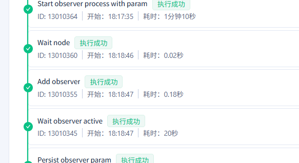

5、ocp重试以后过去了
