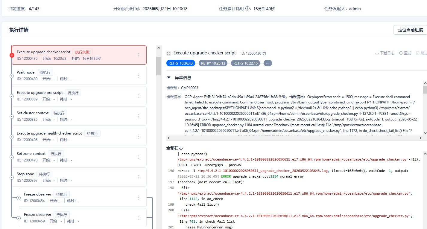

V4.3.5.6升级至V4.4.2.1报错
【 OB or 其他组件 】OCP升级OB集群
【 使用版本 】V4.3.5.6
【问题描述】升级到V4.4.2.1报错
subtask_12000430.log (173.4 KB)

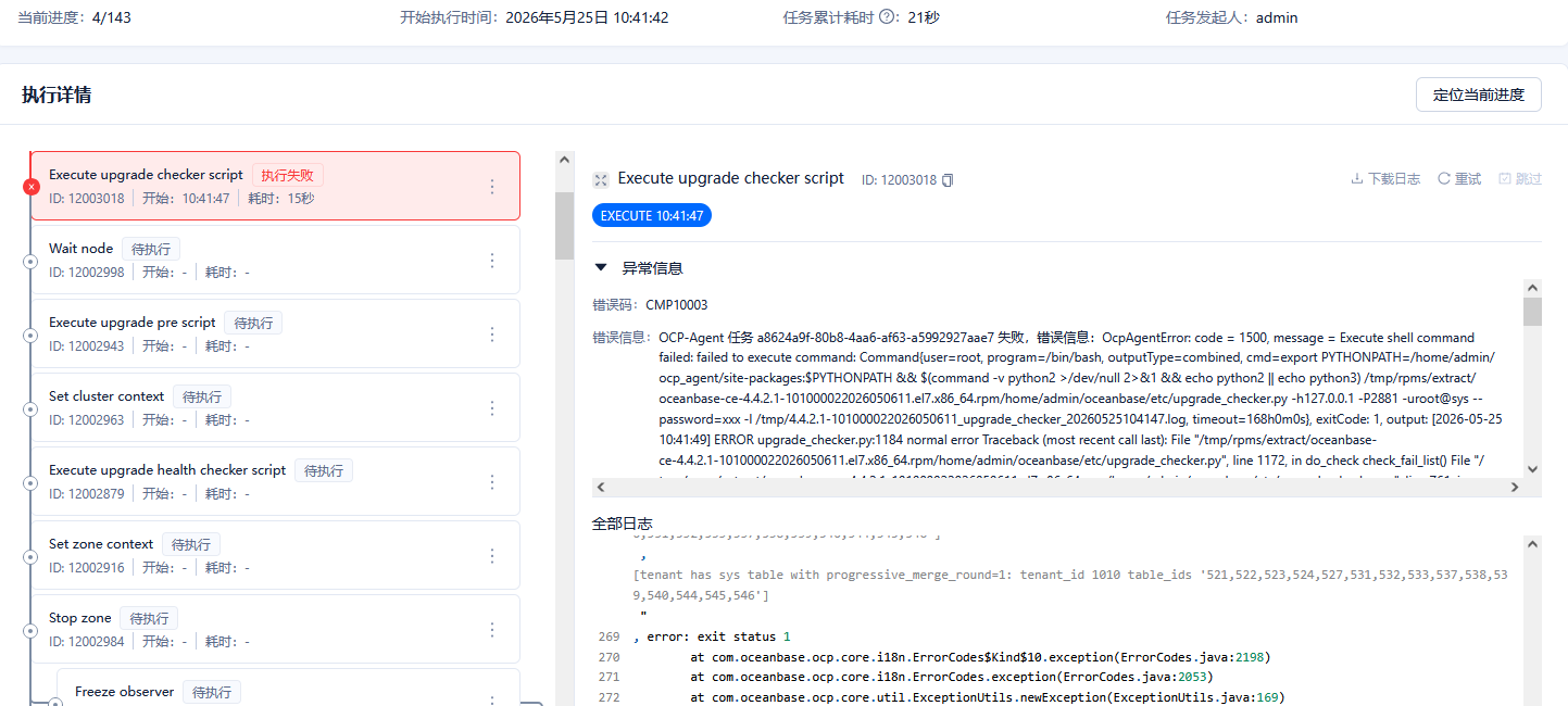

"upgrade checker failed with 5 reasons: [tenant has sys table with progressive_merge_round=1: tenant_id 1 table_ids ‘232,233,366,410,411,425,426,427,428,453,454,482,487,488,501,503,504,508,511,512,513,514,515,516,517,521,522,523,524,525,526,527,530,531,532,533,537,538,539,540,544,545,546’] , [tenant has sys table with progressive_merge_round=1: tenant_id 1005 table_ids ‘410,411,482,487,488,501,503,504,508,511,516,517,521,522,523,524,525,526,527,530,531,532,533,537,538,539,540,544,545,546’] , [tenant has sys table with progressive_merge_round=1: tenant_id 1006 table_ids ‘482,503,504,521,522,523,524,527,531,532,533,537,538,539,540,544,545,546’] , [tenant has sys table with progressive_merge_round=1: tenant_id 1009 table_ids ‘487,488,501,521,522,523,524,525,526,527,530,531,532,533,537,538,539,540,544,545,546’] , [tenant has sys table with progressive_merge_round=1: tenant_id 1010 table_ids ‘521,522,523,524,527,531,532,533,537,538,539,540,544,545,546’] "
, error: exit status 1,
version_comment	OceanBase_CE 4.3.5.6 (r106000012026040916-560923b02bdb9ed88dbd7940ac97a2e183c09b29) (Built Apr  9 2026 17:11:14)
第一次失败之后我特意进去做了一次合并的。
刚又合并了一次,升级任务依旧报错。

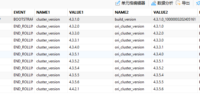

应该是个已知问题。检查下集群历史升级路径是否经过 4.3.5.5 hotfix0~hotfix4 版本。
select * from __all_cluster_event_history;
你给的SQL:1046 - No database selected

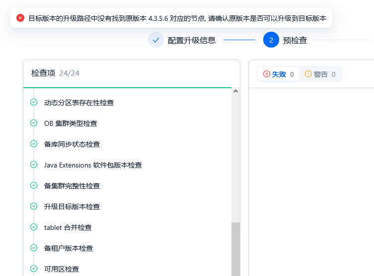

我换了个方式
select * from oceanbase.DBA_OB_CLUSTER_EVENT_HISTORY GROUP BY value1

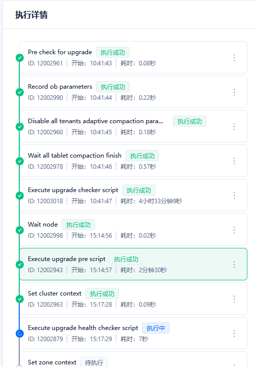

升级卡住时手动执行该命令,然后重试白屏升级任务
alter system run upgrade job ‘4.3.5.5’;
关注下。我也想升级
sys租户中执行
alter system run upgrade job '4.3.5.5';
再重试任务,升级继续推进了,晚点我再继续反馈。
你也从这个版本升级的吗
升级成功了。 @辞霜 愿不愿意解密一下我到底遇到了什么bug。
