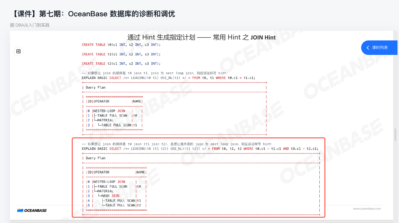

【问题描述】测试OB LEADING hint功能时候,发现没按预期Join,官方课程中说明是 先t1 join t2,结果再Join t0,实际测试下来是 先 t0 Join t1,再join t2
【复现路径】
CREATE TABLE t0(c1 INT, c2 INT, c3 INT);
CREATE TABLE t1(c1 INT, c2 INT, c3 INT);
CREATE TABLE t2(c1 INT, c2 INT, c3 INT);
-- 如果想让 join 的顺序是 t0 join (t1 join t2), 且想让最外层的 join 为 nest loop join, 则应该这样写 hint:
EXPLAIN BASIC SELECT /*+ LEADING(t0 (t1 t2)) USE_NL((t1 t2)) */ * FROM t0, t1, t2 WHERE t0.c1 = t1.c1 AND t0.c1 = t2.c1;

|       equal_conds([t1.c1(0x7f05b2624630) = t2.c1(0x7f05b2624d80)(0x7f05b26c6a30)]), other_conds(nil)                                                                                       |
|   6 - output([t1.c1(0x7f05b2624630)], [t1.c2(0x7f05b2625320)], [t1.c3(0x7f05b26254b0)]), filter(nil), rowset=16                                                                            |
|       access([t1.c1(0x7f05b2624630)], [t1.c2(0x7f05b2625320)], [t1.c3(0x7f05b26254b0)]), partitions(p0)                                                                                    |
|       is_index_back=false, is_global_index=false,                                                                                                                                          |
|       range_key([t1.__pk_increment(0x7f05b26262c0)]), range(MIN ; MAX)always true                                                                                                          |
|   7 - output([t2.c1(0x7f05b2624d80)], [t2.c2(0x7f05b2625640)], [t2.c3(0x7f05b26257d0)]), filter(nil), rowset=16                                                                            |
|       access([t2.c1(0x7f05b2624d80)], [t2.c2(0x7f05b2625640)], [t2.c3(0x7f05b26257d0)]), partitions(p0)                                                                                    |
|       range_key([t2.__pk_increment(0x7f05b2626450)]), range(MIN ; MAX)always true                                                                                                          |
| Used Hint:                                                                                                                                                                                 |
|       LEADING(("t0" ("t1" "t2")))                                                                                                                                                          |
|       USE_NL(("t1" "t2"))                                                                                                                                                                  |
| Qb name trace:                                                                                                                                                                             |
|   stmt_id:0, stmt_type:T_EXPLAIN                                                                                                                                                           |
|   stmt_id:1, SEL$1                                                                                                                                                                         |
| Outline Data:                                                                                                                                                                              |
|       BEGIN_OUTLINE_DATA                                                                                                                                                                   |
|       LEADING(@"SEL$1" ("sbtest"."t0"@"SEL$1" ("sbtest"."t1"@"SEL$1" "sbtest"."t2"@"SEL$1")))                                                                                              |
|       USE_NL(@"SEL$1" ("sbtest"."t2"@"SEL$1" "sbtest"."t1"@"SEL$1"))                                                                                                                       |
|       USE_NL_MATERIALIZATION(@"SEL$1" ("sbtest"."t2"@"SEL$1" "sbtest"."t1"@"SEL$1"))                                                                                                       |
|       FULL(@"SEL$1" "sbtest"."t0"@"SEL$1")                                                                                                                                                 |
|       USE_HASH(@"SEL$1" "sbtest"."t2"@"SEL$1")                                                                                                                                             |
|       FULL(@"SEL$1" "sbtest"."t1"@"SEL$1")                                                                                                                                                 |
|       FULL(@"SEL$1" "sbtest"."t2"@"SEL$1")                                                                                                                                                 |
|       OPTIMIZER_FEATURES_ENABLE('4.5.0.0')                                                                                                                                                 |
|       END_OUTLINE_DATA                                                                                                                                                                     |
| Optimization Info:                                                                                                                                                                         |
|   t0:                                                                                                                                                                                      |
|       table_rows:1                                                                                                                                                                         |
|       physical_range_rows:1                                                                                                                                                                |
|       logical_range_rows:1                                                                                                                                                                 |
|       output_rows:1                                                                                                                                                                        |
|       table_dop:1                                                                                                                                                                          |
|       dop_method:Table DOP                                                                                                                                                                 |
|       avaiable_index_name:[t0]                                                                                                                                                             |
|       stats info:[version=1970-01-01 08:00:00.000000, is_locked=0, is_expired=0]                                                                                                           |
|       dynamic sampling level:1                                                                                                                                                             |
|       estimation method:[STORAGE, DYNAMIC SAMPLING FULL]                                                                                                                                   |
|   t1:                                                                                                                                                                                      |
|       table_rows:1                                                                                                                                                                         |
|       output_rows:1                                                                                                                                                                        |
|       table_dop:1                                                                                                                                                                          |
|       avaiable_index_name:[t1]                                                                                                                                                             |
|   t2:                                                                                                                                                                                      |
|       table_rows:1                                                                                                                                                                         |
|       output_rows:1                                                                                                                                                                        |
|       table_dop:1                                                                                                                                                                          |
|       avaiable_index_name:[t2]                                                                                                                                                             |
|   Plan Type:                                                                                                                                                                               |
|       REMOTE                                                                                                                                                                               |
|   Note:                                                                                                                                                                                    |
|       Degree of Parallelisim is 1 because of table property                                                                                                                                |
100 rows in set (0.00 sec)
