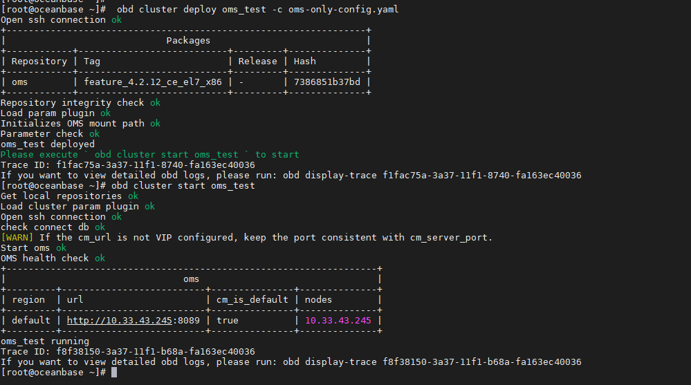

是我配置文件哪有问题吗?我是部署oms时用obd安装好了,但就是起不来:
[root@oceanbase ~]# obd cluster deploy oms_kaifa -c oms-only-config.yaml
Open ssh connection ok
| Packages |
| Repository | Tag | Release | Hash |
| oms | feature_4.2.12_ce_el7_x86 | - | 7386851b37bd |
Repository integrity check ok
Load param plugin ok
Initializes OMS mount path ok
Parameter check ok
oms_kaifa deployed
Please execute obd cluster start oms_kaifa to start
Trace ID: 247d7fba-3a06-11f1-825b-fa163ec40036
If you want to view detailed obd logs, please run: obd display-trace 247d7fba-3a06-11f1-825b-fa163ec40036
[root@oceanbase ~]# obd cluster start oms
[ERROR] Deploy “oms” is destroyed. You could not start an destroyed cluster.
Trace ID: 2ef9478a-3a06-11f1-a3cd-fa163ec40036
If you want to view detailed obd logs, please run: obd display-trace 2ef9478a-3a06-11f1-a3cd-fa163ec40036
[root@oceanbase ~]# obd cluster start oms_kaifa
Get local repositories ok
Load cluster param plugin ok
check connect db ok
[WARN] If the cm_url is not VIP configured, keep the port consistent with cm_server_port.
Start oms ok
OMS health check x
[ERROR] 10.33.43.245: health check failed
Trace ID: 3201a044-3a06-11f1-b34f-fa163ec40036
If you want to view detailed obd logs, please run: obd display-trace 3201a044-3a06-11f1-b34f-fa163ec40036

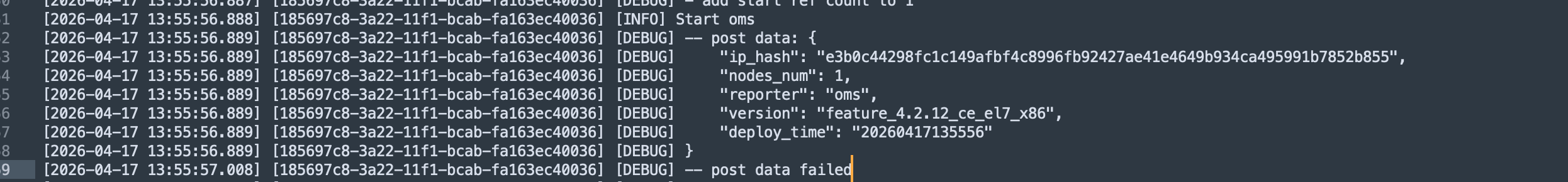

[2026-04-17 10:36:14.454] [3201a044-3a06-11f1-b34f-fa163ec40036] [DEBUG] - Searching distribute_config plugin for oms-feature_4.2.12_ce_el7_x86–7386851b37bd
[2026-04-17 10:36:14.454] [3201a044-3a06-11f1-b34f-fa163ec40036] [DEBUG] - Found for oms-py_script_distribute_config-1.0.0 for oms-feature_4.2.12_ce_el7_x86
[2026-04-17 10:36:14.454] [3201a044-3a06-11f1-b34f-fa163ec40036] [DEBUG] - Call plugin oms-py_script_distribute_config-1.0.0 for oms-feature_4.2.12_ce_el7_x86–7386851b37bd
[2026-04-17 10:36:14.455] [3201a044-3a06-11f1-b34f-fa163ec40036] [DEBUG] - import distribute_config
[2026-04-17 10:36:14.456] [3201a044-3a06-11f1-b34f-fa163ec40036] [DEBUG] - add distribute_config ref count to 1
[2026-04-17 10:36:14.456] [3201a044-3a06-11f1-b34f-fa163ec40036] [DEBUG] – distribute config
[2026-04-17 10:36:14.457] [3201a044-3a06-11f1-b34f-fa163ec40036] [DEBUG] - sub distribute_config ref count to 0
[2026-04-17 10:36:14.457] [3201a044-3a06-11f1-b34f-fa163ec40036] [DEBUG] - export distribute_config
[2026-04-17 10:36:14.457] [3201a044-3a06-11f1-b34f-fa163ec40036] [DEBUG] - plugin oms-py_script_distribute_config-1.0.0 result: True
[2026-04-17 10:36:14.457] [3201a044-3a06-11f1-b34f-fa163ec40036] [DEBUG] - Searching start plugin for components …
[2026-04-17 10:36:14.457] [3201a044-3a06-11f1-b34f-fa163ec40036] [DEBUG] - Searching start plugin for oms-feature_4.2.12_ce_el7_x86–7386851b37bd
[2026-04-17 10:36:14.458] [3201a044-3a06-11f1-b34f-fa163ec40036] [DEBUG] - Found for oms-py_script_start-1.0.0 for oms-feature_4.2.12_ce_el7_x86
[2026-04-17 10:36:14.458] [3201a044-3a06-11f1-b34f-fa163ec40036] [DEBUG] - Call plugin oms-py_script_start-1.0.0 for oms-feature_4.2.12_ce_el7_x86–7386851b37bd
[2026-04-17 10:36:14.458] [3201a044-3a06-11f1-b34f-fa163ec40036] [DEBUG] - import start
[2026-04-17 10:36:14.459] [3201a044-3a06-11f1-b34f-fa163ec40036] [DEBUG] - add start ref count to 1
[2026-04-17 10:36:14.460] [3201a044-3a06-11f1-b34f-fa163ec40036] [INFO] Start oms
[2026-04-17 10:36:14.461] [3201a044-3a06-11f1-b34f-fa163ec40036] [DEBUG] – post data: {
[2026-04-17 10:36:14.461] [3201a044-3a06-11f1-b34f-fa163ec40036] [DEBUG] “ip_hash”: “e3b0c44298fc1c149afbf4c8996fb92427ae41e4649b934ca495991b7852b855”,
[2026-04-17 10:36:14.461] [3201a044-3a06-11f1-b34f-fa163ec40036] [DEBUG] “nodes_num”: 1,
[2026-04-17 10:36:14.461] [3201a044-3a06-11f1-b34f-fa163ec40036] [DEBUG] “reporter”: “oms”,
[2026-04-17 10:36:14.461] [3201a044-3a06-11f1-b34f-fa163ec40036] [DEBUG] “version”: “feature_4.2.12_ce_el7_x86”,
[2026-04-17 10:36:14.461] [3201a044-3a06-11f1-b34f-fa163ec40036] [DEBUG] “deploy_time”: “20260417103614”
[2026-04-17 10:36:14.461] [3201a044-3a06-11f1-b34f-fa163ec40036] [DEBUG] }
[2026-04-17 10:36:14.578] [3201a044-3a06-11f1-b34f-fa163ec40036] [DEBUG] – post data failed
[2026-04-17 10:36:14.593] [3201a044-3a06-11f1-b34f-fa163ec40036] [DEBUG] - sub start ref count to 0
[2026-04-17 10:36:14.593] [3201a044-3a06-11f1-b34f-fa163ec40036] [DEBUG] - export start
[2026-04-17 10:36:14.593] [3201a044-3a06-11f1-b34f-fa163ec40036] [DEBUG] - plugin oms-py_script_start-1.0.0 result: True
[2026-04-17 10:36:14.593] [3201a044-3a06-11f1-b34f-fa163ec40036] [DEBUG] - Searching health_check plugin for components …
[2026-04-17 10:36:14.593] [3201a044-3a06-11f1-b34f-fa163ec40036] [DEBUG] - Searching health_check plugin for oms-feature_4.2.12_ce_el7_x86–7386851b37bd
[2026-04-17 10:36:14.594] [3201a044-3a06-11f1-b34f-fa163ec40036] [DEBUG] - Found for oms-py_script_health_check-1.0.0 for oms-feature_4.2.12_ce_el7_x86
[2026-04-17 10:36:14.594] [3201a044-3a06-11f1-b34f-fa163ec40036] [DEBUG] - Call plugin oms-py_script_health_check-1.0.0 for oms-feature_4.2.12_ce_el7_x86–7386851b37bd
[2026-04-17 10:36:14.594] [3201a044-3a06-11f1-b34f-fa163ec40036] [DEBUG] - import health_check
[2026-04-17 10:36:14.596] [3201a044-3a06-11f1-b34f-fa163ec40036] [DEBUG] - add health_check ref count to 1
[2026-04-17 10:36:14.596] [3201a044-3a06-11f1-b34f-fa163ec40036] [INFO] OMS health check
[2026-04-17 10:51:15.020] [3201a044-3a06-11f1-b34f-fa163ec40036] [ERROR] [ERROR] 10.33.43.245: health check failed
[2026-04-17 10:51:15.021] [3201a044-3a06-11f1-b34f-fa163ec40036] [DEBUG] - sub health_check ref count to 0
[2026-04-17 10:51:15.022] [3201a044-3a06-11f1-b34f-fa163ec40036] [DEBUG] - export health_check
[2026-04-17 10:51:15.022] [3201a044-3a06-11f1-b34f-fa163ec40036] [DEBUG] - plugin oms-py_script_health_check-1.0.0 result: False
[2026-04-17 10:51:15.026] [3201a044-3a06-11f1-b34f-fa163ec40036] [INFO] Trace ID: 3201a044-3a06-11f1-b34f-fa163ec40036
[2026-04-17 10:51:15.026] [3201a044-3a06-11f1-b34f-fa163ec40036] [INFO] If you want to view detailed obd logs, please run: obd display-trace 3201a044-3a06-11f1-b34f-fa163ec40036
[2026-04-17 10:51:15.028] [3201a044-3a06-11f1-b34f-fa163ec40036] [DEBUG] - unlock /root/.obd/lock/global
[2026-04-17 10:51:15.028] [3201a044-3a06-11f1-b34f-fa163ec40036] [DEBUG] - unlock /root/.obd/lock/deploy_oms_kaifa
[2026-04-17 10:51:15.028] [3201a044-3a06-11f1-b34f-fa163ec40036] [DEBUG] - unlock /root/.obd/lock/mirror_and_repo

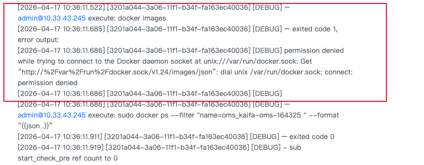

obd日志: 默认保存在安装obd的用户home路径: cd ~/.obd/log/ 整体文件发一下 看看

[2026-04-17 10:36:10.838] [3201a044-3a06-11f1-b34f-fa163ec40036] [DEBUG] - cmd: [‘oms_kaifa’]
[2026-04-17 10:36:10.838] [3201a044-3a06-11f1-b34f-fa163ec40036] [DEBUG] - opts: {‘servers’: None, ‘components’: None, ‘force_delete’: None, ‘strict_check’: None, ‘with_parameter’: None, ‘service_names’: None}
[2026-04-17 10:36:10.839] [3201a044-3a06-11f1-b34f-fa163ec40036] [DEBUG] - mkdir /root/.obd/lock/
[2026-04-17 10:36:10.839] [3201a044-3a06-11f1-b34f-fa163ec40036] [DEBUG] - unknown lock mode
[2026-04-17 10:36:10.839] [3201a044-3a06-11f1-b34f-fa163ec40036] [DEBUG] - try to get share lock /root/.obd/lock/global
[2026-04-17 10:36:10.839] [3201a044-3a06-11f1-b34f-fa163ec40036] [DEBUG] - share lock /root/.obd/lock/global, count 1
[2026-04-17 10:36:10.839] [3201a044-3a06-11f1-b34f-fa163ec40036] [DEBUG] - Get Deploy by name
[2026-04-17 10:36:10.839] [3201a044-3a06-11f1-b34f-fa163ec40036] [DEBUG] - mkdir /root/.obd/cluster/
[2026-04-17 10:36:10.840] [3201a044-3a06-11f1-b34f-fa163ec40036] [DEBUG] - mkdir /root/.obd/config_parser/
[2026-04-17 10:36:10.840] [3201a044-3a06-11f1-b34f-fa163ec40036] [DEBUG] - try to get exclusive lock /root/.obd/lock/deploy_oms_kaifa
[2026-04-17 10:36:10.840] [3201a044-3a06-11f1-b34f-fa163ec40036] [DEBUG] - exclusive lock /root/.obd/lock/deploy_oms_kaifa, count 1
[2026-04-17 10:36:10.844] [3201a044-3a06-11f1-b34f-fa163ec40036] [DEBUG] - Deploy status judge
[2026-04-17 10:36:10.844] [3201a044-3a06-11f1-b34f-fa163ec40036] [INFO] Get local repositories
[2026-04-17 10:36:10.845] [3201a044-3a06-11f1-b34f-fa163ec40036] [DEBUG] - mkdir /root/.obd/repository
[2026-04-17 10:36:10.846] [3201a044-3a06-11f1-b34f-fa163ec40036] [DEBUG] - Get local repository oms-feature_4.2.12_ce_el7_x86-7386851b37bd
[2026-04-17 10:36:10.846] [3201a044-3a06-11f1-b34f-fa163ec40036] [DEBUG] - Search repository oms version: feature_4.2.12_ce_el7_x86, tag: 7386851b37bd, release: None, package_hash: None
[2026-04-17 10:36:10.846] [3201a044-3a06-11f1-b34f-fa163ec40036] [DEBUG] - try to get share lock /root/.obd/lock/mirror_and_repo
[2026-04-17 10:36:10.846] [3201a044-3a06-11f1-b34f-fa163ec40036] [DEBUG] - share lock /root/.obd/lock/mirror_and_repo, count 1
[2026-04-17 10:36:10.846] [3201a044-3a06-11f1-b34f-fa163ec40036] [DEBUG] - mkdir /root/.obd/repository/oms
[2026-04-17 10:36:10.848] [3201a044-3a06-11f1-b34f-fa163ec40036] [DEBUG] - Found repository oms-feature_4.2.12_ce_el7_x86–7386851b37bd
[2026-04-17 10:36:10.976] [3201a044-3a06-11f1-b34f-fa163ec40036] [DEBUG] - Get deploy config
[2026-04-17 10:36:10.977] [3201a044-3a06-11f1-b34f-fa163ec40036] [INFO] Load cluster param plugin
[2026-04-17 10:36:10.977] [3201a044-3a06-11f1-b34f-fa163ec40036] [DEBUG] - Get local repository oms-feature_4.2.12_ce_el7_x86-7386851b37bd
[2026-04-17 10:36:10.978] [3201a044-3a06-11f1-b34f-fa163ec40036] [DEBUG] - Searching param plugin for components …
[2026-04-17 10:36:10.978] [3201a044-3a06-11f1-b34f-fa163ec40036] [DEBUG] - Search param plugin for oms
[2026-04-17 10:36:10.978] [3201a044-3a06-11f1-b34f-fa163ec40036] [DEBUG] - mkdir /root/.obd/plugins
[2026-04-17 10:36:10.979] [3201a044-3a06-11f1-b34f-fa163ec40036] [DEBUG] - Found for oms-param-1.0.0 for oms-feature_4.2.12_ce_el7_x86
[2026-04-17 10:36:10.981] [3201a044-3a06-11f1-b34f-fa163ec40036] [DEBUG] - Applying oms-param-1.0.0 for oms-feature_4.2.12_ce_el7_x86–7386851b37bd
[2026-04-17 10:36:11.112] [3201a044-3a06-11f1-b34f-fa163ec40036] [INFO] Open ssh connection
[2026-04-17 10:36:11.122] [3201a044-3a06-11f1-b34f-fa163ec40036] [DEBUG] - host: 10.33.43.245, port: 22, user: admin, password: ******
[2026-04-17 10:36:11.513] [3201a044-3a06-11f1-b34f-fa163ec40036] [DEBUG] - Searching start_check template for components …
[2026-04-17 10:36:11.513] [3201a044-3a06-11f1-b34f-fa163ec40036] [DEBUG] - mkdir /root/.obd/workflows
[2026-04-17 10:36:11.514] [3201a044-3a06-11f1-b34f-fa163ec40036] [DEBUG] - Call workflow oms-py_script_workflow_start_check-1.0.0 for oms-feature_4.2.12_ce_el7_x86–7386851b37bd
[2026-04-17 10:36:11.515] [3201a044-3a06-11f1-b34f-fa163ec40036] [DEBUG] - mkdir /root/.obd/mirror
[2026-04-17 10:36:11.515] [3201a044-3a06-11f1-b34f-fa163ec40036] [DEBUG] - mkdir /root/.obd/mirror/remote
[2026-04-17 10:36:11.515] [3201a044-3a06-11f1-b34f-fa163ec40036] [DEBUG] - mkdir /root/.obd/mirror/local
[2026-04-17 10:36:11.515] [3201a044-3a06-11f1-b34f-fa163ec40036] [DEBUG] - mkdir /root/.obd/optimize/
[2026-04-17 10:36:11.515] [3201a044-3a06-11f1-b34f-fa163ec40036] [DEBUG] - mkdir /root/.obd/tool/
[2026-04-17 10:36:11.515] [3201a044-3a06-11f1-b34f-fa163ec40036] [DEBUG] - import start_check
[2026-04-17 10:36:11.516] [3201a044-3a06-11f1-b34f-fa163ec40036] [DEBUG] - add start_check ref count to 1
[2026-04-17 10:36:11.516] [3201a044-3a06-11f1-b34f-fa163ec40036] [DEBUG] - sub start_check ref count to 0
[2026-04-17 10:36:11.516] [3201a044-3a06-11f1-b34f-fa163ec40036] [DEBUG] - export start_check
[2026-04-17 10:36:11.517] [3201a044-3a06-11f1-b34f-fa163ec40036] [DEBUG] - plugin oms-py_script_workflow_start_check-1.0.0 result: True
[2026-04-17 10:36:11.517] [3201a044-3a06-11f1-b34f-fa163ec40036] [DEBUG] - Found for oms-py_script_workflow_start_check-1.0.0 for oms-1.0.0
[2026-04-17 10:36:11.517] [3201a044-3a06-11f1-b34f-fa163ec40036] [DEBUG] - share lock /root/.obd/lock/mirror_and_repo, count 2
[2026-04-17 10:36:11.518] [3201a044-3a06-11f1-b34f-fa163ec40036] [DEBUG] - Searching start_check_pre plugin for components …
[2026-04-17 10:36:11.519] [3201a044-3a06-11f1-b34f-fa163ec40036] [DEBUG] - Searching start_check_pre plugin for oms-feature_4.2.12_ce_el7_x86–7386851b37bd
[2026-04-17 10:36:11.519] [3201a044-3a06-11f1-b34f-fa163ec40036] [DEBUG] - Found for oms-py_script_start_check_pre-1.0.0 for oms-feature_4.2.12_ce_el7_x86
[2026-04-17 10:36:11.519] [3201a044-3a06-11f1-b34f-fa163ec40036] [DEBUG] - Call plugin oms-py_script_start_check_pre-1.0.0 for oms-feature_4.2.12_ce_el7_x86–7386851b37bd
[2026-04-17 10:36:11.519] [3201a044-3a06-11f1-b34f-fa163ec40036] [DEBUG] - import start_check_pre
[2026-04-17 10:36:11.521] [3201a044-3a06-11f1-b34f-fa163ec40036] [DEBUG] - add start_check_pre ref count to 1
[2026-04-17 10:36:11.522] [3201a044-3a06-11f1-b34f-fa163ec40036] [DEBUG] – admin@10.33.43.245 execute: docker images
[2026-04-17 10:36:11.685] [3201a044-3a06-11f1-b34f-fa163ec40036] [DEBUG] – exited code 1, error output:
[2026-04-17 10:36:11.686] [3201a044-3a06-11f1-b34f-fa163ec40036] [DEBUG] permission denied while trying to connect to the Docker daemon socket at unix:///var/run/docker.sock: Get “http://%2Fvar%2Frun%2Fdocker.sock/v1.24/images/json”: dial unix /var/run/docker.sock: connect: permission denied
[2026-04-17 10:36:11.686] [3201a044-3a06-11f1-b34f-fa163ec40036] [DEBUG] – admin@10.33.43.245 execute: sudo docker ps --filter "name=oms_kaifa-oms-164325 " --format “{{json .}}”
[2026-04-17 10:36:11.911] [3201a044-3a06-11f1-b34f-fa163ec40036] [DEBUG] – exited code 0
[2026-04-17 10:36:11.919] [3201a044-3a06-11f1-b34f-fa163ec40036] [DEBUG] - sub start_check_pre ref count to 0
[2026-04-17 10:36:11.920] [3201a044-3a06-11f1-b34f-fa163ec40036] [DEBUG] - export start_check_pre
[2026-04-17 10:36:11.920] [3201a044-3a06-11f1-b34f-fa163ec40036] [DEBUG] - plugin oms-py_script_start_check_pre-1.0.0 result: True
[2026-04-17 10:36:11.920] [3201a044-3a06-11f1-b34f-fa163ec40036] [DEBUG] - Searching resource_check plugin for components …
[2026-04-17 10:36:11.920] [3201a044-3a06-11f1-b34f-fa163ec40036] [DEBUG] - Searching resource_check plugin for oms-feature_4.2.12_ce_el7_x86–7386851b37bd
[2026-04-17 10:36:11.921] [3201a044-3a06-11f1-b34f-fa163ec40036] [DEBUG] - Found for oms-py_script_resource_check-1.0.0 for oms-feature_4.2.12_ce_el7_x86
[2026-04-17 10:36:11.921] [3201a044-3a06-11f1-b34f-fa163ec40036] [DEBUG] - Call plugin oms-py_script_resource_check-1.0.0 for oms-feature_4.2.12_ce_el7_x86–7386851b37bd
[2026-04-17 10:36:11.921] [3201a044-3a06-11f1-b34f-fa163ec40036] [DEBUG] - import resource_check
[2026-04-17 10:36:11.923] [3201a044-3a06-11f1-b34f-fa163ec40036] [DEBUG] - add resource_check ref count to 1
[2026-04-17 10:36:11.923] [3201a044-3a06-11f1-b34f-fa163ec40036] [DEBUG] – server1(10.33.43.245) port check
[2026-04-17 10:36:11.923] [3201a044-3a06-11f1-b34f-fa163ec40036] [DEBUG] – admin@10.33.43.245 execute: bash -c ‘cat /proc/net/{tcp*,udp*}’ | awk -F’ ’ ‘{if($4==“0A”) print $2,$4,$10}’ | grep ‘:1F9A’ | awk -F’ ’ ‘{print $3}’ | uniq
[2026-04-17 10:36:12.283] [3201a044-3a06-11f1-b34f-fa163ec40036] [DEBUG] – exited code 0
[2026-04-17 10:36:12.283] [3201a044-3a06-11f1-b34f-fa163ec40036] [DEBUG] – admin@10.33.43.245 execute: bash -c ‘cat /proc/net/{tcp*,udp*}’ | awk -F’ ’ ‘{if($4==“0A”) print $2,$4,$10}’ | grep ‘:1F99’ | awk -F’ ’ ‘{print $3}’ | uniq
[2026-04-17 10:36:12.645] [3201a044-3a06-11f1-b34f-fa163ec40036] [DEBUG] – exited code 0
[2026-04-17 10:36:12.646] [3201a044-3a06-11f1-b34f-fa163ec40036] [DEBUG] – admin@10.33.43.245 execute: bash -c ‘cat /proc/net/{tcp*,udp*}’ | awk -F’ ’ ‘{if($4==“0A”) print $2,$4,$10}’ | grep ‘:1F98’ | awk -F’ ’ ‘{print $3}’ | uniq
[2026-04-17 10:36:12.977] [3201a044-3a06-11f1-b34f-fa163ec40036] [DEBUG] – exited code 0
[2026-04-17 10:36:12.978] [3201a044-3a06-11f1-b34f-fa163ec40036] [DEBUG] – admin@10.33.43.245 execute: bash -c ‘cat /proc/net/{tcp*,udp*}’ | awk -F’ ’ ‘{if($4==“0A”) print $2,$4,$10}’ | grep ‘:2328’ | awk -F’ ’ ‘{print $3}’ | uniq
[2026-04-17 10:36:13.369] [3201a044-3a06-11f1-b34f-fa163ec40036] [DEBUG] – exited code 0
[2026-04-17 10:36:13.369] [3201a044-3a06-11f1-b34f-fa163ec40036] [DEBUG] – admin@10.33.43.245 execute: bash -c ‘cat /proc/net/{tcp*,udp*}’ | awk -F’ ’ ‘{if($4==“0A”) print $2,$4,$10}’ | grep ‘:07E7’ | awk -F’ ’ ‘{print $3}’ | uniq
[2026-04-17 10:36:13.737] [3201a044-3a06-11f1-b34f-fa163ec40036] [DEBUG] – exited code 0
[2026-04-17 10:36:13.738] [3201a044-3a06-11f1-b34f-fa163ec40036] [DEBUG] – admin@10.33.43.245 execute: grep -e ‘processor\s*:’ /proc/cpuinfo | wc -l
[2026-04-17 10:36:13.921] [3201a044-3a06-11f1-b34f-fa163ec40036] [DEBUG] – exited code 0
[2026-04-17 10:36:13.921] [3201a044-3a06-11f1-b34f-fa163ec40036] [DEBUG] – admin@10.33.43.245 execute: grep MemTotal /proc/meminfo | sed 's/^[^0-9]//g’|sed ‘s/kB//g’
[2026-04-17 10:36:14.096] [3201a044-3a06-11f1-b34f-fa163ec40036] [DEBUG] – exited code 0
[2026-04-17 10:36:14.097] [3201a044-3a06-11f1-b34f-fa163ec40036] [DEBUG] – admin@10.33.43.245 execute: df -BG /data/1/oms | awk ‘NR==2 {print $4}’
[2026-04-17 10:36:14.299] [3201a044-3a06-11f1-b34f-fa163ec40036] [DEBUG] – exited code 0
[2026-04-17 10:36:14.301] [3201a044-3a06-11f1-b34f-fa163ec40036] [DEBUG] - sub resource_check ref count to 0
[2026-04-17 10:36:14.301] [3201a044-3a06-11f1-b34f-fa163ec40036] [DEBUG] - export resource_check
[2026-04-17 10:36:14.301] [3201a044-3a06-11f1-b34f-fa163ec40036] [DEBUG] - plugin oms-py_script_resource_check-1.0.0 result: True
[2026-04-17 10:36:14.302] [3201a044-3a06-11f1-b34f-fa163ec40036] [DEBUG] - Searching connect_db_check plugin for components …
[2026-04-17 10:36:14.302] [3201a044-3a06-11f1-b34f-fa163ec40036] [DEBUG] - Searching connect_db_check plugin for oms-feature_4.2.12_ce_el7_x86–7386851b37bd
[2026-04-17 10:36:14.304] [3201a044-3a06-11f1-b34f-fa163ec40036] [DEBUG] - Found for oms-py_script_connect_db_check-1.0.0 for oms-feature_4.2.12_ce_el7_x86
[2026-04-17 10:36:14.304] [3201a044-3a06-11f1-b34f-fa163ec40036] [DEBUG] - Call plugin oms-py_script_connect_db_check-1.0.0 for oms-feature_4.2.12_ce_el7_x86–7386851b37bd
[2026-04-17 10:36:14.304] [3201a044-3a06-11f1-b34f-fa163ec40036] [DEBUG] - import connect_db_check
[2026-04-17 10:36:14.306] [3201a044-3a06-11f1-b34f-fa163ec40036] [DEBUG] - add connect_db_check ref count to 1
[2026-04-17 10:36:14.307] [3201a044-3a06-11f1-b34f-fa163ec40036] [INFO] check connect db
[2026-04-17 10:36:14.310] [3201a044-3a06-11f1-b34f-fa163ec40036] [DEBUG] – mysql connect 10.33.43.245 -P2881 -uroot@ocp_meta -p *****
[2026-04-17 10:36:14.443] [3201a044-3a06-11f1-b34f-fa163ec40036] [DEBUG] - sub connect_db_check ref count to 0
[2026-04-17 10:36:14.443] [3201a044-3a06-11f1-b34f-fa163ec40036] [DEBUG] - export connect_db_check
[2026-04-17 10:36:14.443] [3201a044-3a06-11f1-b34f-fa163ec40036] [DEBUG] - plugin oms-py_script_connect_db_check-1.0.0 result: True
[2026-04-17 10:36:14.443] [3201a044-3a06-11f1-b34f-fa163ec40036] [DEBUG] - Searching start template for components …
[2026-04-17 10:36:14.445] [3201a044-3a06-11f1-b34f-fa163ec40036] [DEBUG] - Call workflow oms-py_script_workflow_start-1.0.0 for oms-feature_4.2.12_ce_el7_x86–7386851b37bd
[2026-04-17 10:36:14.446] [3201a044-3a06-11f1-b34f-fa163ec40036] [DEBUG] - import start
[2026-04-17 10:36:14.447] [3201a044-3a06-11f1-b34f-fa163ec40036] [DEBUG] - add start ref count to 1
[2026-04-17 10:36:14.447] [3201a044-3a06-11f1-b34f-fa163ec40036] [DEBUG] - sub start ref count to 0
[2026-04-17 10:36:14.447] [3201a044-3a06-11f1-b34f-fa163ec40036] [DEBUG] - export start
[2026-04-17 10:36:14.447] [3201a044-3a06-11f1-b34f-fa163ec40036] [DEBUG] - plugin oms-py_script_workflow_start-1.0.0 result: True
[2026-04-17 10:36:14.447] [3201a044-3a06-11f1-b34f-fa163ec40036] [DEBUG] - Found for oms-py_script_workflow_start-1.0.0 for oms-1.0.0
[2026-04-17 10:36:14.448] [3201a044-3a06-11f1-b34f-fa163ec40036] [DEBUG] - Searching generate_oms_config plugin for components …
[2026-04-17 10:36:14.448] [3201a044-3a06-11f1-b34f-fa163ec40036] [DEBUG] - Searching generate_oms_config plugin for oms-feature_4.2.12_ce_el7_x86–7386851b37bd
[2026-04-17 10:36:14.449] [3201a044-3a06-11f1-b34f-fa163ec40036] [DEBUG] - Found for oms-py_script_generate_oms_config-1.0.0 for oms-feature_4.2.12_ce_el7_x86
[2026-04-17 10:36:14.449] [3201a044-3a06-11f1-b34f-fa163ec40036] [DEBUG] - Call plugin oms-py_script_generate_oms_config-1.0.0 for oms-feature_4.2.12_ce_el7_x86–7386851b37bd
[2026-04-17 10:36:14.449] [3201a044-3a06-11f1-b34f-fa163ec40036] [DEBUG] - import generate_oms_config
[2026-04-17 10:36:14.452] [3201a044-3a06-11f1-b34f-fa163ec40036] [DEBUG] - add generate_oms_config ref count to 1
[2026-04-17 10:36:14.453] [3201a044-3a06-11f1-b34f-fa163ec40036] [WARNING] [WARN] If the cm_url is not VIP configured, keep the port consistent with cm_server_port.
[2026-04-17 10:36:14.453] [3201a044-3a06-11f1-b34f-fa163ec40036] [DEBUG] - sub generate_oms_config ref count to 0
[2026-04-17 10:36:14.453] [3201a044-3a06-11f1-b34f-fa163ec40036] [DEBUG] - export generate_oms_config
[2026-04-17 10:36:14.453] [3201a044-3a06-11f1-b34f-fa163ec40036] [DEBUG] - plugin oms-py_script_generate_oms_config-1.0.0 result: True
[2026-04-17 10:36:14.453] [3201a044-3a06-11f1-b34f-fa163ec40036] [DEBUG] - Searching distribute_config plugin for components …
淇铭
2026 年4 月 17 日 14:11
#9
怎么看着 是执行docker命令也是报错 还有权限问题呀
已经在做了
2026 年4 月 17 日 15:25
#10
我是用的root用户安装的,admin用户没有docker权限,刚刚重新给admin授权后,用admin用户重装了oms,还是不行
new 3.txt (48.1 KB)
淇铭
2026 年4 月 17 日 15:45
#11
已经在做了:
new 3.txt
这次是看着oms启动失败了
进入到容器里面 看看 查看一下
supervisorctl status
/home/admin/logs/ghana/Ghana 这个下面的common-default.log common-error.log 日志发一下
已经在做了
2026 年4 月 17 日 16:45
#14
谢谢大佬,我把机器之前的配置文件全铲掉,重新搞了一遍搭建成功了,还是我的配置文件有问题
