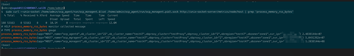

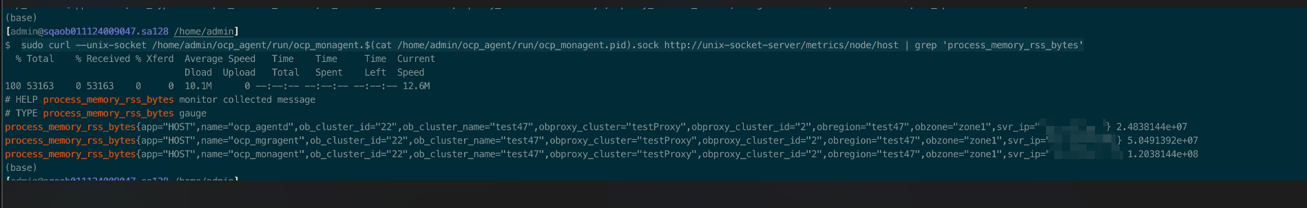

sudo curl --unix-socket /home/admin/ocp_agent/run/ocp_monagent.$(cat /home/admin/ocp_agent/run/ocp_monagent.pid).sock http://unix-socket-server/metrics/node/host | grep ‘process_memory_rss_bytes’
