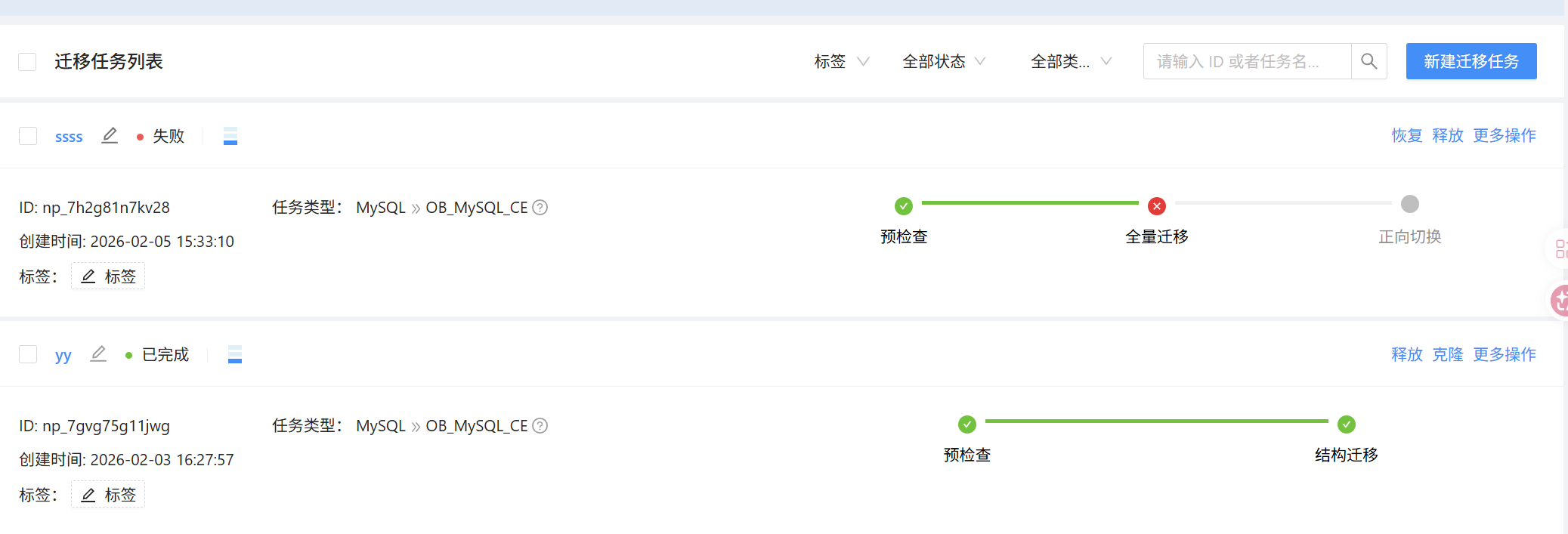

oms社区版迁移数据时报错CM response not success
【 使用环境 】测试环境 mysql5.7 >> ob社区版4.5.0
【 OB or 其他组件 】 oms
【 使用版本 】4.2.11_ce
【问题描述】测试迁移三个表, 只迁移数据结构时没问题, 新建了一个任务全量迁移时报错如下

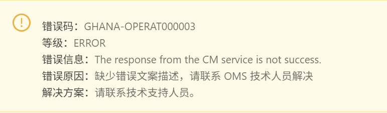

[root@host0001 Ghana]# tail -f common-error.log
at java.lang.Thread.run(Thread.java:853)
Caused by: com.oceanbase.oms.cm.client.exception.CmServerException: CM response not success.
|- No enough machine resource for Full-Import task, reason current memory usage 0.86039627 exceed limited 0.8.
at com.oceanbase.oms.cm.client.exception.CmServerException.onFailed(CmServerException.java:50)
at com.oceanbase.oms.cm.client.common.CmBaseResponse.update(CmBaseResponse.java:77)
at com.oceanbase.oms.cm.client.model.connectorv2.CreateConnectorTaskV2Response.update(CreateConnectorTaskV2Response.java:26)
at com.oceanbase.oms.cm.client.common.AbstractCmResponse.setContent(AbstractCmResponse.java:38)
at com.oceanbase.oms.cm.client.common.DefaultCmClient.request(DefaultCmClient.java:92)
at com.alipay.oms.v3.service.impl.component.connector.ConnectorManageServiceImpl.createConnectorTask(ConnectorManageServiceImpl.java:70)
… 183 common frames omitted
2026-02-05 15:41:14.538 [http-nio-8090-exec-4] ERROR c.a.o.s.i.o.OmsStepServiceImpl 365 - [c5e84b64-a426-4c62-8ab2-1c826a772313] Failed to resume step. stepId: s_7h2g81titmip, projectId: np_7h2g81n7kv28
com.alipay.oms.dto.nexception.AccessCmException: The response from the CM service is not success.: CM response not success.
|- No enough machine resource for Full-Import task, reason current memory usage 0.86008227 exceed limited 0.8.
这个是内存占用超出80%的限制了,释放内存再重试一下
