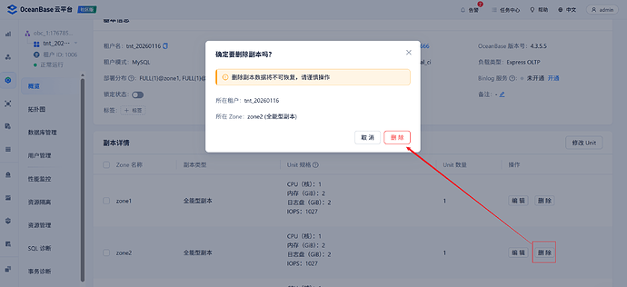

ocp社区版 删除租户副本 任务一直Wait alter locality 一直是执行中
【 OB or 其他组件 】OB
【 使用版本 】v4.4.0

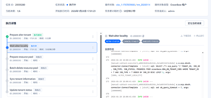

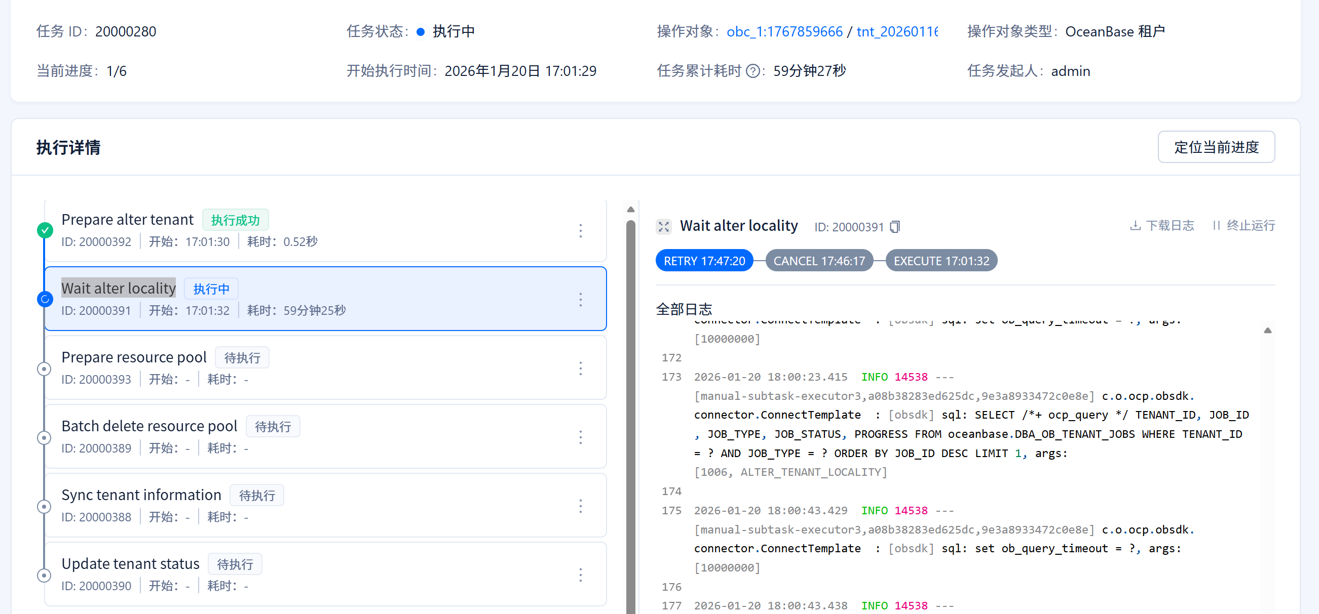

【问题描述】ocp社区版 删除租户副本 任务 Wait alter locality 一直是执行中,等了有一个小时了,查询任务表进度是0,不知道卡在哪里了?
obclient(root@sys)[oceanbase]> SELECT TENANT_ID, JOB_ID, JOB_TYPE, JOB_STATUS, PROGRESS FROM oceanbase.DBA_OB_TENANT_JOBS WHERE JOB_TYPE = 'ALTER_TENANT_LOCALITY';
| TENANT_ID | JOB_ID | JOB_TYPE              | JOB_STATUS | PROGRESS |
|      1006 |      3 | ALTER_TENANT_LOCALITY | INPROGRESS |        0 |
1 row in set (0.010 sec)

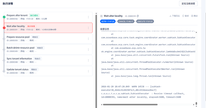

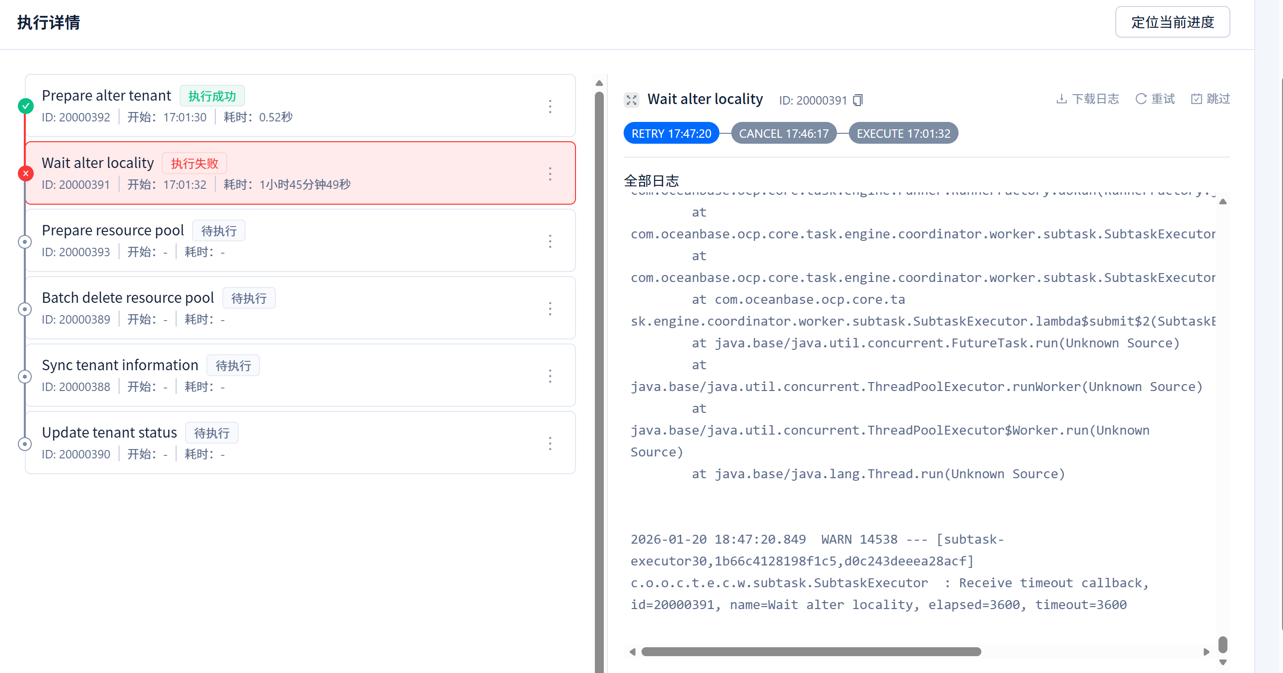

删除任务执行失败
2026-01-20 18:47:20.863 WARN 14538 — [manual-subtask-executor3,a08b38283ed625dc,9e3a8933472c0e8e] c.o.o.c.l.pattern.InterruptibleRetryer : Current thread is interrupted.
2026-01-20 18:47:20.882 ERROR 14538 — [manual-subtask-executor3,a08b38283ed625dc,9e3a8933472c0e8e] c.o.ocp.core.util.ExceptionUtils : Checked Exception: com.oceanbase.ocp.core.exception.UnexpectedException occurred with code error.ob.tenant.alter.locality.not.finished, and args [tnt_20260116]
2026-01-20 18:47:20.898 ERROR 14538 — [manual-subtask-executor3,a08b38283ed625dc,9e3a8933472c0e8e] c.o.o.c.t.e.c.w.subtask.SubtaskExecutor : The locality modification of the tnt_20260116 tenant is not completed.
com.oceanbase.ocp.core.exception.UnexpectedException: [OCP UnexpectedException]: status=500 INTERNAL_SERVER_ERROR, errorCode=OB_TENANT_ALTER_LOCALITY_NOT_FINISHED, args=tnt_20260116
at java.base/jdk.internal.reflect.NativeConstructorAccessorImpl.newInstance0(Native Method)
at java.base/jdk.internal.reflect.NativeConstructorAccessorImpl.newInstance(Unknown Source)
at java.base/jdk.internal.reflect.DelegatingConstructorAccessorImpl.newInstance(Unknown Source)
at java.base/java.lang.reflect.Constructor.newInstanceWithCaller(Unknown Source)
at java.base/java.lang.reflect.Constructor.newInstance(Unknown Source)
at com.oceanbase.ocp.core.util.ExceptionUtils.newException(ExceptionUtils.java:96)
at com.oceanbase.ocp.core.util.ExceptionUtils.throwException(ExceptionUtils.java:90)
at com.oceanbase.ocp.core.util.ExceptionUtils.unExpected(ExceptionUtils.java:77)
at com.oceanbase.ocp.obops.internal.tenant.task.WaitAlterLocalityTask.checkAlterProgress(WaitAlterLocalityTask.java:40)
at com.oceanbase.ocp.obops.internal.tenant.task.AbstractWaitAlterTenantTask.run(AbstractWaitAlterTenantTask.java:46)
at com.oceanbase.ocp.core.task.runtime.Subtask.retry(Subtask.java:49)
at com.oceanbase.ocp.core.task.engine.runner.JavaSubtaskRunner.retry(JavaSubtaskRunner.java:76)
at com.oceanbase.ocp.core.task.engine.runner.JavaSubtaskRunner.doRun(JavaSubtaskRunner.java:35)
at com.oceanbase.ocp.core.task.engine.runner.JavaSubtaskRunner.run(JavaSubtaskRunner.java:26)
at com.oceanbase.ocp.core.task.engine.runner.RunnerFactory.doRun(RunnerFactory.java:76)
at com.oceanbase.ocp.core.task.engine.coordinator.worker.subtask.SubtaskExecutor.doRun(SubtaskExecutor.java:212)
at com.oceanbase.ocp.core.task.engine.coordinator.worker.subtask.SubtaskExecutor.redirectConsoleOutput(SubtaskExecutor.java:206)
sk.engine.coordinator.worker.subtask.SubtaskExecutor.lambda$submit$2(SubtaskExecutor.java:137)
at java.base/java.util.concurrent.FutureTask.run(Unknown Source)
at java.base/java.util.concurrent.ThreadPoolExecutor.runWorker(Unknown Source)
at java.base/java.util.concurrent.ThreadPoolExecutor$Worker.run(Unknown Source)
at java.base/java.lang.Thread.run(Unknown Source)
2026-01-20 18:47:20.849 WARN 14538 — [subtask-executor30,1b66c4128198f1c5,d0c243deeea28acf] c.o.o.c.t.e.c.w.subtask.SubtaskExecutor : Receive timeout callback, id=20000391, name=Wait alter locality, elapsed=3600, timeout=3600
