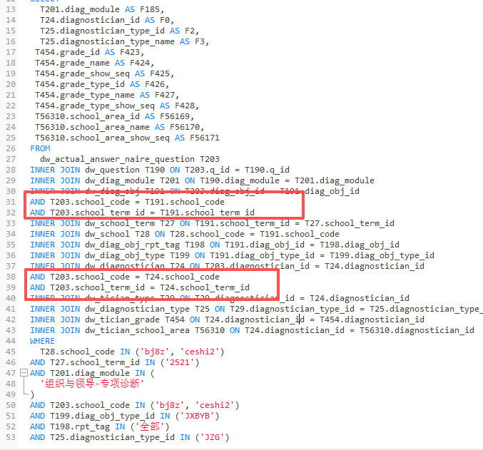

【问题描述】执行sql报错:
4020 No join order generated
sql内容如下:
SELECT
	T201.diag_module AS F185,
	T24.diagnostician_id AS F0,
	T25.diagnostician_type_id AS F2,
	T25.diagnostician_type_name AS F3,
 T454.grade_id AS F423,
 T454.grade_name AS F424,
 T454.grade_show_seq AS F425,
 T454.grade_type_id AS F426,
 T454.grade_type_name AS F427,
 T454.grade_type_show_seq AS F428,
 T56310.school_area_id AS F56169,
 T56310.school_area_name AS F56170,
 T56310.school_area_show_seq AS F56171
FROM
	dw_actual_answer_naire_question T203
INNER JOIN dw_question T190 ON T203.q_id = T190.q_id
INNER JOIN dw_diag_module T201 ON T190.diag_module = T201.diag_module
INNER JOIN dw_diag_obj T191 ON T203.diag_obj_id = T191.diag_obj_id
AND T203.school_code = T191.school_code
AND T203.school_term_id = T191.school_term_id
INNER JOIN dw_school_term T27 ON T191.school_term_id = T27.school_term_id
INNER JOIN dw_school T28 ON T28.school_code = T191.school_code
INNER JOIN dw_diag_obj_rpt_tag T198 ON T191.diag_obj_id = T198.diag_obj_id
INNER JOIN dw_diag_obj_type T199 ON T191.diag_obj_type_id = T199.diag_obj_type_id
INNER JOIN dw_diagnostician T24 ON T203.diagnostician_id = T24.diagnostician_id
AND T203.school_code = T24.school_code
AND T203.school_term_id = T24.school_term_id
INNER JOIN dw_tician_type T29 ON T29.diagnostician_id = T24.diagnostician_id
INNER JOIN dw_diagnostician_type T25 ON T29.diagnostician_type_id = T25.diagnostician_type_id
INNER JOIN dw_tician_grade T454 ON T24.diagnostician_id = T454.diagnostician_id
INNER JOIN dw_tician_school_area T56310 ON T24.diagnostician_id = T56310.diagnostician_id
WHERE
	T28.school_code IN ('bj8z', 'ceshi2')
AND T27.school_term_id IN ('2521')
AND T201.diag_module IN (
	'组织与领导-专项诊断'
AND T203.school_code IN ('bj8z', 'ceshi2')
AND T199.diag_obj_type_id IN ('JXBYB')
AND T198.rpt_tag IN ('全部')
AND T25.diagnostician_type_id IN ('JZG')
在mysql数据库中执行没有问题,但在oceanbase中报这个错误了

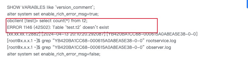

a. 登录系统租户,打开enable_rich_error_msg 参数
b. 登录业务租户,执行报错 SQL 语句,会直接返回执行节点 IP 和 trace_id 信息。
c. 去 xx.xx.xx.1 节点过滤日志,如果最新日志无法过滤到,可以正则匹配多个日志进行过滤
d. 获取完日志信息后,关闭enable_rich_error_msg参数
您好,显示是空的
遍历的所有observer.的日志,还都是空的。是按照步骤执行的
麻烦仔细看我的发的信息 这一步要执行你那个报错的语句 我这是个举例 你用我这个trace_id 肯定搜不到的
select 后加上 /*+ NO_REWRITE */ 禁止 SQL 改写 ,执行不报错
还是要搜集一下 日志信息的 表结构也提供一下 explain extended执行计划也提供一下 要不然不确定什么问题导致的

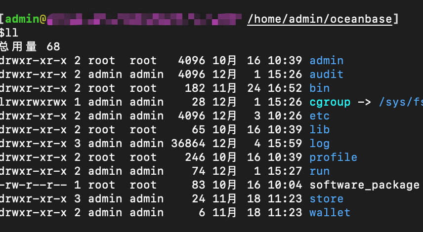

这个在哪个目录下呢,在oceanbase/log目录下没有生成文件
我们测试发现在navicate中去掉这两个条件可以正常执行
你用find查找一下 看看这个文件在哪个目录下 一般情况下 就在这个在 OBServer 节点日志目录下

改写会把部分连接条件消掉变成笛卡尔积,触发了后续 join order 枚举的 bug。可以先加 no_rewrite 规避
