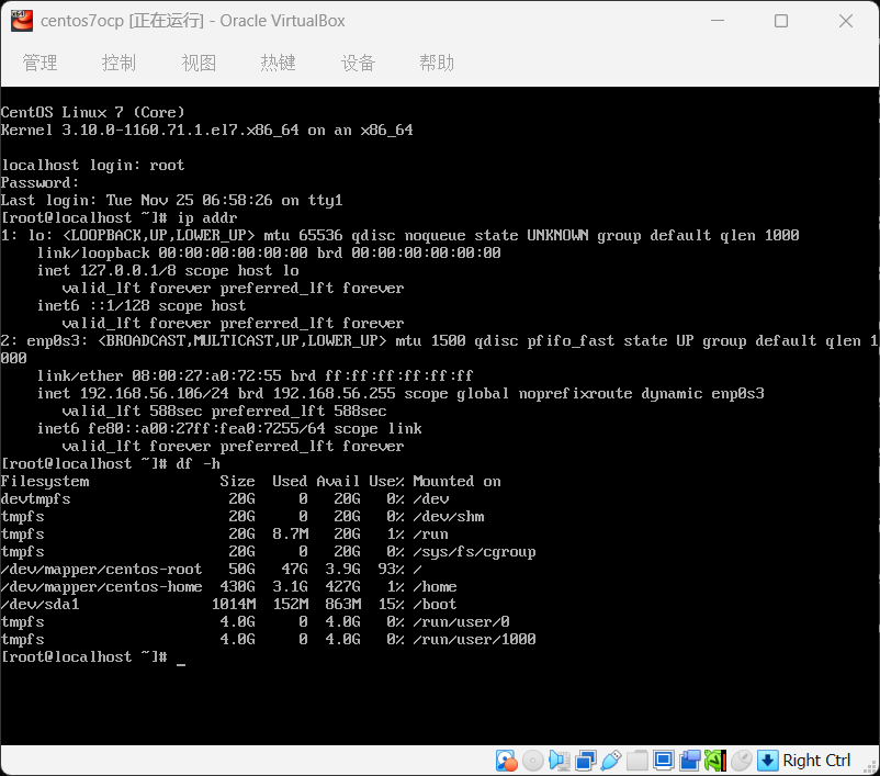

/home目录有400多G,还是报LOG_DISK不够?
Create tenant ocp_meta x
[ERROR] OBD-5000: create resource pool ocp_meta_pool unit=‘ocp_meta_unit’, unit_num=1, zone_list=(‘zone1’) execute failed
[ERROR] (4733, ‘zone ‘zone1’ resource not enough to hold 1 unit. You can check resource info by views: DBA_OB_UNITS, GV$OB_UNITS, GV$OB_SERVERS.\nserver ‘“192.168.56.106:2882”’ LOG_DISK resource not enough\n’)
可是我截图中/home目录有400多G,咋会不够呢?/data/1和/data/logs这两个目录是不是挂载在/根目录下?

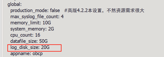

是的,确实挂在根目录下,你可以通过如下路径修改/home/admin/.obd/cluster/xxx/config.yaml xxx代表集群名称 或者使用obd cluster edit-config xxx
配置文件的这个参数看下:
