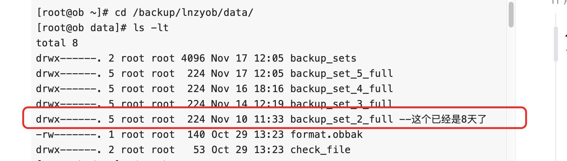

【问题描述】做了多次手动的ob租户全量备份,和7天的自动备份删除策略,有历史清理job记录,但发现备份并没有被删除?为何?目前已经存放了5个全量备份,导致空间紧张。
[root@ob ~]# cd /backup/lnzyob/data/
[root@ob data]# ls -lt
total 8
drwx------. 2 root root 4096 Nov 17 12:05 backup_sets
drwx------. 5 root root  224 Nov 17 12:05 backup_set_5_full
drwx------. 5 root root  224 Nov 16 18:16 backup_set_4_full
drwx------. 5 root root  224 Nov 14 12:19 backup_set_3_full
drwx------. 5 root root  224 Nov 10 11:33 backup_set_2_full --这个已经是8天了
-rw-------. 1 root root  140 Oct 29 13:23 format.obbak
drwx------. 2 root root   53 Oct 29 13:23 check_file
[root@ob data]# du -sh *
185G    backup_set_2_full  --备份文件还在
185G    backup_set_3_full
185G    backup_set_4_full
185G    backup_set_5_full
36K     backup_sets
4.0K    check_file
4.0K    format.obbak
[root@ob data]# date
Tue Nov 18 09:17:38 CST 2025

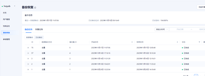

obclient(root@sys)[oceanbase]> SELECT * FROM oceanbase.CDB_OB_BACKUP_TASK_HISTORY\G
               TENANT_ID: 1002
                 TASK_ID: 1
                  JOB_ID: 1
             INCARNATION: 1
           BACKUP_SET_ID: 1
         START_TIMESTAMP: 2025-10-29 13:23:54.969878
           END_TIMESTAMP: 2025-10-29 14:18:49.743895
                  STATUS: COMPLETED
               START_SCN: 1761715452030565000
                 END_SCN: 1761718720023072000
       USER_LS_START_SCN: 1761715462002868000
         ENCRYPTION_MODE: NONE
                  PASSWD:
             INPUT_BYTES: 284822823607
            OUTPUT_BYTES: 233298275234
       OUTPUT_RATE_BYTES: 70808581.7207
        EXTRA_META_BYTES: 0
            TABLET_COUNT: 6152
     FINISH_TABLET_COUNT: 6152
       MACRO_BLOCK_COUNT: 135797
FINISH_MACRO_BLOCK_COUNT: 135797
              FILE_COUNT: 0
            META_TURN_ID: 1
            DATA_TURN_ID: 0
                  RESULT: 0
                 COMMENT:
                    PATH: file:///backup/lnzyob/data
           MINOR_TURN_ID: 1
           MAJOR_TURN_ID: 1
               TENANT_ID: 1002
                 TASK_ID: 2
                  JOB_ID: 2
             INCARNATION: 1
           BACKUP_SET_ID: 2
         START_TIMESTAMP: 2025-11-10 10:42:01.799105
           END_TIMESTAMP: 2025-11-10 11:33:21.944992
                  STATUS: COMPLETED
               START_SCN: 1762742531611400000
                 END_SCN: 1762745592455625000
       USER_LS_START_SCN: 1762742541122915000
                  PASSWD:
             INPUT_BYTES: 234361965305
            OUTPUT_BYTES: 197171565127
       OUTPUT_RATE_BYTES: 64013709.8568
        EXTRA_META_BYTES: 0
            TABLET_COUNT: 6152
       MACRO_BLOCK_COUNT: 111740
FINISH_MACRO_BLOCK_COUNT: 111740
              FILE_COUNT: 0
            META_TURN_ID: 1
            DATA_TURN_ID: 0
                  RESULT: 0
                 COMMENT:
           MINOR_TURN_ID: 1
           MAJOR_TURN_ID: 1
*************************** 3. row ***************************
               TENANT_ID: 1002
                 TASK_ID: 3
                  JOB_ID: 3
             INCARNATION: 1
           BACKUP_SET_ID: 3
         START_TIMESTAMP: 2025-11-14 11:31:39.747239
           END_TIMESTAMP: 2025-11-14 12:19:21.404765
                  STATUS: COMPLETED
               START_SCN: 1763091121723413000
                 END_SCN: 1763093951741047000
       USER_LS_START_SCN: 1763091134999439000
                  PASSWD:
             INPUT_BYTES: 234403908819
            OUTPUT_BYTES: 197172193003
       OUTPUT_RATE_BYTES: 68901394.1087
        EXTRA_META_BYTES: 0
            TABLET_COUNT: 6152
       MACRO_BLOCK_COUNT: 111760
FINISH_MACRO_BLOCK_COUNT: 111760
              FILE_COUNT: 0
            META_TURN_ID: 1
            DATA_TURN_ID: 0
                  RESULT: 0
                 COMMENT:
           MINOR_TURN_ID: 1
           MAJOR_TURN_ID: 1
*************************** 4. row ***************************
               TENANT_ID: 1002
                 TASK_ID: 4
                  JOB_ID: 57
             INCARNATION: 1
           BACKUP_SET_ID: 4
         START_TIMESTAMP: 2025-11-16 17:16:16.700891
           END_TIMESTAMP: 2025-11-16 18:16:34.651781
                  STATUS: COMPLETED
               START_SCN: 1763284590034814000
                 END_SCN: 1763288184614041000
       USER_LS_START_SCN: 1763284603157180000
                  PASSWD:
             INPUT_BYTES: 234420683884
            OUTPUT_BYTES: 197173651692
       OUTPUT_RATE_BYTES: 54498708.7130
        EXTRA_META_BYTES: 0
            TABLET_COUNT: 6152
       MACRO_BLOCK_COUNT: 111768
FINISH_MACRO_BLOCK_COUNT: 111768
              FILE_COUNT: 0
            META_TURN_ID: 1
            DATA_TURN_ID: 0
                  RESULT: 0
                 COMMENT:
           MINOR_TURN_ID: 1
           MAJOR_TURN_ID: 1
*************************** 5. row ***************************
               TENANT_ID: 1002
                 TASK_ID: 5
                  JOB_ID: 75
             INCARNATION: 1
           BACKUP_SET_ID: 5
         START_TIMESTAMP: 2025-11-17 11:07:06.511714
           END_TIMESTAMP: 2025-11-17 12:05:48.653540
                  STATUS: COMPLETED
               START_SCN: 1763348837043040000
                 END_SCN: 1763352338850327000
       USER_LS_START_SCN: 1763348849349840000
                  PASSWD:
             INPUT_BYTES: 234460533921
            OUTPUT_BYTES: 197172153550
       OUTPUT_RATE_BYTES: 55980753.5558
        EXTRA_META_BYTES: 0
            TABLET_COUNT: 6152
       MACRO_BLOCK_COUNT: 111787
FINISH_MACRO_BLOCK_COUNT: 111787
              FILE_COUNT: 0
            META_TURN_ID: 1
            DATA_TURN_ID: 0
                  RESULT: 0
                 COMMENT:
           MINOR_TURN_ID: 1
           MAJOR_TURN_ID: 1
5 rows in set (0.184 sec)
obclient(root@sys)[oceanbase]> select BACKUP_SET_ID,START_TIMESTAMP,END_TIMESTAMP,STATUS,PATH FROM oceanbase.CDB_OB_BACKUP_SET_FILES;
| BACKUP_SET_ID | START_TIMESTAMP            | END_TIMESTAMP              | STATUS  | PATH                       |
|             1 | 2025-10-29 13:23:54.969878 | 2025-10-29 14:18:49.743895 | SUCCESS | file:///backup/lnzyob/data |
|             2 | 2025-11-10 10:42:01.799105 | 2025-11-10 11:33:21.944992 | SUCCESS | file:///backup/lnzyob/data |
|             3 | 2025-11-14 11:31:39.747239 | 2025-11-14 12:19:21.404765 | SUCCESS | file:///backup/lnzyob/data |
|             4 | 2025-11-16 17:16:16.700891 | 2025-11-16 18:16:34.651781 | SUCCESS | file:///backup/lnzyob/data |
|             5 | 2025-11-17 11:07:06.511714 | 2025-11-17 12:05:48.653540 | SUCCESS | file:///backup/lnzyob/data |
5 rows in set (0.092 sec)

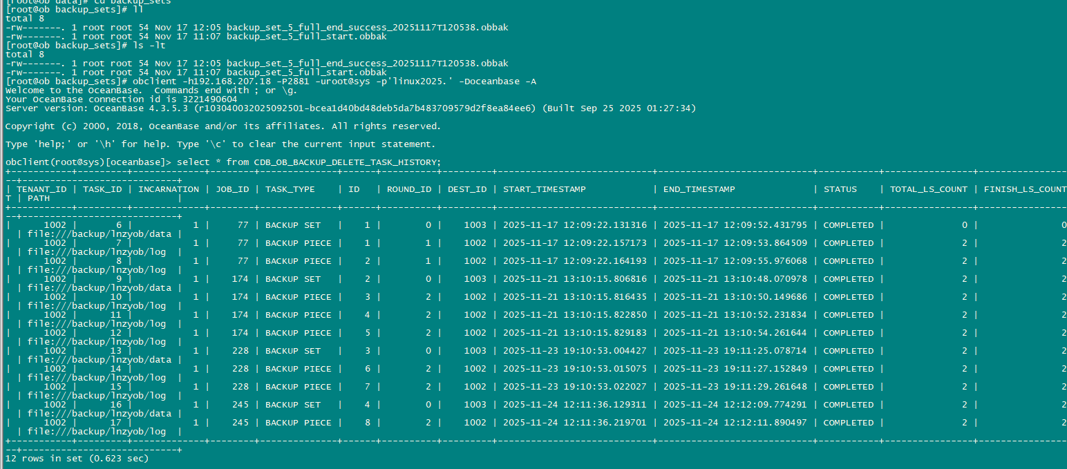

obclient(root@sys)[oceanbase]> select * from CDB_OB_BACKUP_DELETE_TASK_HISTORY;
| TENANT_ID | TASK_ID | INCARNATION | JOB_ID | TASK_TYPE    | ID   | ROUND_ID | DEST_ID | START_TIMESTAMP            | END_TIMESTAMP              | STATUS    | TOTAL_LS_COUNT | FINISH_LS_COUNT | RESULT | COMMENT | PATH                       |
|      1002 |       6 |           1 |     77 | BACKUP SET   |    1 |        0 |    1003 | 2025-11-17 12:09:22.131316 | 2025-11-17 12:09:52.431795 | COMPLETED |              0 |               0 |      0 |         | file:///backup/lnzyob/data |
|      1002 |       7 |           1 |     77 | BACKUP PIECE |    1 |        1 |    1002 | 2025-11-17 12:09:22.157173 | 2025-11-17 12:09:53.864509 | COMPLETED |              2 |               2 |      0 |         | file:///backup/lnzyob/log  |
|      1002 |       8 |           1 |     77 | BACKUP PIECE |    2 |        1 |    1002 | 2025-11-17 12:09:22.164193 | 2025-11-17 12:09:55.976068 | COMPLETED |              2 |               2 |      0 |         | file:///backup/lnzyob/log  |
3 rows in set (0.016 sec)

已参考的文档,不起作用:自动清理过期备份
https://www.oceanbase.com/docs/common-oceanbase-database-standalone-1000000003577572
@淇铭
赞赞赞
RECOVERY_WINDOW是7天,最早的备份文件是11.10号的,这是正常的
您觉得哪天才会删掉?
RECOVERY_WINDOW是7天的含义是说 需要保证最近7天的数据可恢复,如果要恢复11.12号的数据 是否得用 11.10号的这个全备份?
