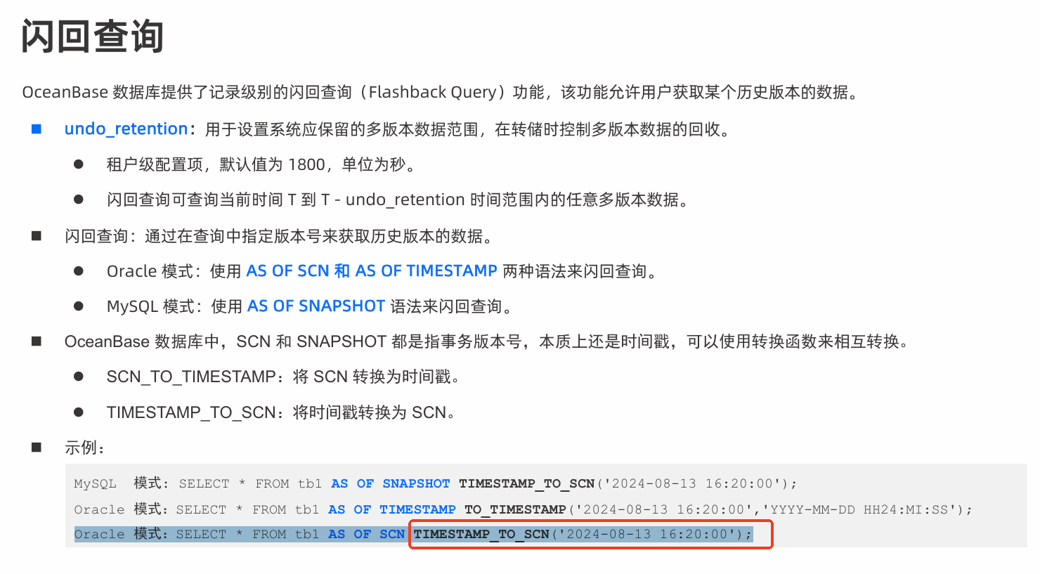

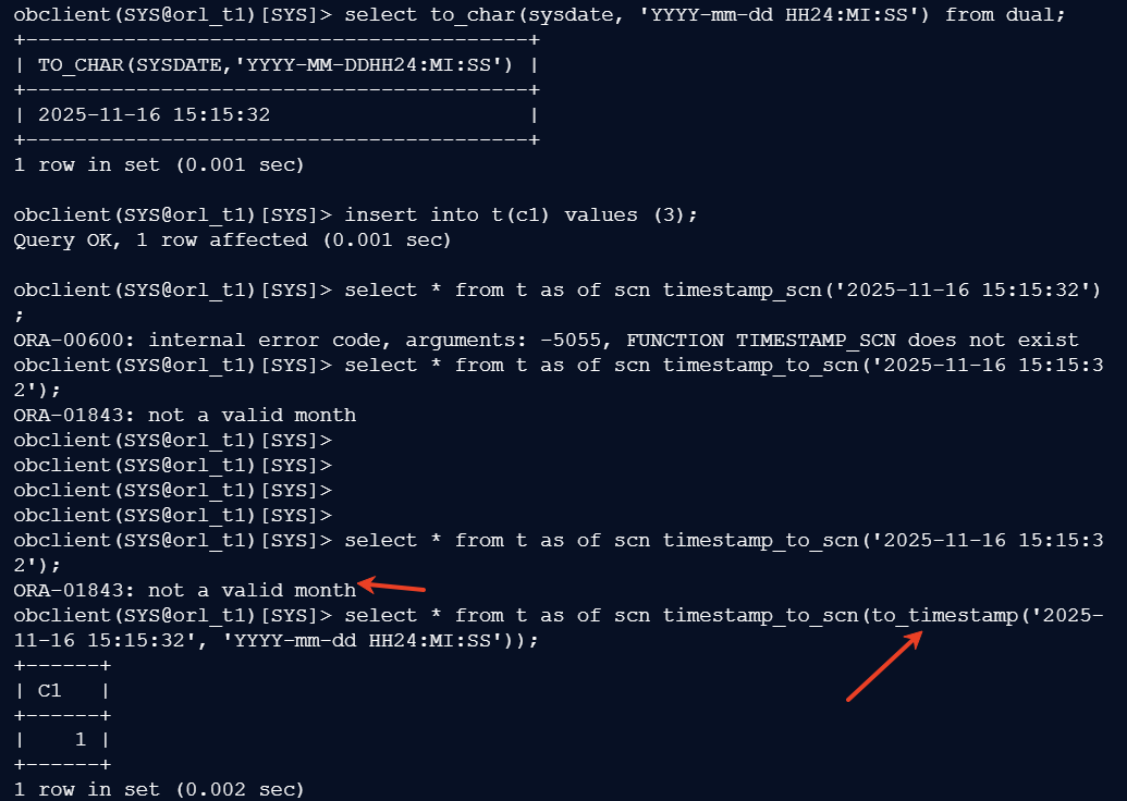

OBCP教材中的AS OF SCN闪回查询语句有错误,需要先使用to_timestamp进行转换才行
是不是nls_format设置和sql里的不一致
会话日期格式调整下试试
SET SESSION nls_date_format='YYYY-MM-DD HH24:MI:SS';
SET SESSION nls_timestamp_format='YYYY-MM-DD HH24:MI:SS.FF';
SET SESSION nls_timestamp_tz_format='YYYY-MM-DD HH24:MI:SS.FF';
-- 分别做闪回查询(两种语法均可)
select * from t1 as of timestamp to_timestamp('2025-05-07 13:35:09','YYYY-MM-DD HH24:MI:SS');
select * from t1 as of scn timestamp_to_scn('2025-05-07 13:35:09');
