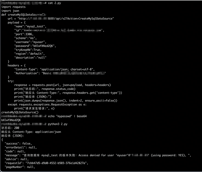

调用创建数据源接口报错如下:
  "success": false,
  "errorDetail": null,
  "code": null,
  "message": "查询数据库 mysql_test 的版本失败:Access denied for user 'myuser'@'192.168.1.100' (using password: YES)。",
  "advice": null,
  "requestId": "406274d4-7351-46fb-93b4-74aa65faf77f",
  "pageNumber": null,
  "pageSize": null,
  "totalCount": null,
  "cost": null,
  "data": null
操作接口代码如下:
def createMySQLDataSource():
    url = "http://192.168.1.100:8089/api/v2?Action=CreateMySqlDataSource"
    payload = {
        "name":"mysql_test",
        "ip":"192.168.1.101",
        "port":3306,
        "schema":"ms",
        "username":"myuser",
        "password":"mypasswd",
        "tryKeepHb":True,
        "region":"default",
        "description":"null"
    headers = {
        "Content-Type": "application/json; charset=utf-8",
        "Authorization": "Basic SGVsbG8sIFdvcmxkIQo="
    try:
        response = requests.post(url, json=payload, headers=headers)
        print("状态码:", response.status_code)
        print("响应头 Content-Type:", response.headers.get('content-type'))
        print("响应体 (JSON):")
        print(json.dumps(response.json(), indent=2, ensure_ascii=False))
    except requests.exceptions.RequestException as e:
        print("请求发生错误:", e)

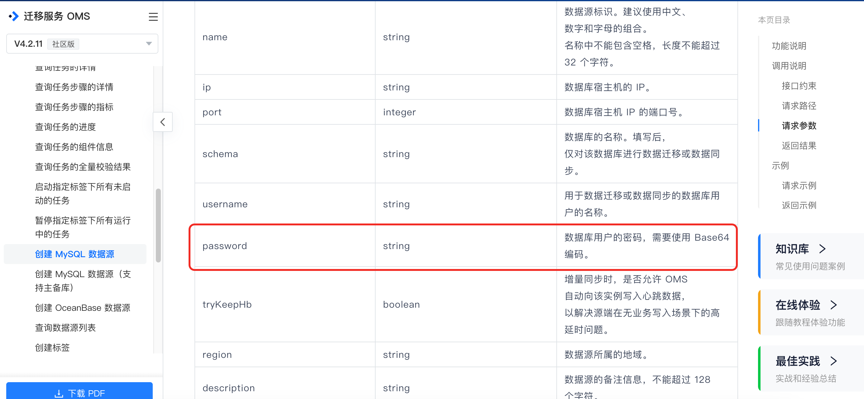

mysql密码是base64编码的吗
是的,试过base64也不行
mysql的err日志中有连接拒绝的记录吗
没事了,是base64的编码有问题,已经处理好了
