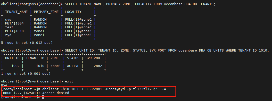

【问题描述】新建了一个租户,无法登录,错误:ERROR 1227 (42501): Access denied
1.创建资源单元:
CREATE RESOURCE UNIT new_zyd MAX_CPU 2, MEMORY_SIZE = ‘2G’, MAX_IOPS 10240, MIN_IOPS=10240;
2. 创建数据池
CREATE RESOURCE POOL new_zyd unit = ‘zyd’,unit_num = 1, zone_list = (‘zone1’);
3.创建租户
CREATE TENANT zyd CHARSET = ‘utf8mb4’ , RESOURCE_POOL_LIST = (‘new_zyd’) SET ob_compatibility_mode = ‘mysql’;
然后我exit推出sys系统租户后,执行
无法进入,哪里出问题了,安装的时候提示建的租户test,可以成功进入; 请各位大佬帮忙看看!!! 感谢

1.没有指定用户名密码
2.CREATE TENANT zyd CHARSET = ‘utf8mb4’ , RESOURCE_POOL_LIST = (‘new_zyd’) SET ob_compatibility_mode = ‘mysql’;
3.obclient -h10.10.6.150 -P2881 -uroot@zyd -p’tl123tl123!’ -A
4.(1)CREATE RESOURCE UNIT zyd MAX_CPU 2, MEMORY_SIZE = ‘2G’ , MAX_IOPS 10240, MIN_IOPS=10240;
(2)CREATE RESOURCE UNIT zyd MAX_CPU 2, MEMORY_SIZE = ‘2G’ , MAX_IOPS 10240, MIN_IOPS=10240;
5.4.2.5.6
默认只能本地登录。IP换成用127.0.1试试
建租户加上这个参数。
set ob_tcp_invited_nodes=’%’;
