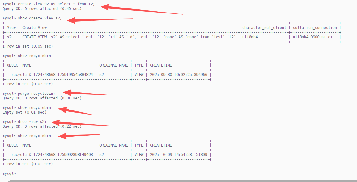

【问题描述】删除view后为什么能在回收站看到?看文档应该不在才对
https://www.oceanbase.com/docs/common-oceanbase-database-cn-1000000003977754
1、开启回收站
2、创建视图
mysql> create view s2 as select * from t2;
Query OK, 0 rows affected (0.30 sec)
3、删除视图
mysql> drop view s2;
Query OK, 0 rows affected (0.29 sec)
4、查看回收站
5、恢复/删除回收对象都报语法错误

记得回收站只支持表和库的删除,不支持视图和索引的删除。
嗯。看文档说view不应该进回收站,为什么能看到呢?
确实不应该看到VIEW,得具体看一下日志,或用工具诊断一下了。

看上去把view当做table放到了回收站
-- 删除view
obclient [test]> drop view v_t1;
Query OK, 0 rows affected (0.069 sec)
-- 进入了回收站,TYPE是VIEW
obclient [test]> show recyclebin;
| OBJECT_NAME                             | ORIGINAL_NAME | TYPE  | CREATETIME                 |
| __recycle_$_1757569992_1760079409863928 | t1            | TABLE | 2025-10-10 14:56:49.880738 |
| __recycle_$_1757569992_1760079418566256 | v_t1          | VIEW  | 2025-10-10 14:56:58.565607 |
2 rows in set (0.004 sec)
-- 用flashback view语法恢复,报错语法不支持
obclient [test]> flashback view v_t1 to before drop;
ERROR 1064 (42000): You have an error in your SQL syntax; check the manual that corresponds to your OceanBase version for the right syntax to use near 'view v_t1 to before drop' at line 1
-- 用flashback table闪回VIEW,正常成功
obclient [test]> flashback table v_t1 to before drop;
Query OK, 0 rows affected (0.071 sec)
-- 查询视图,报错,因为依赖的表之前drop了
obclient [test]> select * from v_t1;
ERROR 1356 (42S22): View 'test.v_t1' references invalid table(s) or column(s) or function(s) or definer/invoker of view lack rights to use them
-- 闪回表
obclient [test]> flashback table t1  to before drop;
Query OK, 0 rows affected (0.075 sec)
-- 再查询视图,正常可用
| id   | name |
|    1 | A    |
|    2 | B    |
|    3 | C    |
3 rows in set (0.163 sec)
代码层view会被纳入回收站,可以用户表恢复方法进行恢复
