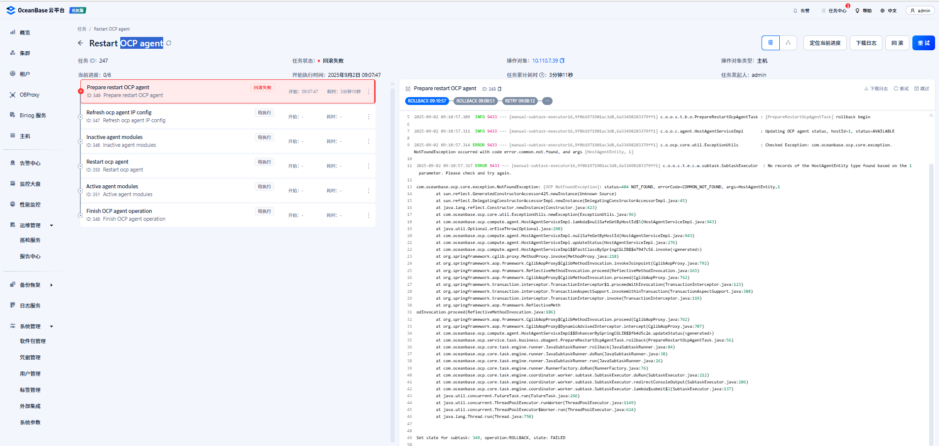

使用 ocp-all-in-one-4.3.6-20250815135607.el7.x86_64.tar.gz 社区版本部署 OCP的时候,部署 meta 所在服务器,报 OCP agent 错误。
全部日志
2025-09-02 09:10:57.303 INFO 9433 — [manual-subtask-executor16,9f0b1971901ac3d8,6a33498283379ff1] c.o.ocp.service.iam.user.UserService : user 100 login with organization 10000000
2025-09-02 09:10:57.307 WARN 9433 — [manual-subtask-executor16,9f0b1971901ac3d8,6a33498283379ff1] c.o.o.c.t.e.runner.JavaSubtaskRunner : Rollback subtask, id=349, context=Context{parallelIdx=-1, stringMap={task_instance_id=247, task_operation=rollback, latest_execution_start_time=2025-09-02T09:10:57.289+08:00, sub_task_instance_name=Prepare restart OCP agent, sub_task_instance_id=349, host_id=1}, listMap={}}, operation=ROLLBACK, executor=10.110.7.39
2025-09-02 09:10:57.309 INFO 9433 — [manual-subtask-executor16,9f0b1971901ac3d8,6a33498283379ff1] c.o.o.s.t.b.o.PrepareRestartOcpAgentTask : [PrepareRestartOcpAgentTask] rollback begin
2025-09-02 09:10:57.311 INFO 9433 — [manual-subtask-executor16,9f0b1971901ac3d8,6a33498283379ff1] c.o.o.c.agent.HostAgentServiceImpl : Updating OCP agent status, hostId=1, status=AVAILABLE
2025-09-02 09:10:57.314 ERROR 9433 — [manual-subtask-executor16,9f0b1971901ac3d8,6a33498283379ff1] c.o.ocp.core.util.ExceptionUtils : Checked Exception: com.oceanbase.ocp.core.exception.NotFoundException occurred with code error.common.not.found, and args [HostAgentEntity, 1]
2025-09-02 09:10:57.317 ERROR 9433 — [manual-subtask-executor16,9f0b1971901ac3d8,6a33498283379ff1] c.o.o.c.t.e.c.w.subtask.SubtaskExecutor : No records of the HostAgentEntity type found based on the 1 parameter. Please check and try again.
com.oceanbase.ocp.core.exception.NotFoundException: [OCP NotFoundException]: status=404 NOT_FOUND, errorCode=COMMON_NOT_FOUND, args=HostAgentEntity,1
at sun.reflect.GeneratedConstructorAccessor425.newInstance(Unknown Source)
at sun.reflect.DelegatingConstructorAccessorImpl.newInstance(DelegatingConstructorAccessorImpl.java:45)
at java.lang.reflect.Constructor.newInstance(Constructor.java:423)
at com.oceanbase.ocp.core.util.ExceptionUtils.newException(ExceptionUtils.java:96)
at com.oceanbase.ocp.compute.agent.HostAgentServiceImpl.lambda$nullSafeGetByHostId$5(HostAgentServiceImpl.java:943)
at java.util.Optional.orElseThrow(Optional.java:290)
at com.oceanbase.ocp.compute.agent.HostAgentServiceImpl.nullSafeGetByHostId(HostAgentServiceImpl.java:943)
at com.oceanbase.ocp.compute.agent.HostAgentServiceImpl.updateStatus(HostAgentServiceImpl.java:276)
at com.oceanbase.ocp.compute.agent.HostAgentServiceImpl$$FastClassBySpringCGLIB$$e7947c56.invoke()
at org.springframework.cglib.proxy.MethodProxy.invoke(MethodProxy.java:218)
at org.springframework.aop.framework.CglibAopProxy$CglibMethodInvocation.invokeJoinpoint(CglibAopProxy.java:792)
at org.springframework.aop.framework.ReflectiveMethodInvocation.proceed(ReflectiveMethodInvocation.java:163)
at org.springframework.aop.framework.CglibAopProxy$CglibMethodInvocation.proceed(CglibAopProxy.java:762)
at org.springframework.transaction.interceptor.TransactionInterceptor$1.proceedWithInvocation(TransactionInterceptor.java:123)
at org.springframework.transaction.interceptor.TransactionAspectSupport.invokeWithinTransaction(TransactionAspectSupport.java:388)
at org.springframework.transaction.interceptor.TransactionInterceptor.invoke(TransactionInterceptor.java:119)
odInvocation.proceed(ReflectiveMethodInvocation.java:186)
at org.springframework.aop.framework.CglibAopProxy$DynamicAdvisedInterceptor.intercept(CglibAopProxy.java:707)
at com.oceanbase.ocp.compute.agent.HostAgentServiceImpl$$EnhancerBySpringCGLIB$$fb4d5c2e.updateStatus()
at com.oceanbase.ocp.service.task.business.obagent.PrepareRestartOcpAgentTask.rollback(PrepareRestartOcpAgentTask.java:56)
at com.oceanbase.ocp.core.task.engine.runner.JavaSubtaskRunner.rollback(JavaSubtaskRunner.java:84)
at com.oceanbase.ocp.core.task.engine.runner.JavaSubtaskRunner.doRun(JavaSubtaskRunner.java:38)
at com.oceanbase.ocp.core.task.engine.runner.JavaSubtaskRunner.run(JavaSubtaskRunner.java:26)
at com.oceanbase.ocp.core.task.engine.runner.RunnerFactory.doRun(RunnerFactory.java:76)
at com.oceanbase.ocp.core.task.engine.coordinator.worker.subtask.SubtaskExecutor.doRun(SubtaskExecutor.java:212)
at com.oceanbase.ocp.core.task.engine.coordinator.worker.subtask.SubtaskExecutor.redirectConsoleOutput(SubtaskExecutor.java:206)
at com.oceanbase.ocp.core.task.engine.coordinator.worker.subtask.SubtaskExecutor.lambda$submit$2(SubtaskExecutor.java:137)
at java.util.concurrent.FutureTask.run(FutureTask.java:266)
at java.util.concurrent.ThreadPoolExecutor.runWorker(ThreadPoolExecutor.java:1149)
at java.util.concurrent.ThreadPoolExecutor$Worker.run(ThreadPoolExecutor.java:624)
at java.lang.Thread.run(Thread.java:750)
Set state for subtask: 349, operation:ROLLBACK, state: FAILED

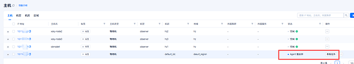

显示 Agent 一直处于重启中,能否进行重装。这台服务器是用来部署 OCP 的服务器。
