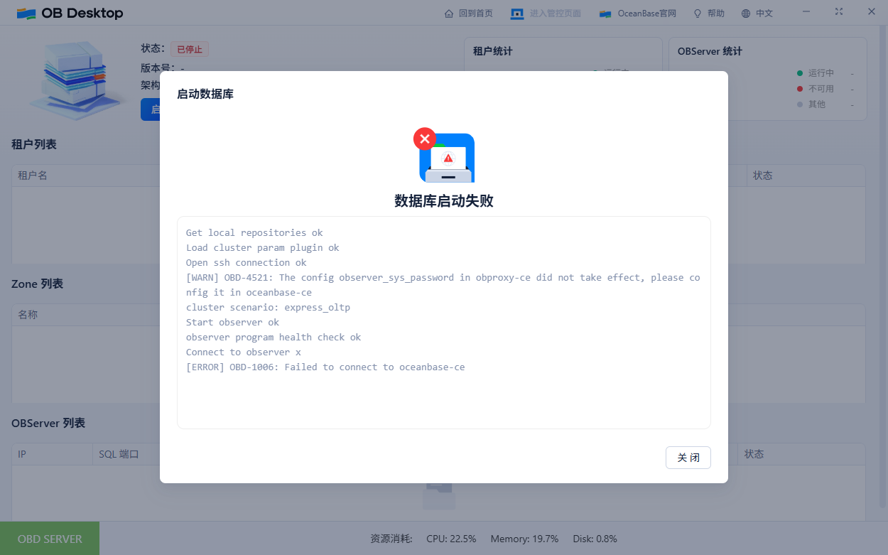

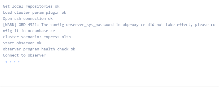

【问题描述】我使用数据库管理软件datagrip,执行命令 : 【ALTER USER ‘root’@’%’ IDENTIFIED BY ‘123456’;】第二天启动电脑点击启动 提示:【OBD-1006: Failed to connect to oceanbase-ce】
看着是不能连接了 只是修改了密码么?
是的 只修改了数据库密码

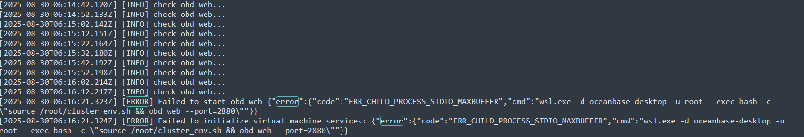

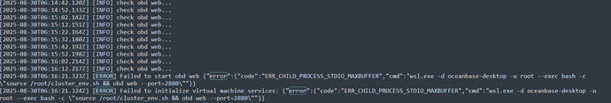

日志分两类 一类是这种:
[2025-08-30T06:15:12.151Z] [INFO] check obd web…
[2025-08-30T06:15:22.164Z] [INFO] check obd web…
[2025-08-30T06:15:32.180Z] [INFO] check obd web…
[2025-08-30T06:15:42.192Z] [INFO] check obd web…
[2025-08-30T06:15:52.198Z] [INFO] check obd web…
[2025-08-30T06:16:02.214Z] [INFO] check obd web…
[2025-08-30T06:16:12.217Z] [INFO] check obd web…
[2025-08-30T06:16:21.323Z] [ERROR] Failed to start obd web {“error”:{“code”:“ERR_CHILD_PROCESS_STDIO_MAXBUFFER”,“cmd”:"wsl.exe -d oceanbase-desktop -u root --exec bash -c “source /root/cluster_env.sh && obd web --port=2880"”}}
[2025-08-30T06:16:21.324Z] [ERROR] Failed to initialize virtual machine services: {“error”:{“code”:“ERR_CHILD_PROCESS_STDIO_MAXBUFFER”,“cmd”:"wsl.exe -d oceanbase-desktop -u root --exec bash -c “source /root/cluster_env.sh && obd web --port=2880"”}}

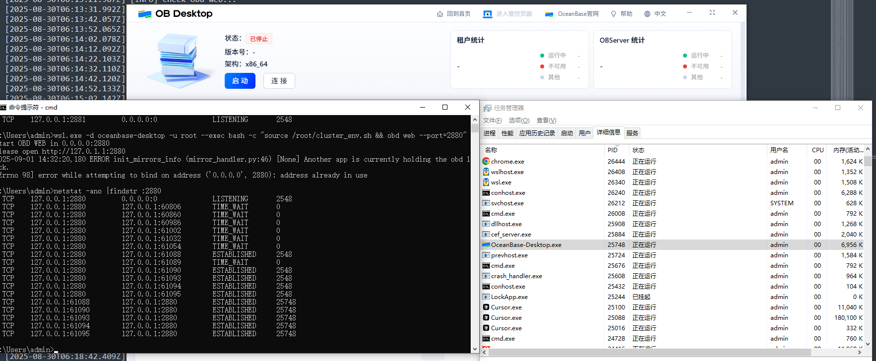

另一种是明确返回错误编码的:
2025-08-29T07:22:09.802Z] [INFO] check obd web…
[2025-08-29T07:22:19.817Z] [INFO] check obd web…
[2025-08-29T07:22:26.942Z] [INFO] oceanbase-desktop WSL distribution is running, stopping…
[2025-08-29T07:22:29.832Z] [INFO] check obd web…
[2025-08-29T07:23:43.687Z] [INFO] check obd web…
[2025-08-29T07:23:43.823Z] [INFO] Checking WSL service…
[2025-08-29T07:23:43.935Z] [INFO] Cleaning up previous WSL instances…
[2025-08-29T07:23:50.189Z] [INFO] oceanbase-desktop WSL distribution is running, stopping…
[2025-08-29T07:23:52.410Z] [ERROR] Failed to get database status: {“code”:7,“killed”:false,“signal”:null,“cmd”:“wsl.exe -d oceanbase-desktop -u root --exec curl -s “http://localhost:2880/api/v1/deployments/ob_desktop””}
[2025-08-29T07:23:52.411Z] [ERROR] Failed to stop obd web: {“error”:{“code”:7,“killed”:false,“signal”:null,“cmd”:“wsl.exe -d oceanbase-desktop -u root --exec curl -X POST “http://localhost:2880/api/v1/deployments/ob_desktop/stop””}}
[2025-08-29T07:23:52.484Z] [INFO] WSL distribution terminated successfully
[2025-08-29T07:23:52.489Z] [INFO] Starting WSL service…
[2025-08-29T07:23:52.556Z] [INFO] oceanbase-desktop WSL instance found, starting obd web…
[2025-08-29T07:23:53.836Z] [INFO] check obd web…
最后大部分都是信息:check obd web…
已知问题 需要等新版本修复
