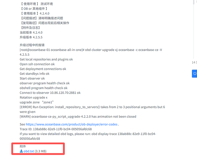

【 使用环境 】 测试环境
【 使用版本 】4.2.4.0
【问题描述】清晰明确描述问题
当前版本 4.2.4.0
升级版本 4.2.5.5
升级过程中的报错
[root@oceanbase-01 oceanbase-all-in-one]# obd cluster upgrade xj-oceanbase -c oceanbase-ce -V 4.2.5.5
Get local repositories and plugins ok
Open ssh connection ok
Get deployment connections ok
Get standbys info ok
Start observer ok
observer program health check ok
obshell program health check ok
Connect to observer 10.86.120.70:2881 ok
Rotation upgrade x
upgrade zone “zone1”
[ERROR] Run Exception: install_repository_to_servers() takes from 2 to 3 positional arguments but 6 were given
[WARN] oceanbase-ce-py_script_upgrade-4.2.2.0 has animation not been closed
Trace ID: 138ab88c-82e9-11f0-bc04-005056afdc68
If you want to view detailed obd logs, please run: obd display-trace 138ab88c-82e9-11f0-bc04-005056afdc68

杭州下小雨
2025 年8 月 27 日 11:21
#11
obd版本是3.5.0
[root@oceanbase-01 ~]# obd --version
OceanBase Deploy: 3.5.0
REVISION: 44567bd3badf6bd36a6b73f5ddcd66682da47574
BUILD_BRANCH: HEAD
BUILD_TIME: Aug 19 2025 17:18:14OURCE
Copyright (C) 2025 OceanBase
License Apache 2.0: Apache version 2 or later https://www.apache.org/licenses/LICENSE-2.0 .
This is free software: you are free to change and redistribute it.
There is NO WARRANTY, to the extent permitted by law.
杭州下小雨

杭州下小雨
2025 年8 月 27 日 14:20
#18
[root@oceanbase-01 ~]# rm /root/.obd/version
rm:是否删除普通文件 “/root/.obd/version”?y
[root@oceanbase-01 ~]# obd cluster list
| Cluster List |
| Name | Configuration Path | Status (Cached) |
| xj-oceanbase | /root/.obd/cluster/xj-oceanbase | upgrading |
Trace ID: a15dc7de-830d-11f0-b971-005056afdc68
If you want to view detailed obd logs, please run: obd display-trace a15dc7de-830d-11f0-b971-005056afdc68
[root@oceanbase-01 ~]# ll /root/.obd/version
-rw-r–r-- 1 root root 5 8月 27 14:18 /root/.obd/version
[root@oceanbase-01 ~]# cat /root/.obd/version
3.5.0[root@oceanbase-01 ~]# ^C
[root@oceanbase-01 ~]# obd cluster list^C
[root@oceanbase-01 ~]# obd cluster upgrade xj-oceanbase -c oceanbase-ce -V 4.2.5.5 --usable=d661d3fbb99eb47f9ee8603f5080e17face61ef2
Start observer ok
Rotation upgrade x
Trace ID: b68e9ed0-830d-11f0-9ad9-005056afdc68
If you want to view detailed obd logs, please run: obd display-trace b68e9ed0-830d-11f0-9ad9-005056afdc68
刷新了一下,还是不行,还是报错一样。
[2025-08-27 14:19:03.560] [ERROR] [ERROR] Run Exception: install_repository_to_servers() takes from 2 to 3 positional arguments but 6 were given
[2025-08-27 14:19:03.560] [ERROR] Traceback (most recent call last):
[2025-08-27 14:19:03.561] [ERROR] File “core.py”, line 3480, in upgrade_cluster
[2025-08-27 14:19:03.561] [ERROR] File “core.py”, line 256, in run_workflow
[2025-08-27 14:19:03.561] [ERROR] File “core.py”, line 298, in run_plugin_template
[2025-08-27 14:19:03.561] [ERROR] File “core.py”, line 347, in call_plugin
[2025-08-27 14:19:03.561] [ERROR] File “_plugin.py”, line 348, in call
[2025-08-27 14:19:03.561] [ERROR] File “_plugin.py”, line 304, in _new_func
[2025-08-27 14:19:03.561] [ERROR] File “/root/.obd/plugins/oceanbase-ce/4.2.2.0/upgrade.py”, line 617, in upgrade
[2025-08-27 14:19:03.561] [ERROR] if upgrader.run():
[2025-08-27 14:19:03.561] [ERROR] File “/root/.obd/plugins/oceanbase-ce/4.2.2.0/upgrade.py”, line 248, in run
[2025-08-27 14:19:03.561] [ERROR] if not self.processself.process_index :
[2025-08-27 14:19:03.561] [ERROR] File “/root/.obd/plugins/oceanbase-ce/4.2.2.0/upgrade.py”, line 485, in upgrade_zone
[2025-08-27 14:19:03.561] [ERROR] ret = self.rolling_upgrade(zones_servers)
[2025-08-27 14:19:03.562] [ERROR] File “/root/.obd/plugins/oceanbase-ce/4.2.2.0/upgrade.py”, line 533, in rolling_upgrade
[2025-08-27 14:19:03.562] [ERROR] self.install_repository_to_servers(self.components, self.cluster_config, repository, self.clients, self.unuse_lib_repository)
[2025-08-27 14:19:03.562] [ERROR] TypeError: install_repository_to_servers() takes from 2 to 3 positional arguments but 6 were given
[2025-08-27 14:19:03.562] [DEBUG] - sub upgrade ref count to 0
[2025-08-27 14:19:03.562] [DEBUG] - export upgrade
[2025-08-27 14:19:03.562] [WARNING] [WARN] oceanbase-ce-py_script_upgrade-4.2.2.0 has animation not been closed
[2025-08-27 14:19:03.562] [DEBUG] - plugin oceanbase-ce-py_script_upgrade-4.2.2.0 result: None
[2025-08-27 14:19:03.563] [DEBUG] - dump upgrade meta data to /root/.obd/cluster/xj-oceanbase/.upgrade
[2025-08-27 14:19:03.672] [INFO] upgrade zone “zone1”
[2025-08-27 14:19:03.672] [INFO] [ERROR] Run Exception: install_repository_to_servers() takes from 2 to 3 positional arguments but 6 were given
[2025-08-27 14:19:03.672] [INFO] [WARN] oceanbase-ce-py_script_upgrade-4.2.2.0 has animation not been closed
[2025-08-27 14:19:03.672] [INFO] See https://www.oceanbase.com/product/ob-deployer/error-codes .
[2025-08-27 14:19:03.672] [INFO] Trace ID: b68e9ed0-830d-11f0-9ad9-005056afdc68
[2025-08-27 14:19:03.672] [INFO] If you want to view detailed obd logs, please run: obd display-trace b68e9ed0-830d-11f0-9ad9-005056afdc68
[2025-08-27 14:19:03.673] [DEBUG] - unlock /root/.obd/lock/global
[2025-08-27 14:19:03.673] [DEBUG] - unlock /root/.obd/lock/deploy_xj-oceanbase
[2025-08-27 14:19:03.673] [DEBUG] - unlock /root/.obd/lock/mirror_and_repo

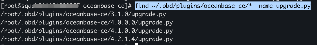

谐云
2025 年8 月 27 日 15:16
#19
find ~/.obd/plugins/oceanbase-ce/* -name upgrade.py 执行一下 截图一下。 我看了代码 obd3.5.0 插件里面 没有你报错里面的 oceanbase-ce/4.2.2.0/upgrade.py 这个插件。 我这边是这样的
