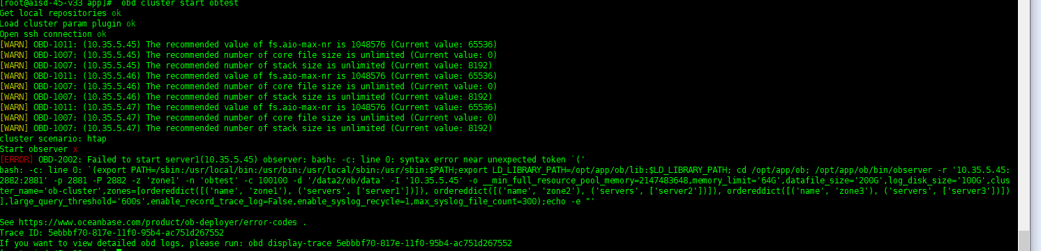

centos7通过obd安装,启动OBD-2002 bash: -c: line 0: syntax error near
[ERROR] OBD-2002: Failed to start server1(10.35.5.45) observer: bash: -c: line 0: syntax error near unexpected token `(’

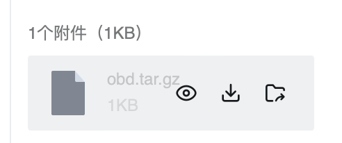

新用户没办法上传文件,大佬给个邮箱
cishuang.lxl@digital-engine.com
已通过QQ邮箱发送(**41308)
这里1kb解压出来是有问题。试试能不能直接发到帖子上吧

[2025-08-25 16:58:00.704] [96b2f2a0-8191-11f0-b6d9-ac751d267552] [DEBUG]
[2025-08-25 16:58:00.704] [96b2f2a0-8191-11f0-b6d9-ac751d267552] [DEBUG] – server2(10.35.5.46) start command construction
[2025-08-25 16:58:00.704] [96b2f2a0-8191-11f0-b6d9-ac751d267552] [DEBUG] – update large_query_threshold to 600s because of scenario
[2025-08-25 16:58:00.705] [96b2f2a0-8191-11f0-b6d9-ac751d267552] [DEBUG] – update enable_record_trace_log to False because of scenario
[2025-08-25 16:58:00.705] [96b2f2a0-8191-11f0-b6d9-ac751d267552] [DEBUG] – update enable_syslog_recycle to 1 because of scenario
[2025-08-25 16:58:00.705] [96b2f2a0-8191-11f0-b6d9-ac751d267552] [DEBUG] – update max_syslog_file_count to 300 because of scenario
[2025-08-25 16:58:00.705] [96b2f2a0-8191-11f0-b6d9-ac751d267552] [DEBUG] – root@10.35.5.47 execute: ls /data2/ob/data/clog/tenant_1/
[2025-08-25 16:58:00.746] [96b2f2a0-8191-11f0-b6d9-ac751d267552] [DEBUG] – exited code 2, error output:
[2025-08-25 16:58:00.746] [96b2f2a0-8191-11f0-b6d9-ac751d267552] [DEBUG] ls: cannot access /data2/ob/data/clog/tenant_1/: No such file or directory
[2025-08-25 16:58:00.747] [96b2f2a0-8191-11f0-b6d9-ac751d267552] [DEBUG] – root@10.35.5.47 execute: cat /opt/app/ob/run/observer.pid
[2025-08-25 16:58:00.825] [96b2f2a0-8191-11f0-b6d9-ac751d267552] [DEBUG] – exited code 1, error output:
[2025-08-25 16:58:00.826] [96b2f2a0-8191-11f0-b6d9-ac751d267552] [DEBUG] cat: /opt/app/ob/run/observer.pid: No such file or directory
[2025-08-25 16:58:00.826] [96b2f2a0-8191-11f0-b6d9-ac751d267552] [DEBUG] – server3(10.35.5.47) start command construction
[2025-08-25 16:58:00.827] [96b2f2a0-8191-11f0-b6d9-ac751d267552] [DEBUG] – update large_query_threshold to 600s because of scenario
[2025-08-25 16:58:00.827] [96b2f2a0-8191-11f0-b6d9-ac751d267552] [DEBUG] – update enable_record_trace_log to False because of scenario
[2025-08-25 16:58:00.827] [96b2f2a0-8191-11f0-b6d9-ac751d267552] [DEBUG] – update enable_syslog_recycle to 1 because of scenario
[2025-08-25 16:58:00.827] [96b2f2a0-8191-11f0-b6d9-ac751d267552] [DEBUG] – update max_syslog_file_count to 300 because of scenario
[2025-08-25 16:58:00.828] [96b2f2a0-8191-11f0-b6d9-ac751d267552] [DEBUG] - sub start_pre ref count to 0
[2025-08-25 16:58:00.828] [96b2f2a0-8191-11f0-b6d9-ac751d267552] [DEBUG] - export start_pre
[2025-08-25 16:58:00.828] [96b2f2a0-8191-11f0-b6d9-ac751d267552] [DEBUG] - plugin oceanbase-ce-py_script_start_pre-4.2.5.0 result: True
[2025-08-25 16:58:00.828] [96b2f2a0-8191-11f0-b6d9-ac751d267552] [DEBUG] - Searching start plugin for components …
[2025-08-25 16:58:00.828] [96b2f2a0-8191-11f0-b6d9-ac751d267552] [DEBUG] - Searching start plugin for oceanbase-ce-4.3.5.3-103000092025080818.el7-8120a146d35cd47a9289d91990c8b44a8c21675d
[2025-08-25 16:58:00.830] [96b2f2a0-8191-11f0-b6d9-ac751d267552] [DEBUG] - Found for oceanbase-ce-py_script_start-3.1.0 for oceanbase-ce-4.3.5.3
[2025-08-25 16:58:00.830] [96b2f2a0-8191-11f0-b6d9-ac751d267552] [DEBUG] - Call plugin oceanbase-ce-py_script_start-3.1.0 for oceanbase-ce-4.3.5.3-103000092025080818.el7-8120a146d35cd47a9289d91990c8b44a8c21675d
[2025-08-25 16:58:00.830] [96b2f2a0-8191-11f0-b6d9-ac751d267552] [DEBUG] - import start
[2025-08-25 16:58:00.832] [96b2f2a0-8191-11f0-b6d9-ac751d267552] [DEBUG] - add start ref count to 1
[2025-08-25 16:58:00.833] [96b2f2a0-8191-11f0-b6d9-ac751d267552] [INFO] Start observer
[2025-08-25 16:58:00.835] [96b2f2a0-8191-11f0-b6d9-ac751d267552] [DEBUG] – starting server1(10.35.5.45) observer
[2025-08-25 16:58:00.836] [96b2f2a0-8191-11f0-b6d9-ac751d267552] [DEBUG] – root@10.35.5.45 export LD_LIBRARY_PATH=’/opt/app/ob/lib:’
[2025-08-25 16:58:00.836] [96b2f2a0-8191-11f0-b6d9-ac751d267552] [DEBUG] – root@10.35.5.45 execute: cd /opt/app/ob; /opt/app/ob/bin/observer -r ‘10.35.5.45:2882:2881’ -p 2881 -P 2882 -z ‘zone1’ -n ‘obtest’ -c 100100 -d ‘/data2/ob/data’ -I ‘10.35.5.45’ -o __min_full_resource_pool_memory=2147483648,memory_limit=‘64G’,datafile_size=‘200G’,log_disk_size=‘100G’,cluster_name=‘ob-cluster’,zones=[ordereddict([(‘name’, ‘zone1’), (‘servers’, [‘server1’])]), ordereddict([(‘name’, ‘zone2’), (‘servers’, [‘server2’])]), ordereddict([(‘name’, ‘zone3’), (‘servers’, [‘server3’])])],large_query_threshold=‘600s’,enable_record_trace_log=False,enable_syslog_recycle=1,max_syslog_file_count=300
[2025-08-25 16:58:00.874] [96b2f2a0-8191-11f0-b6d9-ac751d267552] [DEBUG] – exited code 1, error output:
[2025-08-25 16:58:00.875] [96b2f2a0-8191-11f0-b6d9-ac751d267552] [DEBUG] bash: -c: line 0: syntax error near unexpected token (' [2025-08-25 16:58:00.875] [96b2f2a0-8191-11f0-b6d9-ac751d267552] [DEBUG] bash: -c: line 0: (export PATH=/sbin:/usr/local/bin:/usr/bin:/usr/local/sbin:/usr/sbin:$PATH;export LD_LIBRARY_PATH=/opt/app/ob/lib:$LD_LIBRARY_PATH; cd /opt/app/ob; /opt/app/ob/bin/observer -r ‘10.35.5.45:2882:2881’ -p 2881 -P 2882 -z ‘zone1’ -n ‘obtest’ -c 100100 -d ‘/data2/ob/data’ -I ‘10.35.5.45’ -o __min_full_resource_pool_memory=2147483648,memory_limit=‘64G’,datafile_size=‘200G’,log_disk_size=‘100G’,cluster_name=‘ob-cluster’,zones=[ordereddict([(‘name’, ‘zone1’), (‘servers’, [‘server1’])]), ordereddict([(‘name’, ‘zone2’), (‘servers’, [‘server2’])]), ordereddict([(‘name’, ‘zone3’), (‘servers’, [‘server3’])])],large_query_threshold=‘600s’,enable_record_trace_log=False,enable_syslog_recycle=1,max_syslog_file_count=300);echo -e "’
[2025-08-25 16:58:00.876] [96b2f2a0-8191-11f0-b6d9-ac751d267552] [DEBUG] – root@10.35.5.45 delete env LD_LIBRARY_PATH
[2025-08-25 16:58:00.969] [96b2f2a0-8191-11f0-b6d9-ac751d267552] [ERROR] [ERROR] OBD-2002: Failed to start server1(10.35.5.45) observer: bash: -c: line 0: syntax error near unexpected token (' [2025-08-25 16:58:00.969] [96b2f2a0-8191-11f0-b6d9-ac751d267552] [ERROR] bash: -c: line 0: (export PATH=/sbin:/usr/local/bin:/usr/bin:/usr/local/sbin:/usr/sbin:$PATH;export LD_LIBRARY_PATH=/opt/app/ob/lib:$LD_LIBRARY_PATH; cd /opt/app/ob; /opt/app/ob/bin/observer -r ‘10.35.5.45:2882:2881’ -p 2881 -P 2882 -z ‘zone1’ -n ‘obtest’ -c 100100 -d ‘/data2/ob/data’ -I ‘10.35.5.45’ -o __min_full_resource_pool_memory=2147483648,memory_limit=‘64G’,datafile_size=‘200G’,log_disk_size=‘100G’,cluster_name=‘ob-cluster’,zones=[ordereddict([(‘name’, ‘zone1’), (‘servers’, [‘server1’])]), ordereddict([(‘name’, ‘zone2’), (‘servers’, [‘server2’])]), ordereddict([(‘name’, ‘zone3’), (‘servers’, [‘server3’])])],large_query_threshold=‘600s’,enable_record_trace_log=False,enable_syslog_recycle=1,max_syslog_file_count=300);echo -e "’
[2025-08-25 16:58:00.969] [96b2f2a0-8191-11f0-b6d9-ac751d267552] [DEBUG] - sub start ref count to 0
[2025-08-25 16:58:00.969] [96b2f2a0-8191-11f0-b6d9-ac751d267552] [DEBUG] - export start
[2025-08-25 16:58:00.970] [96b2f2a0-8191-11f0-b6d9-ac751d267552] [DEBUG] - plugin oceanbase-ce-py_script_start-3.1.0 result: None
[2025-08-25 16:58:00.979] [96b2f2a0-8191-11f0-b6d9-ac751d267552] [DEBUG] - share lock /root/.obd/lock/mirror_and_repo release, count 1
[2025-08-25 16:58:00.980] [96b2f2a0-8191-11f0-b6d9-ac751d267552] [DEBUG] - share lock /root/.obd/lock/mirror_and_repo release, count 0
[2025-08-25 16:58:00.980] [96b2f2a0-8191-11f0-b6d9-ac751d267552] [DEBUG] - unlock /root/.obd/lock/mirror_and_repo
[2025-08-25 16:58:00.980] [96b2f2a0-8191-11f0-b6d9-ac751d267552] [DEBUG] - exclusive lock /root/.obd/lock/deploy_obtest release, count 0
[2025-08-25 16:58:00.980] [96b2f2a0-8191-11f0-b6d9-ac751d267552] [DEBUG] - unlock /root/.obd/lock/deploy_obtest
[2025-08-25 16:58:00.980] [96b2f2a0-8191-11f0-b6d9-ac751d267552] [DEBUG] - share lock /root/.obd/lock/global release, count 0
[2025-08-25 16:58:00.980] [96b2f2a0-8191-11f0-b6d9-ac751d267552] [DEBUG] - unlock /root/.obd/lock/global
