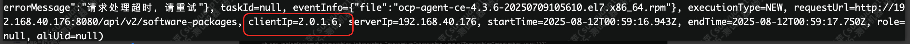

这个clientIp有些奇怪,是怎么来的呢?
访问的电脑的IP,代理过的
2025-08-12 10:05:03.189 INFO 427468 — [http-nio-0.0.0.0-8080-exec-2,e30bd14531d64633,9097890ce8dd999b] c.o.o.s.c.c.s.utils.CsrfRequestMatcher : CSRF token required for API [POST /api/v2/software-packages, client 192.168.128.86, traceId e30bd14531d64633]
2025-08-12 10:05:03.304 INFO 427468 — [http-nio-0.0.0.0-8080-exec-2,e30bd14531d64633,9097890ce8dd999b] c.o.o.s.c.trace.RequestTracingAspect : API: [POST /api/v2/software-packages?null, client=192.168.128.86, traceId=e30bd14531d64633, method=SuccessResponse com.oceanbase.ocp.server.common.controller.SoftwarePackageController.uploadPackage(MultipartFile), args=]
2025-08-12 10:05:03.337 INFO 427468 — [http-nio-0.0.0.0-8080-exec-2,e30bd14531d64633,9097890ce8dd999b] .o.o.s.o.i.LocalObjectStorageServiceImpl : Init saving object, creatorId=100, bucket=sys-package, name=ob-sysbench-1.0.20-21.el7.x86_64.rpm, objectId=53
2025-08-12 10:05:03.348 INFO 427468 — [http-nio-0.0.0.0-8080-exec-2,e30bd14531d64633,9097890ce8dd999b] .o.o.s.o.i.LocalObjectStorageServiceImpl : Unexpected exception when saving.
2025-08-12 10:05:03.348 INFO 427468 — [http-nio-0.0.0.0-8080-exec-2,e30bd14531d64633,9097890ce8dd999b] .o.o.s.o.i.LocalObjectStorageServiceImpl : Clean failed upload record, objectId=53
2025-08-12 10:05:03.349 INFO 427468 — [http-nio-0.0.0.0-8080-exec-2,e30bd14531d64633,9097890ce8dd999b] c.o.o.s.o.operator.ObjectBlockOperator : deleteByFileId, deletedBlockCount=0
2025-08-12 10:05:03.361 INFO 427468 — [http-nio-0.0.0.0-8080-exec-2,e30bd14531d64633,9097890ce8dd999b] c.o.ocp.service.audit.AuditEventService : begin create audit event, param:CreateAuditEventParam(operationEvent=UPLOAD_PACKAGE, eventType=SOFTWARE_PACKAGE_MANAGEMENT, methodSignature=com.oceanbase.ocp.server.common.controller.SoftwarePackageController.uploadPackage, resourceType=SOFTWARE_PACKAGE, resources=[CreateAuditEventParam.AuditResourceParam(resourceId=null, resourceName=ob-sysbench-1.0.20-21.el7.x86_64.rpm, parentResource=null)], operatorId=100, operatorName=admin, status=FAILED, failedReason={“errorCode”:“COM10004”,“errorMessage”:“请求处理超时,请重试”}, taskId=null, eventInfo={“file”:“ob-sysbench-1.0.20-21.el7.x86_64.rpm”}, executionType=NEW, requestUrl=http://192.168.40.172:8080/api/v2/software-packages, clientIp=192.168.128.86, serverIp=192.168.40.172, startTime=2025-08-12T10:05:03.304Z, endTime=2025-08-12T10:05:03.360Z, role=null, aliUid=null)
2025-08-12 10:05:03.373 WARN 427468 — [http-nio-0.0.0.0-8080-exec-2,e30bd14531d64633,9097890ce8dd999b] c.o.o.s.c.trace.RequestTracingAspect : API Error: [POST /api/v2/software-packages client=192.168.128.86, traceId=e30bd14531d64633, args=, duration=192 ms, errorMsg=[OCP OcpException]: status=503 SERVICE_UNAVAILABLE, errorCode=COMMON_TIMEOUT, args=]
那应该就是这里的问题,代理上可能有什么超时之类的配置,直连方式上传有问题吗?
直连上传也报错
