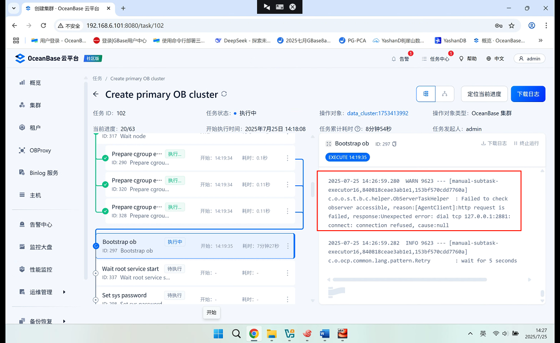

使用社区版OCP单独部署在一台机器,版本如下:
ocp-all-in-one-4.3.6-20250709105610.el7.x86_64.tar.gz
然后使用OCP白屏为其他三台机器创建集群会一直卡住最终导致失败(推倒重来试过几次都是一样失败),信息如下:
查看OCP工具手册,上面说可以通过ocp创建集群,但是询问其AI助手描述为不支持,何解?
因执行失败,已经执行回滚了,附上创建集群设置和日志如下:
日志如下:
log_task_102.zip (53.6 KB)
OCP白屏信息

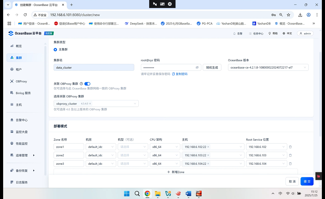

点击右上方的日志下载发下
创建集群 这个页面的配置发下

看起来是 6.102 的OB实例没起来,你看下这台机是否有observer.log 或者bootstrap.log 生成?
2025-07-25 14:20:36.643  INFO 9623 --- [manual-subtask-executor16,840818ceae3ab1e1,153bf570cdd7760a] c.o.o.e.internal.template.HttpTemplate   : POST request to agent, url:http://192.168.6.102:62888/api/v1/ob/observer/access, request body:AccessObServerProcessRequest(ip=192.168.6.102, port=2881, username=root), params:null
2025-07-25 14:20:36.649  WARN 9623 --- [manual-subtask-executor16,840818ceae3ab1e1,153bf570cdd7760a] c.o.o.s.t.b.c.helper.ObServerTaskHelper  : Failed to check observer accessible, reason:[AgentClient]:http request is failed, response:Unexpected error: dial tcp 127.0.0.1:2881: connect: connection refused, cause:null
2025-07-25 14:20:36.652  INFO 9623 --- [manual-subtask-executor16,840818ceae3ab1e1,153bf570cdd7760a] c.o.ocp.common.lang.pattern.Retry        : wait for 5 seconds
2025-07-25 14:20:41.703  INFO 9623 --- [manual-subtask-executor16,840818ceae3ab1e1,153bf570cdd7760a] c.o.o.c.agent.HostAgentServiceImpl       : Finding OCP agent: hostId=2
2025-07-25 14:20:41.707  INFO 9623 --- [manual-subtask-executor16,840818ceae3ab1e1,153bf570cdd7760a] c.o.o.c.a.p.HostAgentProcessServiceImpl  : Getting all OCP agent processes on host 2
2025-07-25 14:20:41.721  INFO 9623 --- [manual-subtask-executor16,840818ceae3ab1e1,153bf570cdd7760a] c.o.o.e.internal.template.HttpTemplate   : POST request to agent, url:http://192.168.6.102:62888/api/v1/ob/observer/access, request body:AccessObServerProcessRequest(ip=192.168.6.102, port=2881, username=root), params:null
2025-07-25 14:20:41.727  WARN 9623 --- [manual-subtask-executor16,840818ceae3ab1e1,153bf570cdd7760a] c.o.o.s.t.b.c.helper.ObServerTaskHelper  : Failed to check observer accessible, reason:[AgentClient]:http request is failed, response:Unexpected error: dial tcp 127.0.0.1:2881: connect: connection refused, cause:null
2025-07-25 14:20:41.729  INFO 9623 --- [manual-subtask-executor16,840818ceae3ab1e1,153bf570cdd7760a] c.o.ocp.common.lang.pattern.Retry        : wait for 5 seconds
2025-07-25 14:20:46.754  INFO 9623 --- [manual-subtask-executor16,840818ceae3ab1e1,153bf570cdd7760a] c.o.o.c.agent.HostAgentServiceImpl       : Finding OCP agent: hostId=2
2025-07-25 14:20:46.762  INFO 9623 --- [manual-subtask-executor16,840818ceae3ab1e1,153bf570cdd7760a] c.o.o.c.a.p.HostAgentProcessServiceImpl  : Getting all OCP agent processes on host 2
2025-07-25 14:20:46.817  INFO 9623 --- [manual-subtask-executor16,840818ceae3ab1e1,153bf570cdd7760a] c.o.o.e.internal.template.HttpTemplate   : POST request to agent, url:http://192.168.6.102:62888/api/v1/ob/observer/access, request body:AccessObServerProcessRequest(ip=192.168.6.102, port=2881, username=root), params:null
2025-07-25 14:20:46.824  WARN 9623 --- [manual-subtask-executor16,840818ceae3ab1e1,153bf570cdd7760a] c.o.o.s.t.b.c.helper.ObServerTaskHelper  : Failed to check observer accessible, reason:[AgentClient]:http request is failed, response:Unexpected error: dial tcp 127.0.0.1:2881: connect: connection refused, cause:null
2025-07-25 14:20:46.827  INFO 9623 --- [manual-subtask-executor16,840818ceae3ab1e1,153bf570cdd7760a] c.o.ocp.common.lang.pattern.Retry        : wait for 5 seconds
2025-07-25 14:20:51.863  INFO 9623 --- [manual-subtask-executor16,840818ceae3ab1e1,153bf570cdd7760a] c.o.o.c.agent.HostAgentServiceImpl       : Finding OCP agent: hostId=2
2025-07-25 14:20:51.870  INFO 9623 --- [manual-subtask-executor16,840818ceae3ab1e1,153bf570cdd7760a] c.o.o.c.a.p.HostAgentProcessServiceImpl  : Getting all OCP agent processes on host 2
2025-07-25 14:20:51.919  INFO 9623 --- [manual-subtask-executor16,840818ceae3ab1e1,153bf570cdd7760a] c.o.o.e.internal.template.HttpTemplate   : POST request to agent, url:http://192.168.6.102:62888/api/v1/ob/observer/access, request body:AccessObServerProcessRequest(ip=192.168.6.102, port=2881, username=root), params:null
2025-07-25 14:20:51.925  WARN 9623 --- [manual-subtask-executor16,840818ceae3ab1e1,153bf570cdd7760a] c.o.o.s.t.b.c.helper.ObServerTaskHelper  : Failed to check observer accessible, reason:[AgentClient]:http request is failed, response:Unexpected error: dial tcp 127.0.0.1:2881: connect: connection refused, cause:null
2025-07-25 14:20:51.928  INFO 9623 --- [manual-subtask-executor16,840818ceae3ab1e1,153bf570cdd7760a] c.o.ocp.common.lang.pattern.Retry        : wait for 5 seconds
2025-07-25 14:20:56.957  INFO 9623 --- [manual-subtask-executor16,840818ceae3ab1e1,153bf570cdd7760a] c.o.o.c.agent.HostAgentServiceImpl       : Finding OCP agent: hostId=2
2025-07-25 14:20:56.968  INFO 9623 --- [manual-subtask-executor16,840818ceae3ab1e1,153bf570cdd7760a] c.o.o.c.a.p.HostAgentProcessServiceImpl  : Getting all OCP agent processes on host 2
