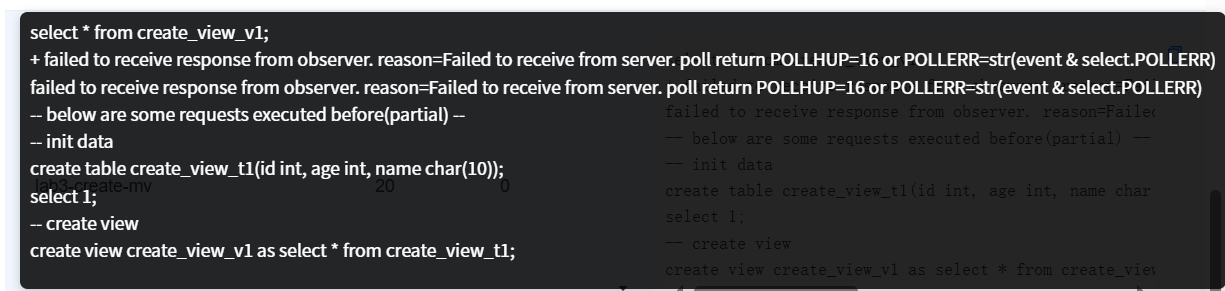

数据库暑期学校2025的lab3提交评测的时候遇到了一些问题,本地运行无误,但提测有问题
另外想问一下create view create_view_v1 as select * from create_view_t1;是否是create materialized view create_view_v1 as select * from create_view_t1;
如果可以的话,方便提供下测试用例嘛
如果可以的话,方便提供下测试用例嘛

请问想问一下create view create_view_v1 as select * from create_view_t1;
是否应该是create materialized view create_view_v1 as select * from create_view_t1;

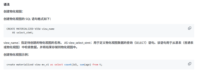

因为在 miniob/docs/docs/design/miniob-realtime-analytic.md at vldbss-2025 · oceanbase/miniob中是这样描述的,应该只需要实现物化视图即可?
是的,MiniOB只用实现create materialized view
create view是给mysql的命令,用来对比结果
