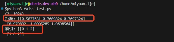

测试结果:
首先看一下客户场景的三行数据分别对应的向量(可以跟上面的 data.txt 做比对):
5549: [-0.0590525,-0.00187155,-0.0810449,-0.00470622,-0.0533451,0.0042306,-0.0341682,0.09421,-0.0391907,0.039419,0.0276047,0.0390005,0.0144873,0.0444415,0.0638847,-0.00629715,0.0286321,-0.00696777,-0.030896,-0.0606505,-0.00527458......]
617: [-0.0625166,-0.0181,-0.0735626,0.0277313,-0.036665,0.0115111,-0.0352504,0.0863527,-0.025464,0.0356379,-0.0219176,0.0210843,-0.0305994,0.0746478,0.0482924,0.0199797,0.0373821,-0.0118212,-0.0228478,-0.0479824,-0.0149896,-0.0266461......]
5454: [-0.0389573,0.00282359,-0.0618927,-0.000736588,-0.0808803,0.0216259,-0.016022,0.110613,-0.0338927,0.0410564,-0.00894498,0.0110248,0.0251692,0.0568858,0.0851939,0.0245144,0.0596974,-0.0306575,-0.0170811,-0.0529573,-0.012469......]
脚本执行结果:
1751019406
结论
faiss 暴力搜索(精确搜索)的结果为 5549,617,5454(0,1,2 是 data.txt 中向量的顺序,转换为客户场景的 collection_id 就是 5549,617,5454)。
这个结果与 OB 查询的结果是一致的,也足以在客户的场景下证明 OB 查询的结果相对于 chroma 是更精确的。
同时我们还可以再看 faiss 暴力搜索结果中打印的 distance,发现确实是 617 这一行的 l2 距离计算误差较大导致,这个也可以证明我们前面的分析是正确的。
