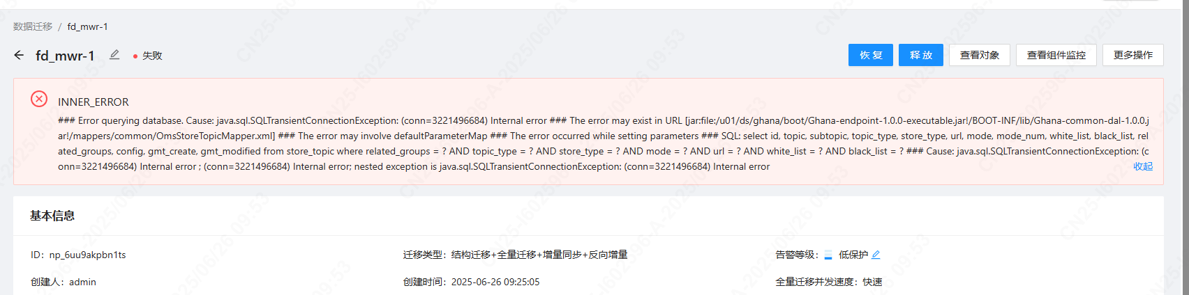

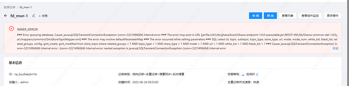

oms迁移数据全量报错
【 OB or 其他组件 】oms
【 使用版本 】 4.2.7_CE
【问题描述】全量初始化时出现 The error occurred while setting parametersconn=3221494960
Error querying database. Cause: java.sql.SQLTransientConnectionException: (conn=3221494960) Internal error ### The error may exist in URL [jar:file:/u01/ds/ghana/boot/Ghana-endpoint-1.0.0-executable.jar!/BOOT-INF/lib/Ghana-common-dal-1.0.0.jar!/mappers/common/OmsStoreTopicMapper.xml] ### The error may involve defaultParameterMap ### The error occurred while setting parameters ### SQL: select id, topic, subtopic, topic_type, store_type, url, mode, mode_num, white_list, black_list, related_groups, config, gmt_create, gmt_modified from store_topic where related_groups = ? AND topic_type = ? AND store_type = ? AND mode = ? AND url = ? AND white_list = ? AND black_list = ? ### Cause: java.sql.SQLTransientConnectionException: (conn=3221494960) Internal error ; (conn=3221494960) Internal error; nested exception is java.sql.SQLTransientConnectionException: (conn=3221494960) Internal error

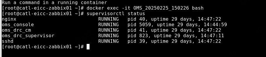

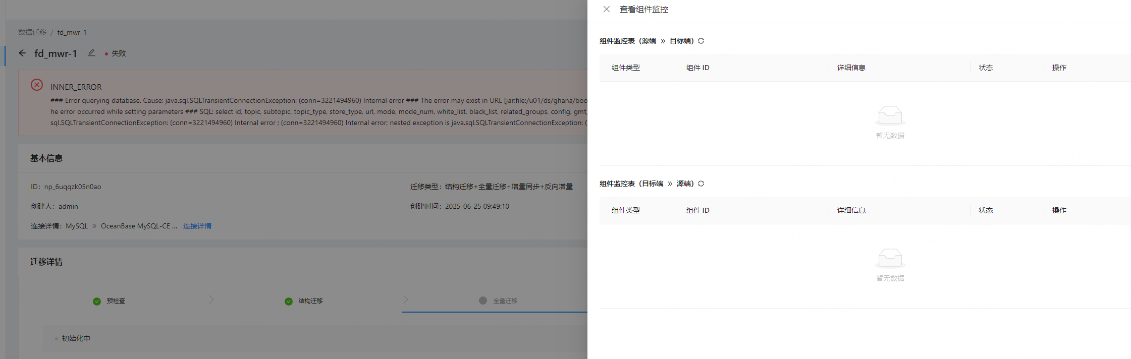

发一下 组件监控的组件的状态 截图看看 看看error.log日志信息
进入到容器中 查看一下 组件所有的状态
docker exec -it <oms_container_name> bash
supervisorctl status

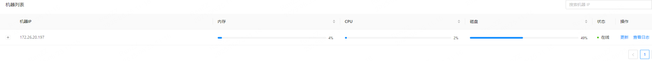

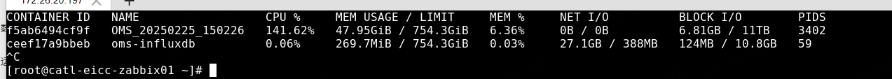

可以看一下运维监控-机器 看看资源是否够

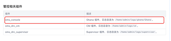

麻烦发一下日志,oms容器 /home/admin/logs/ghana/Ghana/
common-default.log、common-error.log
已私发消息
### Error querying database.  Cause: java.sql.SQLTransientConnectionException: (conn=3221496708) Internal error
### Cause: java.sql.SQLTransientConnectionException: (conn=3221496708) Internal error
; (conn=3221496708) Internal error; nested exception is java.sql.SQLTransientConnectionException: (conn=3221496708) Internal error

帮忙看看,是这个sql 查询导致报错的吗?

这个是sql查询导致的报错,可能是元数据库有点问题。
你们之前发的日志里有
java.sql.SQLNonTransientConnectionException: Could not connect to address=(host=xxx)(port=2881)(type=master) : (conn=3221487664) Server is initializing
ob状态可能有点不对
select * from store_topic
1	MYSQL__6ushztcsfrxc	MYSQL__6ushztcsfrxc-1-0	MYSQL	CRAWLER	jdbc:mysql://10.167.204.206:3306?useUnicode=true&characterEncoding=utf8&allowLoadLocalInfile=false&autoDeserialize=false&allowLocalInfile=false&allowUrlInLocalInfile=false&useSSL=false&allowPublicKeyRetrieval=true	UN_SHARE	1	hap.*	hap.catl_fty_nc_data|hap.catl_pmc_prod_schedule|hap.catl_producion_log_data|hap.catl_fty_nc_data_detail|hap.catl_come_nc_data_detal|hap.catl_tracibility_report|hap.catl_fai_log	null		2025-06-25 21:35:00	2025-06-25 21:35:00
这个sql 我 查了下,能查出来,值有问题吗?

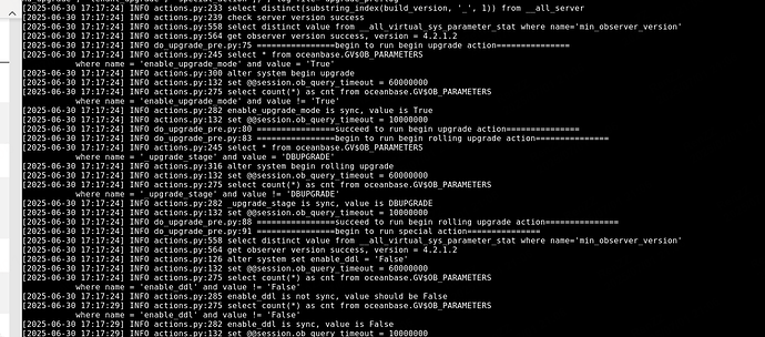

使用mysql作为元数据库试一下呢,(conn=3221496708) Internal error可能是个ob的内部报错
升级ob的版本可以吗?因为之前都没报错,最近才报的错
ob使用的是哪个版本 之前一直使用 没有报错 是有删除过什么数据么
oceanbase-ce-4.2.1.2-102000042023120514.el8.x86_64.rpm
