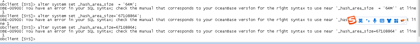

【问题描述】由于SQL会有大表的hash join,希望通过修改hash_area_size提高性能,但一直报语法错误。
obclient [SYS]> alter system set _hash_area_size = ‘64M’;
OBE-00900: You have an error in your SQL syntax; check the manual that corresponds to your OceanBase version for the right syntax to use near ‘_hash_area_size = ‘64M’’ at line 1
obclient [SYS]> alter system set _hash_area_size=‘67108864’;
OBE-00900: You have an error in your SQL syntax; check the manual that corresponds to your OceanBase version for the right syntax to use near ‘_hash_area_size=‘67108864’’ at line 1
obclient [SYS]> alter system set _hash_area_size=67108864;
OBE-00900: You have an error in your SQL syntax; check the manual that corresponds to your OceanBase version for the right syntax to use near ‘_hash_area_size=67108864’ at line 1
obclient [SYS]>
先修改了workarea_size_policy=‘manual’ 之后也不行。

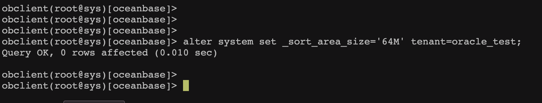

通过SYS租户修改吧,测试了一下业务租户修改不了 alter system set _sort_area_size=‘64M’ tenant=tenant_name;
alter system set “_sort_area_size” = ‘64M’; 这样执行
如果不指定租户 默认使用的是哪个?
试了一下,在sys租户下执行不用加双引号。在普通租户下执行,需要加双引号。
