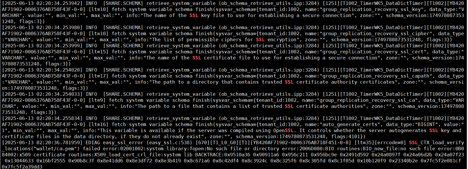

【问题描述】启用ssl,报key and cert not match,查看日志,提示找不到文件

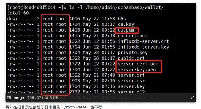

证书目录:
另外在根目录也创建了日志目录:/root/wallet,也不行

你是根据这个文档 开启的么?按照文档的检查 发一下信息
https://www.oceanbase.com/docs/common-oceanbase-database-cn-1000000002013027
社区版不支持这个命令:ssl_external_kms_info
麻烦按照文档检查一下 开启情况 发一下

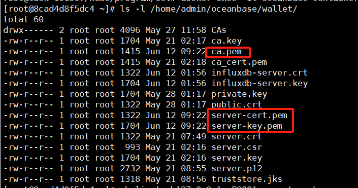

[root@8cad4d8f5dc4 ~]# ls -l /home/admin/oceanbase/wallet/
total 60
drwx------ 2 root root 4096 May 27 11:58 CAs
-rw-r–r-- 1 root root 1704 May 21 02:17 ca.key
-rw-r–r-- 1 root root 1415 Jun 12 09:22 ca.pem
-rw-r–r-- 1 root root 1415 May 21 02:18 ca_cert.pem
-rw-r–r-- 1 root root 1322 Jun 12 01:56 influxdb-server.crt
-rw-r–r-- 1 root root 1704 Jun 12 01:56 influxdb-server.key
-rw-r–r-- 1 root root 1704 May 28 01:17 private.key
-rw-r–r-- 1 root root 1322 May 28 01:17 public.crt
-rw-r–r-- 1 root root 1322 Jun 12 09:22 server-cert.pem
-rw-r–r-- 1 root root 1704 Jun 12 09:22 server-key.pem
-rw-r–r-- 1 root root 1322 May 21 07:49 server.crt
-rw-r–r-- 1 root root 993 May 21 02:16 server.csr
-rw-r–r-- 1 root root 1704 May 21 02:16 server.key
-rw-r–r-- 1 root root 2732 May 21 08:55 server.p12
-rw-r–r-- 1 root root 1318 May 21 08:56 truststore.jks

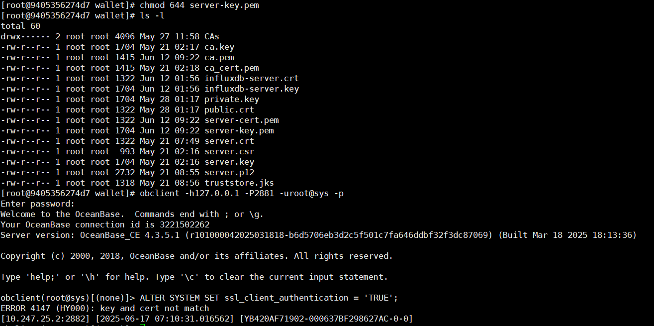

[root@8cad4d8f5dc4 ~]# obclient -h127.0.0.1 -P2881 -uroot@sys -p
Enter password:
Welcome to the OceanBase. Commands end with ; or \g.
Your OceanBase connection id is 3221507013
Server version: OceanBase_CE 4.3.5.1 (r101000042025031818-b6d5706eb3d2c5f501c7fa646ddbf32f3dc87069) (Built Mar 18 2025 18:13:36)
Type ‘help;’ or ‘\h’ for help. Type ‘\c’ to clear the current input statement.
obclient(root@sys)[(none)]> ALTER SYSTEM SET ssl_external_kms_info = ‘{“ssl_mode”:“file”}’;
ERROR 1235 (0A000): Not supported feature or function
[10.247.25.2:2882] [2025-06-13 08:03:41.797506] [YB420AF71902-0006376F7AE67E52-0-0]
obclient(root@sys)[(none)]> ALTER SYSTEM SET sql_protocol_min_tls_version = ‘TLSv1.1’;
Query OK, 0 rows affected (0.050 sec)

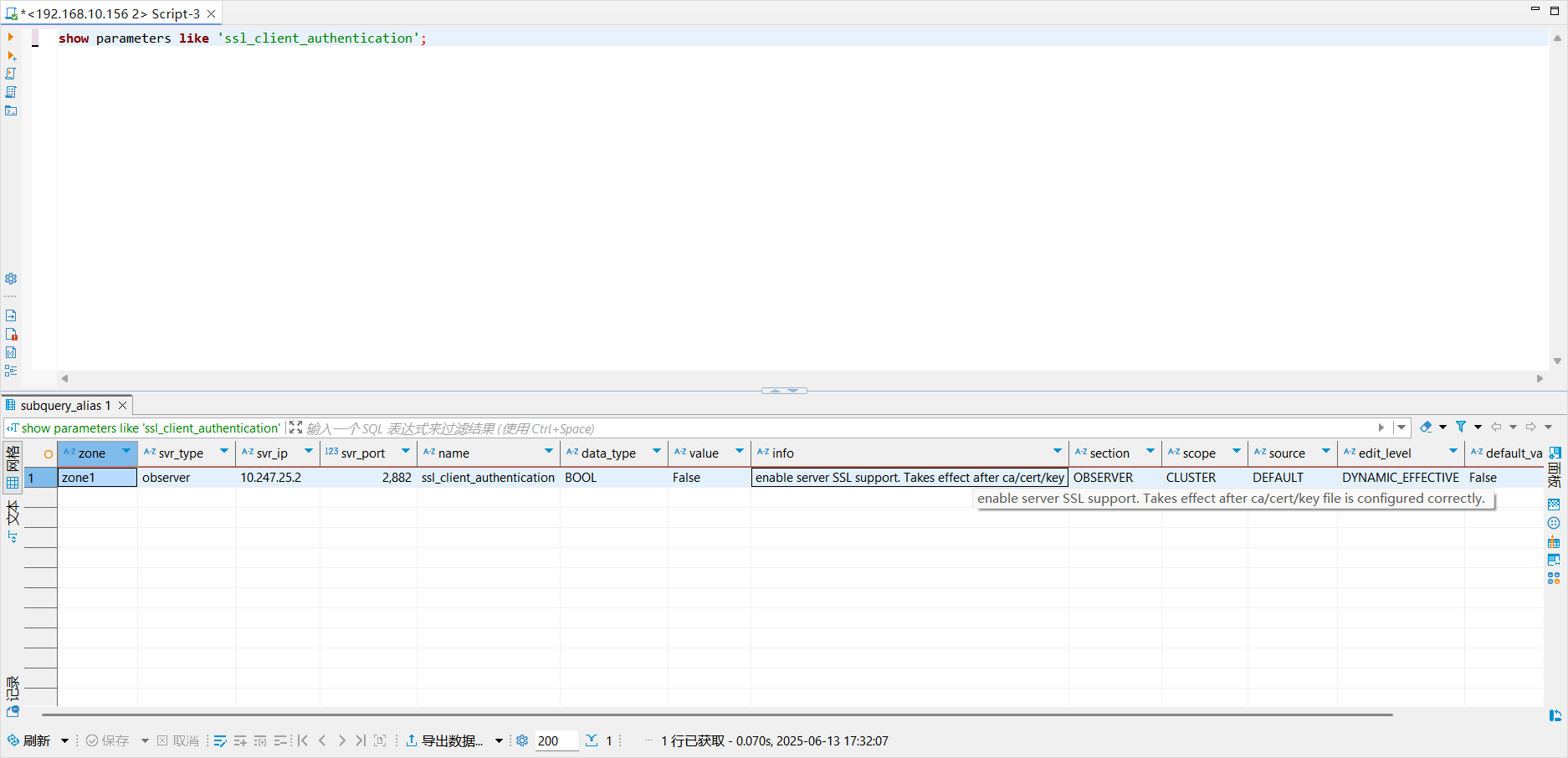

obclient(root@sys)[(none)]> ALTER SYSTEM SET ssl_client_authentication = ‘TRUE’;
ERROR 4147 (HY000): key and cert not match
[10.247.25.2:2882] [2025-06-13 08:04:06.968087] [YB420AF71902-0006376F7AE67EBC-0-0]
show parameters like ‘ssl_client_authentication’; 你查一下 这个配置项

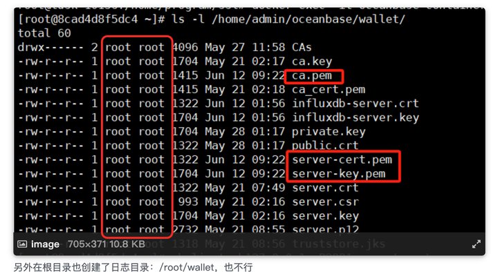

看着是目录权限有问题,运行observer应该是admin吧或者其他用户(非root用户),看着目录的权限是root
目录的owner和group的用户都是root,admin用户应该没有权限访问这里的文件,如果是admin用户启动的observer或者其他用户(非root用户) 需要chown改一下

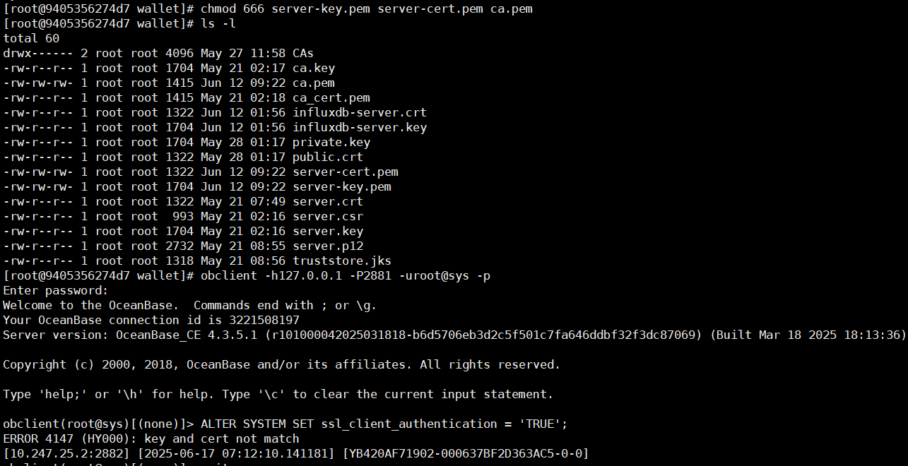

还是不行的
给了所有可读可写权限都不行的
服务器只有root用户,oceanbase也没有要求额外创建admin用户吧,正常来说文件给予权限就可以访问的,跟用户没啥关系吧

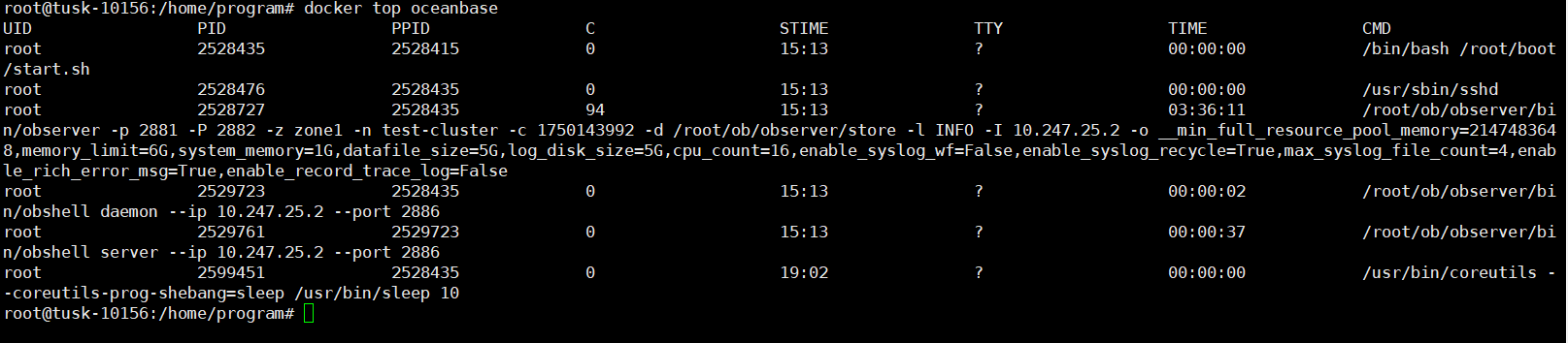

那你的observer是哪个用户启动的 ps -ef |grep observer | grep -v grep
docker部署的,默认就是root用户启动的呀
