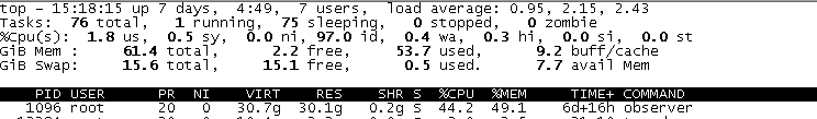

observer的内存一直增加,增大集群的内存,一会就达到90%以上,怎么定位到底是什么在占用内存呢
DEFAULT_CTX_ID的内存为啥一直走高

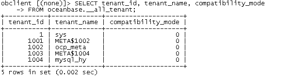

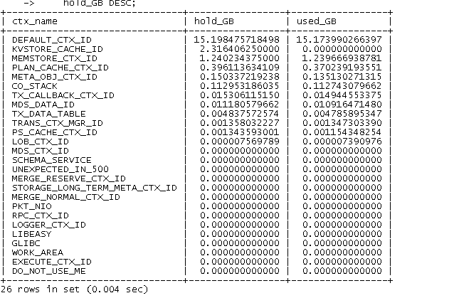

可以通过gv$ob_memory查一下看看哪个租户内存占比大。ocp-express组件有很久没更新当前已经不进行维护了,所以很多问题都可能会是他或者他的meta租户ocp_meat造成的。再过阵子该组件会下掉不在加入all in one 安装包
1004是业务租户
obclient [oceanbase]> SELECT TENANT_ID,CTX_NAME, MOD_NAME, HOLD, USED FROM oceanbase.GV$OB_MEMORY ORDER BY USED DESC LIMIT 10;
| TENANT_ID | CTX_NAME          | MOD_NAME        | HOLD        | USED        |
|      1004 | DEFAULT_CTX_ID    | IoControl       | 15376834560 | 15371571888 |
|      1004 | MEMSTORE_CTX_ID   | Memstore        |   736591872 |   736254864 |
|      1004 | PLAN_CACHE_CTX_ID | SqlPhyPlan      |   694643072 |   647240434 |
|      1004 | DEFAULT_CTX_ID    | ArcSendTask     |   369733632 |   369604828 |
|      1004 | DEFAULT_CTX_ID    | MysqlRequesReco |   366878720 |   366539008 |
|         1 | MEMSTORE_CTX_ID   | Memstore        |   172703744 |   172624728 |
|       500 | UNEXPECTED_IN_500 | CACHE_MAP_BKT   |   134238416 |   134217736 |
|      1004 | META_OBJ_CTX_ID   | L_TabletPool    |   147456000 |   131182000 |
|       500 | CO_STACK          | CoStack         |   120766464 |   120541824 |
|      1004 | CO_STACK          | CoStack         |   119218176 |   118996416 |
