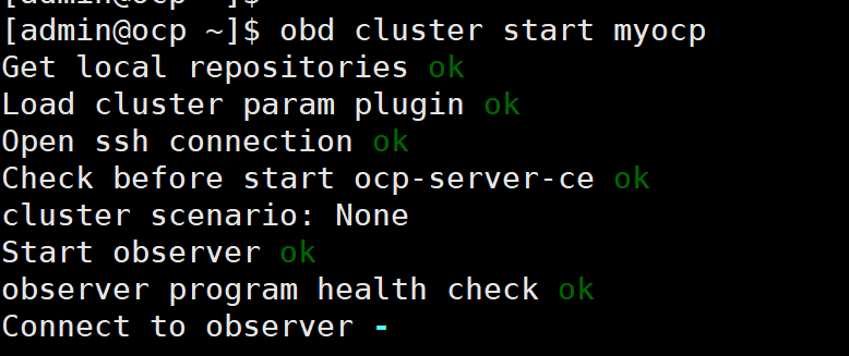

或者直接执行obd cluster start myocp 如果已经启动则会跳过

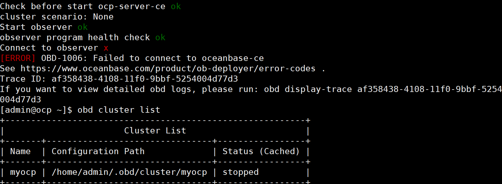

重启后就报错了,启动不了

metadb启动失败,提供一份详细的obd日志看看
重启后,一直卡这里,日志一直狂涮

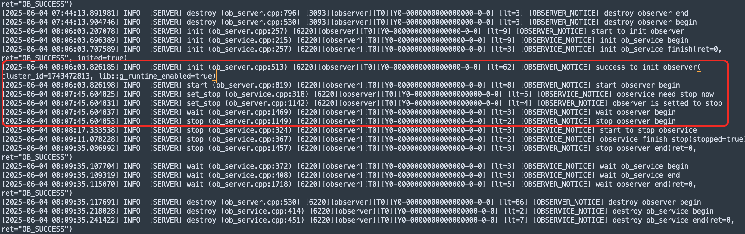

就是observer日志,cat observer.log* |grep "NOTICE"看看
现在全是重复,快速 涮这种日志
notice.log (6.4 KB)

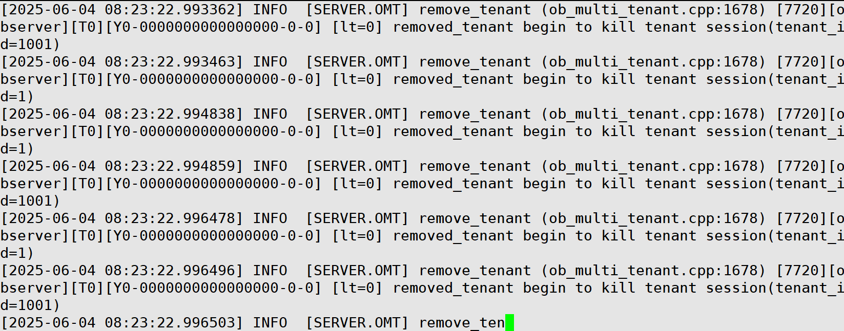

[2025-06-04 08:31:01.796874] INFO [SERVER.OMT] stop (ob_multi_tenant.cpp:593) [7720][observer][T0][Y0-0000000000000000-0-0] [lt=0] there’re some tenants need destroy(count=2)
[2025-06-04 08:31:01.797200] INFO [SERVER.OMT] stop (ob_multi_tenant.cpp:593) [7720][observer][T0][Y0-0000000000000000-0-0] [lt=0] there’re some tenants need destroy(count=2)
[2025-06-04 08:31:01.797363] INFO [SERVER.OMT] stop (ob_multi_tenant.cpp:593) [7720][observer][T0][Y0-0000000000000000-0-0] [lt=0] there’re some tenants need destroy(count=2)
[2025-06-04 08:31:01.797560] INFO [SERVER.OMT] stop (ob_multi_tenant.cpp:593) [7720][observer][T0][Y0-0000000000000000-0-0] [lt=0] there’re some tenants need destroy(count=2)
[2025-06-04 08:31:01.797756] INFO [SERVER.OMT] stop (ob_multi_tenant.cpp:593) [7720][observer][T0][Y0-0000000000000000-0-0] [lt=0] there’re some tenants need destroy(count=2)
[2025-06-04 08:31:01.797852] INFO [SERVER.OMT] stop (ob_multi_tenant.cpp:593) [7720][observer][T0][Y0-0000000000000000-0-0] [lt=0] there’re some tenants need destroy(count=2)
[2025-06-04 08:31:01.798014] INFO [SERVER.OMT] stop (ob_multi_tenant.cpp:593) [7720][observer][T0][Y0-0000000000000000-0-0] [lt=0] there’re some tenants need destroy(count=2)
[2025-06-04 08:31:01.798339] INFO [SERVER.OMT] stop (ob_multi_tenant.cpp:593) [7720][observer][T0][Y0-0000000000000000-0-0] [lt=0] there’re some tenants need destroy(count=2)
[2025-06-04 08:31:01.798963] INFO [SERVER.OMT] stop (ob_multi_tenant.cpp:593) [7720][observer][T0][Y0-0000000000000000-0-0] [lt=0] there’re some tenants need destroy(count=2)
[2025-06-04 08:31:01.798992] INFO [SERVER.OMT] stop (ob_multi_tenant.cpp:593) [7720][observer][T0][Y0-0000000000000000-0-0] [lt=0] there’re some tenants need destroy(count=2)
提供一下这个时间段的完整observer日志
