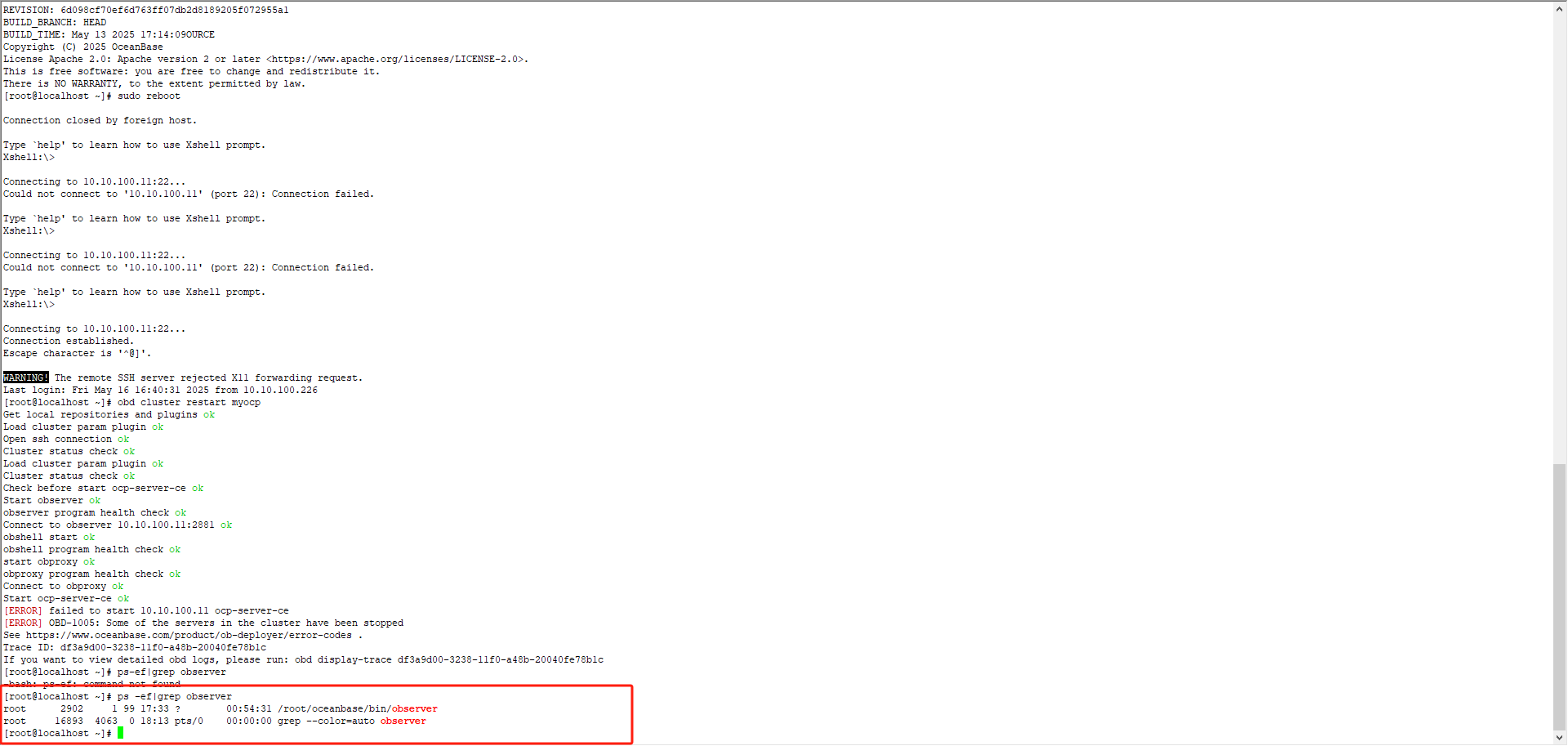

ps -ef|grep observer结果

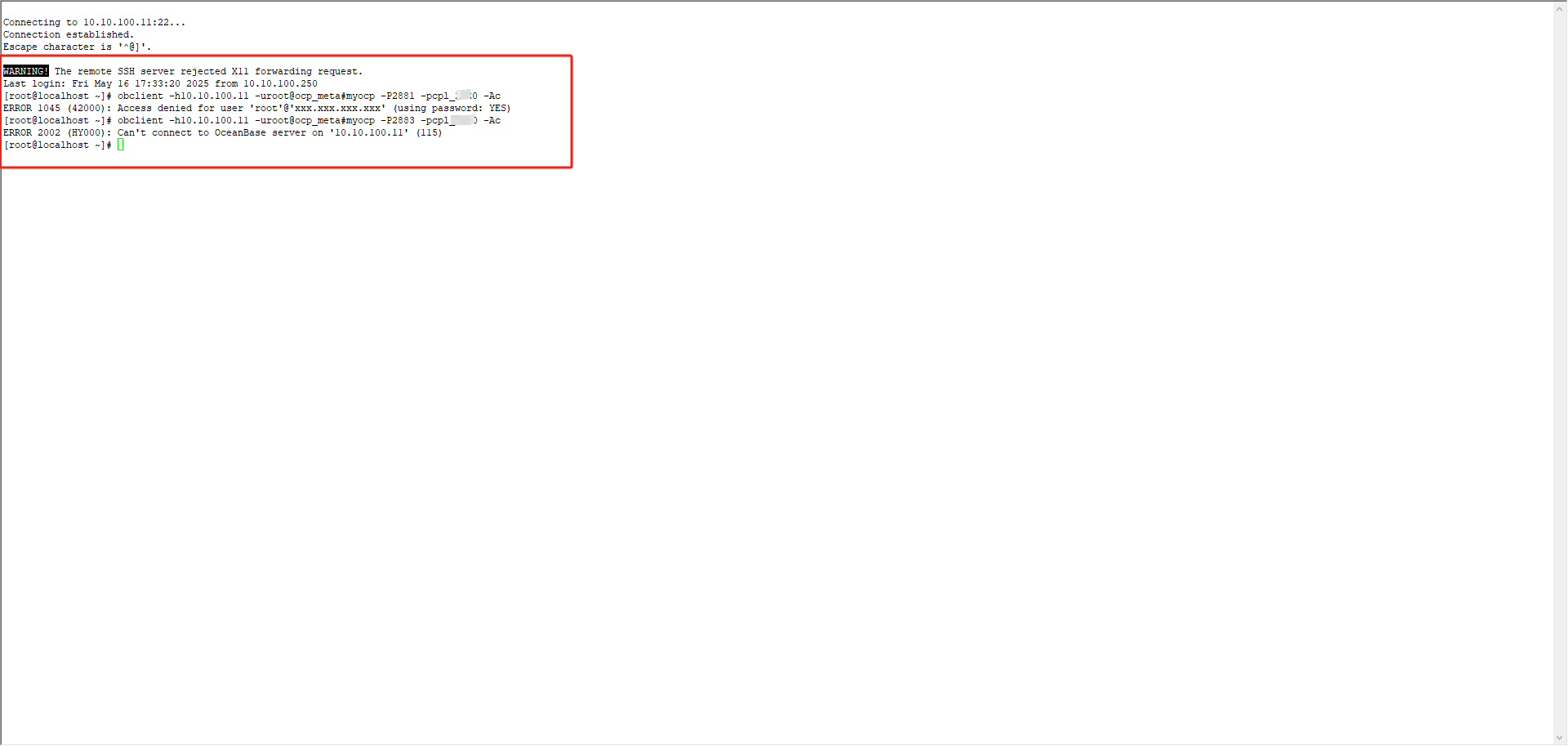

下面两个命令都连接不了呢
obclient -h10.10.100.11 -uroot@ocp_meta#myocp -P2881 -pcpl_xxxxx -Ac
obclient -h10.10.100.11 -uroot@ocp_meta#myocp -P2883 -pcpl_xxxxx -Ac
用obd3.2.2重启集群,也还是一样提示的1005错误码,我试试上面的脚本命令
不大好分析问题啊
老师您好,上面有重启失败的日志,这个能看出来是什么原因失败的吗

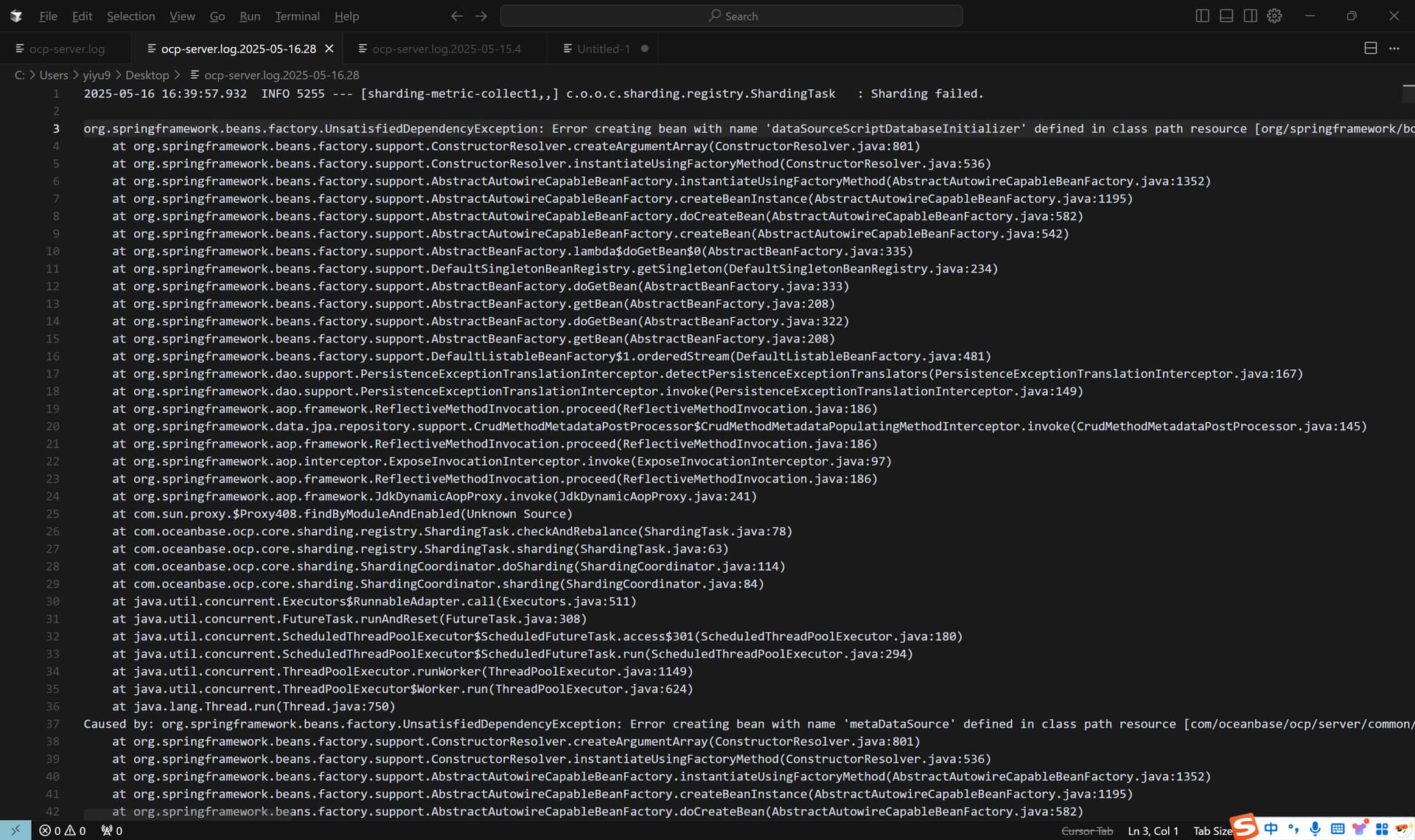

我刚才重新启动了一下ocp集群,还是没有启动成功,下面是ocp-server.log日志文件,我们目前的工作已经因为这个停摆了,急~麻烦官方帮我看看
ocp-server.rar (58.2 KB)
org.springframework.beans.factory.UnsatisfiedDependencyException: Error creating bean with name ‘dataSourceScriptDatabaseInitializer’ defined in class path resource [org/springframework/boot/autoconfigure/sql/init/DataSourceInitializationConfiguration.class]: Unsatisfied dependency expressed through method ‘dataSourceScriptDatabaseInitializer’ parameter 0; nested exception is org.springframework.beans.factory.UnsatisfiedDependencyException: Error creating bean with name ‘metaDataSource’ defined in class path resource [com/oceanbase/ocp/server/common/config/MetadbConfiguration.class]: Unsatisfied dependency expressed through method ‘metaDataSource’ parameter 0; nested exception is org.springframework.boot.context.properties.ConfigurationPropertiesBindException: Error creating bean with name ‘spring.datasource-org.springframework.boot.autoconfigure.jdbc.DataSourceProperties’: Could not bind properties to ‘DataSourceProperties’ : prefix=spring.datasource, ignoreInvalidFields=false, ignoreUnknownFields=true; nested exception is java.lang.IllegalStateException: org.springframework.context.annotation.AnnotationConfigApplicationContext@75db5df9 has been closed already
at org.springframework.beans.factory.support.ConstructorResolver.createArgumentArray(ConstructorResolver.java:801)
at org.springframework.beans.factory.support.ConstructorResolver.instantiateUsingFactoryMethod(ConstructorResolver.java:536)
at org.springframework.beans.factory.support.AbstractAutowireCapableBeanFactory.instantiateUsingFactoryMethod(AbstractAutowireCapableBeanFactory.java:1352)
at org.springframework.beans.factory.support.AbstractAutowireCapableBeanFactory.createBeanInstance(AbstractAutowireCapableBeanFactory.java:1195)
at org.springframework.beans.factory.support.AbstractAutowireCapableBeanFactory.doCreateBean(AbstractAutowireCapableBeanFactory.java:582)
at org.springframework.beans.factory.support.AbstractAutowireCapableBeanFactory.createBean(AbstractAutowireCapableBeanFactory.java:542)

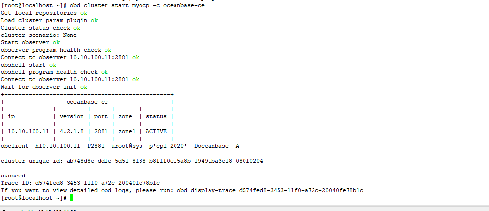

执行obd cluster start -c oceanbase-ce
看看能不能先拉起ob数据库
收到,我试下
您好,已执行,下面是执行的结果

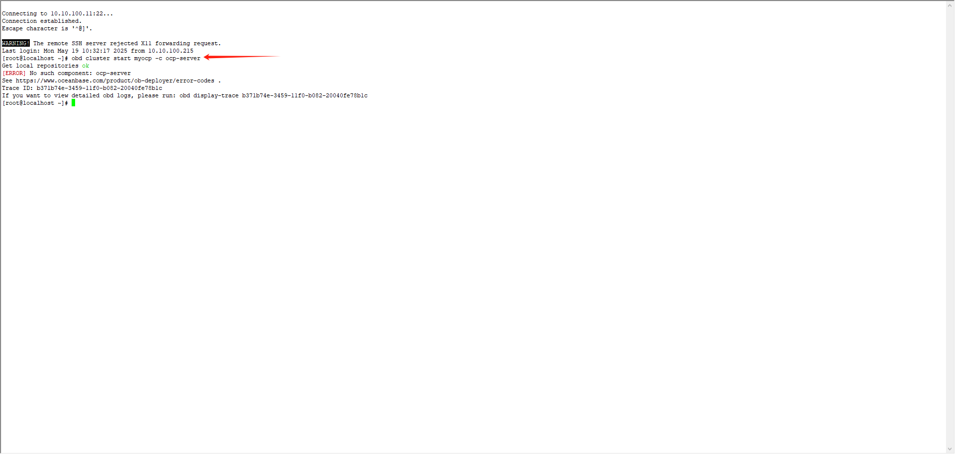

再启动ocp组件试试
您好,应该使用哪个账号做黑屏化登录呢,启动ocp组件的命令能否也帮我发一下,这些命令我还不熟悉
启动ocp组件的命令能否也帮我发一下 obd cluster start -c ocp-server

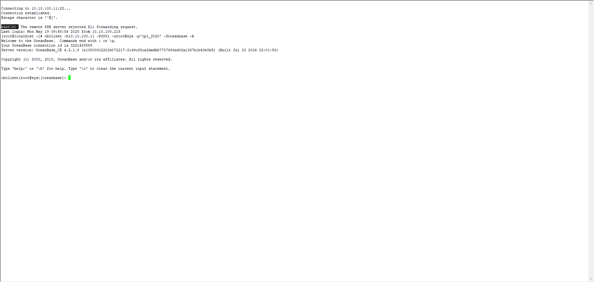

老师您好,黑屏化登录结果:
启动ocp组件执行结果:
