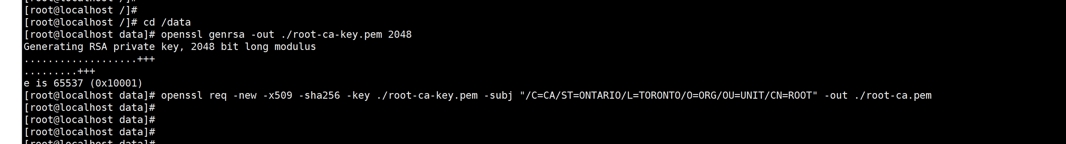

生成了证书

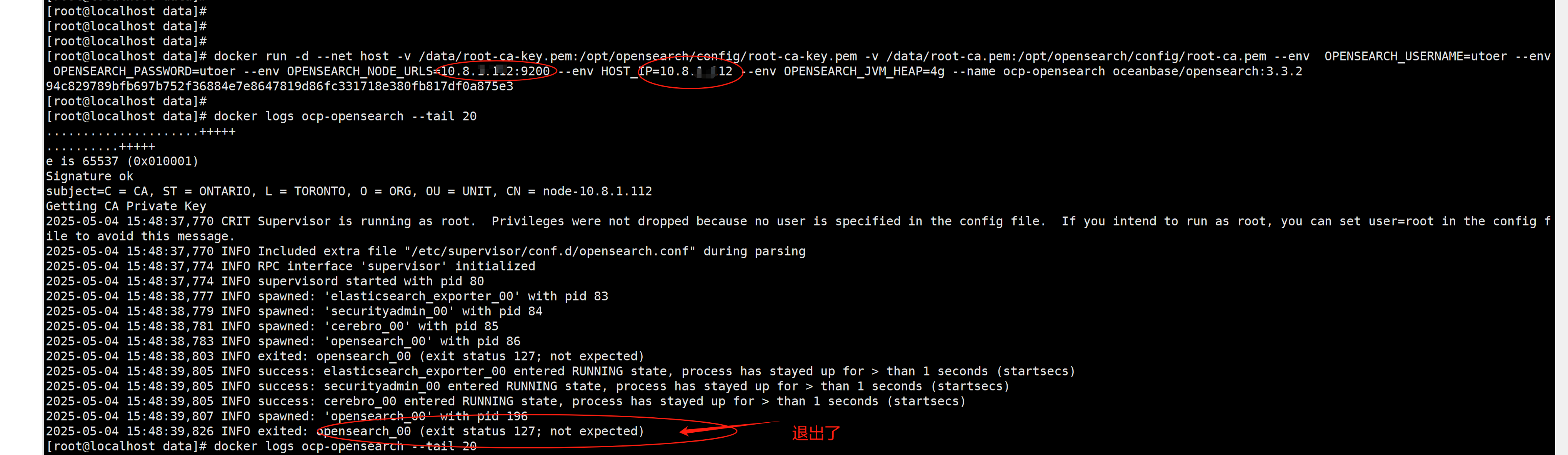

启动容器失败
容器日志如下
[root@localhost data]# docker logs ocp-opensearch --tail 20
e is 65537 (0x010001)
Signature ok
subject=C = CA, ST = ONTARIO, L = TORONTO, O = ORG, OU = UNIT, CN = node-10.8.1.112
Getting CA Private Key
2025-05-04 15:48:37,770 CRIT Supervisor is running as root.  Privileges were not dropped because no user is specified in the config file.  If you intend to run as root, you can set user=root in the config file to avoid this message.
2025-05-04 15:48:37,770 INFO Included extra file "/etc/supervisor/conf.d/opensearch.conf" during parsing
2025-05-04 15:48:37,774 INFO RPC interface 'supervisor' initialized
2025-05-04 15:48:37,774 INFO supervisord started with pid 80
2025-05-04 15:48:38,777 INFO spawned: 'elasticsearch_exporter_00' with pid 83
2025-05-04 15:48:38,779 INFO spawned: 'securityadmin_00' with pid 84
2025-05-04 15:48:38,781 INFO spawned: 'cerebro_00' with pid 85
2025-05-04 15:48:38,783 INFO spawned: 'opensearch_00' with pid 86
2025-05-04 15:48:38,803 INFO exited: opensearch_00 (exit status 127; not expected)
2025-05-04 15:48:39,805 INFO success: elasticsearch_exporter_00 entered RUNNING state, process has stayed up for > than 1 seconds (startsecs)
2025-05-04 15:48:39,805 INFO success: securityadmin_00 entered RUNNING state, process has stayed up for > than 1 seconds (startsecs)
2025-05-04 15:48:39,805 INFO success: cerebro_00 entered RUNNING state, process has stayed up for > than 1 seconds (startsecs)
2025-05-04 15:48:39,807 INFO spawned: 'opensearch_00' with pid 196
2025-05-04 15:48:39,826 INFO exited: opensearch_00 (exit status 127; not expected)
但从信息中看不出啥问题来啊
