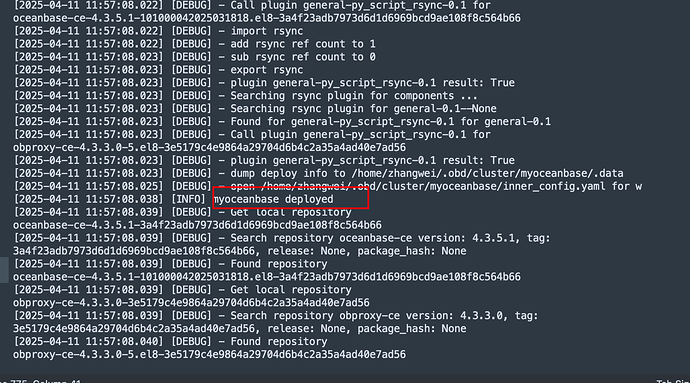

我这边重新部署了一次 这次OBProxy成功了 但是OceanBase DataBase报以下错误

[2025-04-11 14:53:01.422] [DEBUG] - Get deploy config
[2025-04-11 14:53:01.422] [INFO] Load cluster param plugin
[2025-04-11 14:53:01.422] [DEBUG] - Get local repository oceanbase-ce-4.3.5.1-3a4f23adb7973d6d1d6969bcd9ae108f8c564b66
[2025-04-11 14:53:01.423] [DEBUG] - Get local repository obproxy-ce-4.3.3.0-3e5179c4e9864a29704d6b4c2a35a4ad40e7ad56
[2025-04-11 14:53:01.423] [DEBUG] - Searching param plugin for components …
[2025-04-11 14:53:01.423] [DEBUG] - Search param plugin for oceanbase-ce
[2025-04-11 14:53:01.424] [DEBUG] - Found for oceanbase-ce-param-4.3.3.0 for oceanbase-ce-4.3.5.1
[2025-04-11 14:53:01.424] [DEBUG] - Applying oceanbase-ce-param-4.3.3.0 for oceanbase-ce-4.3.5.1-101000042025031818.el8-3a4f23adb7973d6d1d6969bcd9ae108f8c564b66
[2025-04-11 14:53:01.424] [DEBUG] - Search param plugin for obproxy-ce
[2025-04-11 14:53:01.425] [DEBUG] - Found for obproxy-ce-param-4.3.0 for obproxy-ce-4.3.3.0
[2025-04-11 14:53:01.425] [DEBUG] - Applying obproxy-ce-param-4.3.0 for obproxy-ce-4.3.3.0-5.el8-3e5179c4e9864a29704d6b4c2a35a4ad40e7ad56
[2025-04-11 14:53:01.425] [DEBUG] - Searching start_check template for components …
[2025-04-11 14:53:01.425] [DEBUG] - Call workflow oceanbase-ce-py_script_workflow_start_check-4.3.0.0 for oceanbase-ce-4.3.5.1-101000042025031818.el8-3a4f23adb7973d6d1d6969bcd9ae108f8c564b66
[2025-04-11 14:53:01.426] [DEBUG] - plugin oceanbase-ce-py_script_workflow_start_check-4.3.0.0 result: True
[2025-04-11 14:53:01.426] [DEBUG] - Found for oceanbase-ce-py_script_workflow_start_check-4.3.0.0 for oceanbase-ce-4.3.0.0
[2025-04-11 14:53:01.426] [DEBUG] - Searching start_check_pre plugin for components …
[2025-04-11 14:53:01.426] [DEBUG] - Searching start_check_pre plugin for oceanbase-ce-4.3.5.1-101000042025031818.el8-3a4f23adb7973d6d1d6969bcd9ae108f8c564b66
[2025-04-11 14:53:01.426] [DEBUG] - Found for oceanbase-ce-py_script_start_check_pre-4.3.0.0 for oceanbase-ce-4.3.5.1
[2025-04-11 14:53:01.426] [DEBUG] - Call plugin oceanbase-ce-py_script_start_check_pre-4.3.0.0 for oceanbase-ce-4.3.5.1-101000042025031818.el8-3a4f23adb7973d6d1d6969bcd9ae108f8c564b66
[2025-04-11 14:53:01.428] [DEBUG] - plugin oceanbase-ce-py_script_start_check_pre-4.3.0.0 result: True
[2025-04-11 14:53:01.428] [DEBUG] - Searching status_check plugin for components …
[2025-04-11 14:53:01.428] [DEBUG] - Searching status_check plugin for oceanbase-ce-4.3.5.1-101000042025031818.el8-3a4f23adb7973d6d1d6969bcd9ae108f8c564b66
[2025-04-11 14:53:01.428] [DEBUG] - Found for oceanbase-ce-py_script_status_check-4.2.1.4 for oceanbase-ce-4.3.5.1
[2025-04-11 14:53:01.428] [DEBUG] - Call plugin oceanbase-ce-py_script_status_check-4.2.1.4 for oceanbase-ce-4.3.5.1-101000042025031818.el8-3a4f23adb7973d6d1d6969bcd9ae108f8c564b66
[2025-04-11 14:53:01.428] [DEBUG] – zhangwei@10.0.0.131 execute: ls /home/zhangwei/myoceanbase/oceanbase/store/clog/tenant_1/
[2025-04-11 14:53:01.442] [DEBUG] – exited code 2, error output:
[2025-04-11 14:53:01.442] [DEBUG] ls: 无法访问 ‘/home/zhangwei/myoceanbase/oceanbase/store/clog/tenant_1/’: 没有那个文件或目录
[2025-04-11 14:53:01.443] [DEBUG] – zhangwei@10.0.0.131 execute: cat /home/zhangwei/myoceanbase/oceanbase/run/observer.pid
[2025-04-11 14:53:01.493] [DEBUG] – exited code 1, error output:
[2025-04-11 14:53:01.494] [DEBUG] cat: /home/zhangwei/myoceanbase/oceanbase/run/observer.pid: 没有那个文件或目录
[2025-04-11 14:53:01.495] [DEBUG] – zhangwei@10.0.0.132 execute: ls /home/zhangwei/myoceanbase/oceanbase/store/clog/tenant_1/
[2025-04-11 14:53:01.507] [DEBUG] – exited code 2, error output:
[2025-04-11 14:53:01.507] [DEBUG] ls: 无法访问 ‘/home/zhangwei/myoceanbase/oceanbase/store/clog/tenant_1/’: 没有那个文件或目录
[2025-04-11 14:53:01.508] [DEBUG] – zhangwei@10.0.0.132 execute: cat /home/zhangwei/myoceanbase/oceanbase/run/observer.pid
[2025-04-11 14:53:01.562] [DEBUG] – exited code 1, error output:
[2025-04-11 14:53:01.562] [DEBUG] cat: /home/zhangwei/myoceanbase/oceanbase/run/observer.pid: 没有那个文件或目录
[2025-04-11 14:53:01.563] [DEBUG] - plugin oceanbase-ce-py_script_status_check-4.2.1.4 result: True
[2025-04-11 14:53:01.563] [DEBUG] - Searching parameter_check plugin for components …
[2025-04-11 14:53:01.563] [DEBUG] - Searching parameter_check plugin for oceanbase-ce-4.3.5.1-101000042025031818.el8-3a4f23adb7973d6d1d6969bcd9ae108f8c564b66
[2025-04-11 14:53:01.563] [DEBUG] - Found for oceanbase-ce-py_script_parameter_check-4.0.0.0 for oceanbase-ce-4.3.5.1
[2025-04-11 14:53:01.564] [DEBUG] - Call plugin oceanbase-ce-py_script_parameter_check-4.0.0.0 for oceanbase-ce-4.3.5.1-101000042025031818.el8-3a4f23adb7973d6d1d6969bcd9ae108f8c564b66
[2025-04-11 14:53:01.565] [DEBUG] – zhangwei@10.0.0.131 execute: ls /home/zhangwei/myoceanbase/oceanbase/store/sstable/block_file
[2025-04-11 14:53:01.571] [DEBUG] – exited code 2, error output:
[2025-04-11 14:53:01.571] [DEBUG] ls: 无法访问 ‘/home/zhangwei/myoceanbase/oceanbase/store/sstable/block_file’: 没有那个文件或目录
[2025-04-11 14:53:01.573] [DEBUG] – zhangwei@10.0.0.132 execute: ls /home/zhangwei/myoceanbase/oceanbase/store/sstable/block_file
[2025-04-11 14:53:01.610] [DEBUG] – exited code 2, error output:
[2025-04-11 14:53:01.610] [DEBUG] ls: 无法访问 ‘/home/zhangwei/myoceanbase/oceanbase/store/sstable/block_file’: 没有那个文件或目录
[2025-04-11 14:53:01.611] [DEBUG] - plugin oceanbase-ce-py_script_parameter_check-4.0.0.0 result: True
[2025-04-11 14:53:01.611] [DEBUG] - Searching system_limits_check plugin for components …
[2025-04-11 14:53:01.611] [DEBUG] - Searching system_limits_check plugin for oceanbase-ce-4.3.5.1-101000042025031818.el8-3a4f23adb7973d6d1d6969bcd9ae108f8c564b66
[2025-04-11 14:53:01.612] [DEBUG] - Found for oceanbase-ce-py_script_system_limits_check-3.1.0 for oceanbase-ce-4.3.5.1
[2025-04-11 14:53:01.612] [DEBUG] - Call plugin oceanbase-ce-py_script_system_limits_check-3.1.0 for oceanbase-ce-4.3.5.1-101000042025031818.el8-3a4f23adb7973d6d1d6969bcd9ae108f8c564b66
[2025-04-11 14:53:01.612] [DEBUG] – zhangwei@10.0.0.131 execute: cat /proc/sys/fs/aio-max-nr /proc/sys/fs/aio-nr
[2025-04-11 14:53:01.643] [DEBUG] – exited code 0
[2025-04-11 14:53:01.644] [WARNING] OBD-1011: (10.0.0.131) The recommended value of fs.aio-max-nr is 1048576 (Current value: 65536)
[2025-04-11 14:53:01.644] [DEBUG] – zhangwei@10.0.0.131 execute: ulimit -a
[2025-04-11 14:53:01.693] [DEBUG] – exited code 0
[2025-04-11 14:53:01.694] [DEBUG] – zhangwei@10.0.0.131 execute: sysctl -a
[2025-04-11 14:53:01.773] [DEBUG] – exited code 0
[2025-04-11 14:53:01.777] [WARNING] OBD-1017: (10.0.0.131) The value of the “vm.max_map_count” must be within [327600, 1310720] (Current value: 262144, Recommended value: 655360)
[2025-04-11 14:53:01.777] [DEBUG] – zhangwei@10.0.0.132 execute: cat /proc/sys/fs/aio-max-nr /proc/sys/fs/aio-nr
[2025-04-11 14:53:01.784] [DEBUG] – exited code 0
[2025-04-11 14:53:01.785] [WARNING] OBD-1011: (10.0.0.132) The recommended value of fs.aio-max-nr is 1048576 (Current value: 65536)
[2025-04-11 14:53:01.786] [DEBUG] – zhangwei@10.0.0.132 execute: ulimit -a
[2025-04-11 14:53:01.836] [DEBUG] – exited code 0
[2025-04-11 14:53:01.837] [DEBUG] – zhangwei@10.0.0.132 execute: sysctl -a
[2025-04-11 14:53:01.918] [DEBUG] – exited code 0
[2025-04-11 14:53:01.920] [WARNING] OBD-1017: (10.0.0.132) The value of the “vm.max_map_count” must be within [327600, 1310720] (Current value: 262144, Recommended value: 655360)
[2025-04-11 14:53:01.921] [DEBUG] - plugin oceanbase-ce-py_script_system_limits_check-3.1.0 result: True
[2025-04-11 14:53:01.921] [DEBUG] - Searching resource_check plugin for components …
[2025-04-11 14:53:01.921] [DEBUG] - Searching resource_check plugin for oceanbase-ce-4.3.5.1-101000042025031818.el8-3a4f23adb7973d6d1d6969bcd9ae108f8c564b66
[2025-04-11 14:53:01.921] [DEBUG] - Found for oceanbase-ce-py_script_resource_check-4.0.0.0 for oceanbase-ce-4.3.5.1
[2025-04-11 14:53:01.921] [DEBUG] - Call plugin oceanbase-ce-py_script_resource_check-4.0.0.0 for oceanbase-ce-4.3.5.1-101000042025031818.el8-3a4f23adb7973d6d1d6969bcd9ae108f8c564b66
[2025-04-11 14:53:01.921] [DEBUG] – zhangwei@10.0.0.131 execute: cat /proc/meminfo
[2025-04-11 14:53:01.928] [DEBUG] – exited code 0
[2025-04-11 14:53:01.929] [ERROR] OBD-2000: (10.0.0.131) not enough memory. (Free: 967M, Buff/Cache: 5G, Need: 9G), Please reduce the memory_limit or memory_limit_percentage

[ERROR] Another app is currently holding the obd lock. 怎么报这个错 obd还在运行什么吗?
ps -ef | grep obd | grep -v grep
zhangwei@zhangwei-PC:~$ ps -ef | grep obd | grep -v grep
grep: |: 没有那个文件或目录
grep: grep: 没有那个文件或目录
这个目录没有
obd就运着那个白屏部署向导
关闭了 如果运行失败 也要关闭 要不然再去部署的时候 会有问题 如果重新部署 重新打开obd web界面

我是按照这个文档来部署的
上面那个日志的报错是obd web部署OceanBase Database
组件失败的日志
重新白屏化部署就行 内存建议给大点 日志盘和data盘尽量不要同盘
如果内存小 不要选那么多组件安装 建议只安装一个ob数据库就行
