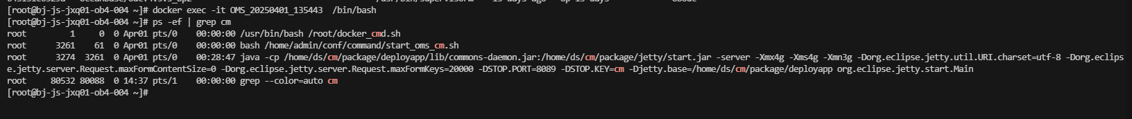

[root@sharding16-ocp ~]# ps -ef| grep cm
root 1 0 0 Apr07 ? 00:00:00 /usr/bin/bash /root/docker_cmd.sh
root 43 38 0 Apr07 ? 00:00:00 bash /home/admin/conf/command/start_oms_cm.sh
root 91 43 0 Apr07 ? 00:07:02 java -cp /home/ds/cm/package/deployapp/lib/commons-daemon.jar:/home/ds/cm/package/jetty/start.jar -server -Xmx4g -Xms4g -Xmn3g -Dorg.eclipse.jetty.util.URI.charset=utf-8 -Dorg.eclipse.jetty.server.Request.maxFormContentSize=0 -Dorg.eclipse.jetty.server.Request.maxFormKeys=20000 -DSTOP.PORT=8089 -DSTOP.KEY=cm -Djetty.base=/home/ds/cm/package/deployapp org.eclipse.jetty.start.Main
进入docker里面 看看这些资源呢 ?
启动时候 分配了4GB 资源
你全都变大 , 看看有改善不
