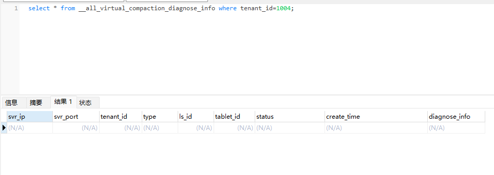

1、系统租户下,通过查看CDB_OB_MAJOR_COMPACTION视图
2、select * from __all_virtual_compaction_diagnose_info where tenant_id=1004;

select * from __all_virtual_dag_warning_history where tenant_id=1;
select * from __all_virtual_dag_warning_history where tenant_id=1003;

没有1003这个租户啊
