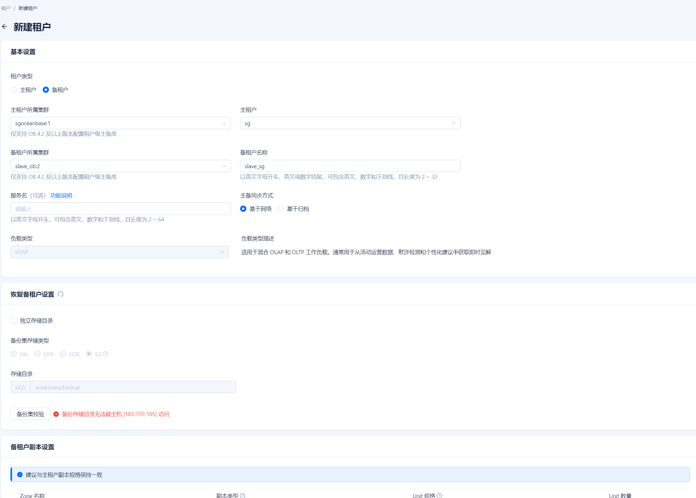

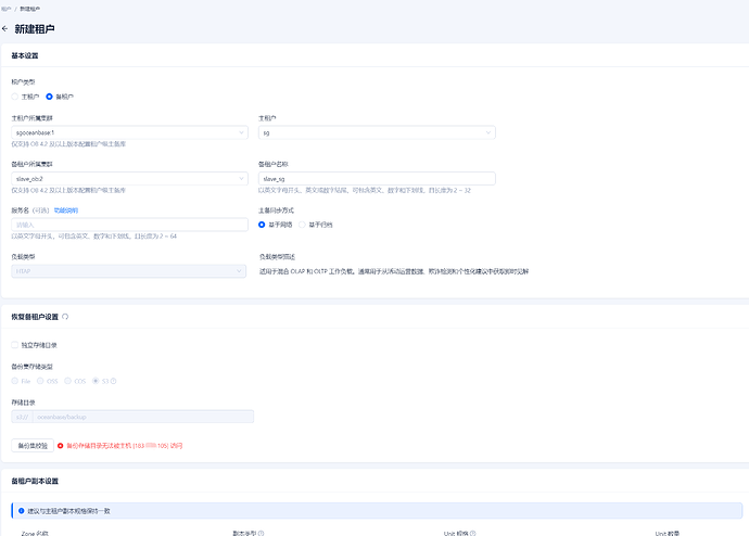

OCP 创建备租户,提示`备份存储目录无法被主机 [xx.xx.xx.xxx] 访问`
【 OB or 其他组件 】OCP
【 使用版本 】 4.3.3-20241219140415 CE

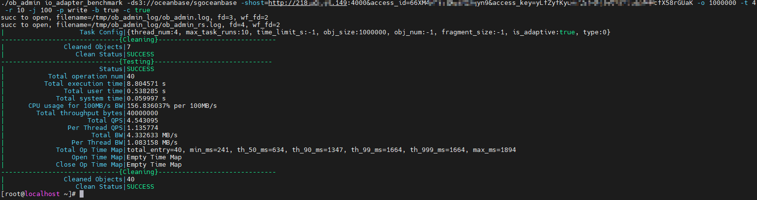

【问题描述】OBS 版本为4.3.4.1;OCP 创建备租户,提示备份存储目录无法被主机 [xx.xx.xx.xxx] 访问;通过 ob_admin io_adapter_benchmark 命令测试,该节点是可以访问S3存储路径的;

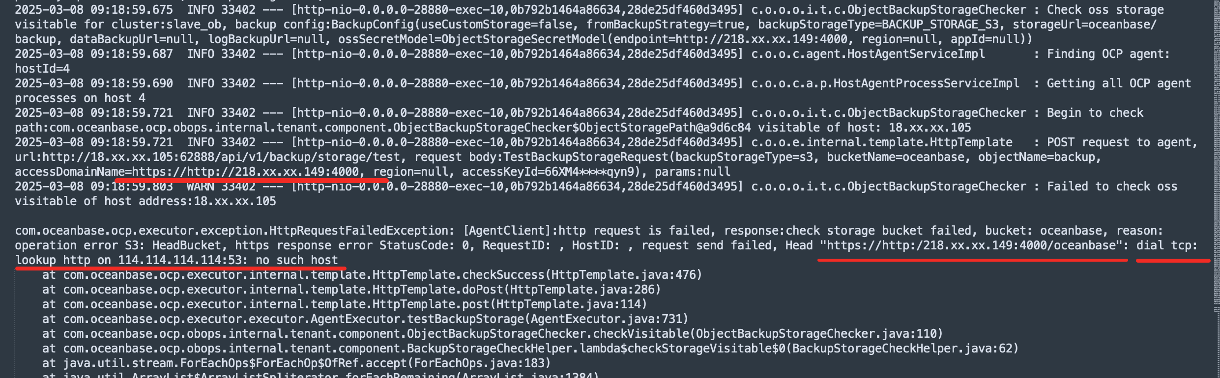

查看OCP 日志,看到拼接的S3 域为:accessDomainName=https://http://218.xx.xx.149:4000;
截取部分日志如下(部分信息已做脱敏处理):
2025-03-08 10:12:30.201  INFO 33402 --- [http-nio-0.0.0.0-28880-exec-8,55b0420d79a79831,8a793e22d42ad94d] c.o.o.e.internal.template.HttpTemplate   : POST request to agent, url:http://183.xx.xx.105:62888/api/v1/backup/storage/test, request body:TestBackupStorageRequest(backupStorageType=s3, bucketName=oceanbase, objectName=backup, accessDomainName=https://http://218.xx.xx.149:4000, region=null, accessKeyId=66XM**qyn9), params:null
2025-03-08 10:12:30.283  WARN 33402 --- [http-nio-0.0.0.0-28880-exec-8,55b0420d79a79831,8a793e22d42ad94d] c.o.o.o.i.t.c.ObjectBackupStorageChecker : Failed to check oss visitable of host address:183.xx.xx.105
com.oceanbase.ocp.executor.exception.HttpRequestFailedException: [AgentClient]:http request is failed, response:check storage bucket failed, bucket: oceanbase, reason: operation error S3: HeadBucket, https response error StatusCode: 0, RequestID: , HostID: , request send failed, Head "https://http:/218.xx.xx.149:4000/oceanbase": dial tcp: lookup http on 114.114.114.114:53: no such host
        at com.oceanbase.ocp.executor.internal.template.HttpTemplate.checkSuccess(HttpTemplate.java:476)

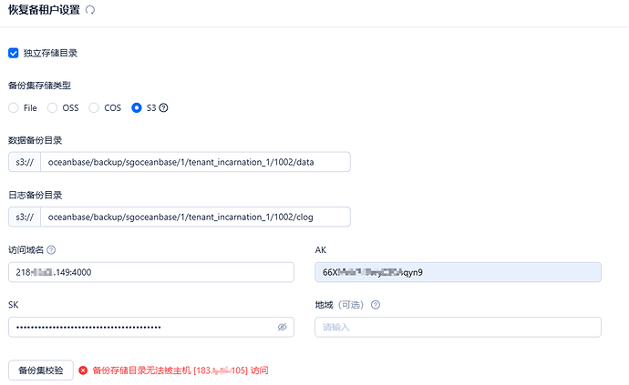

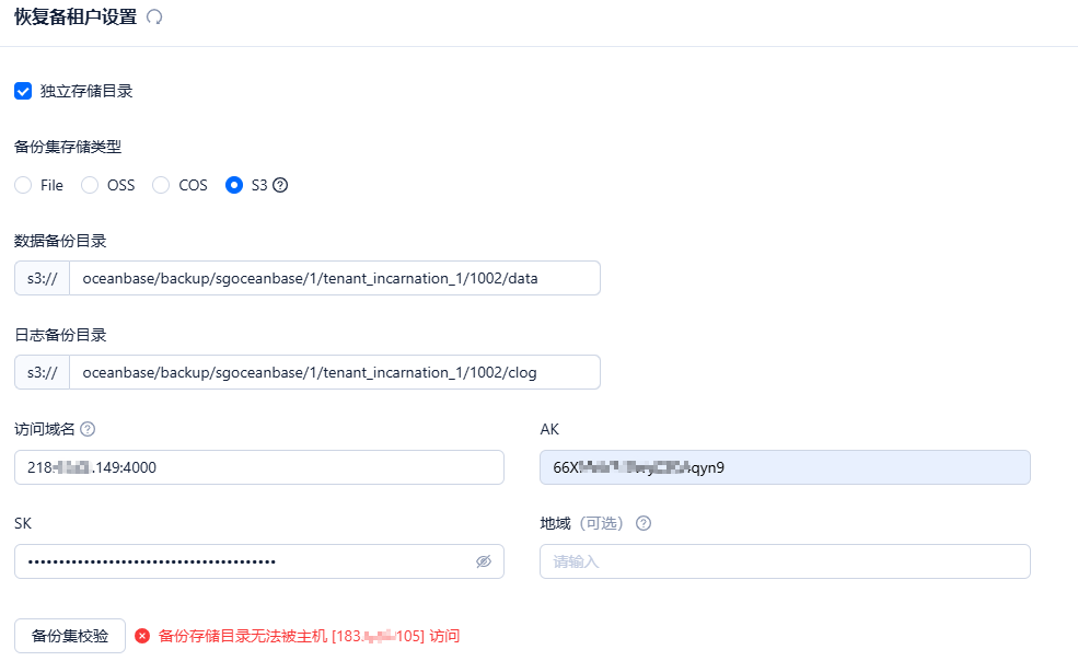

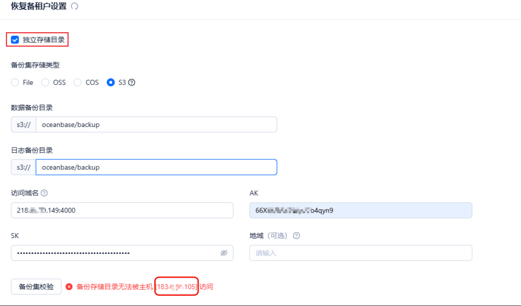

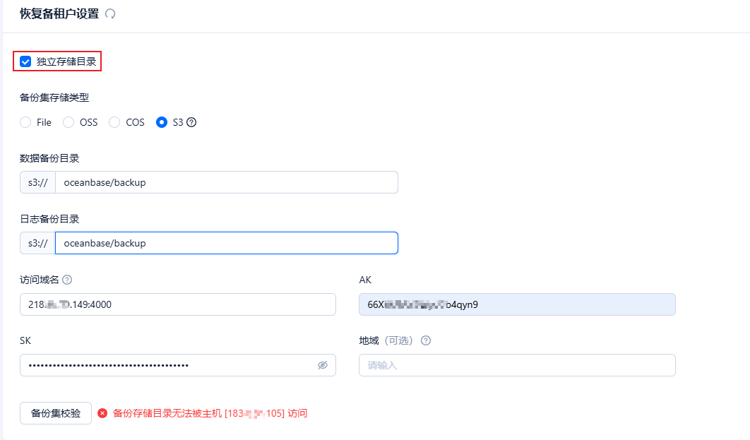

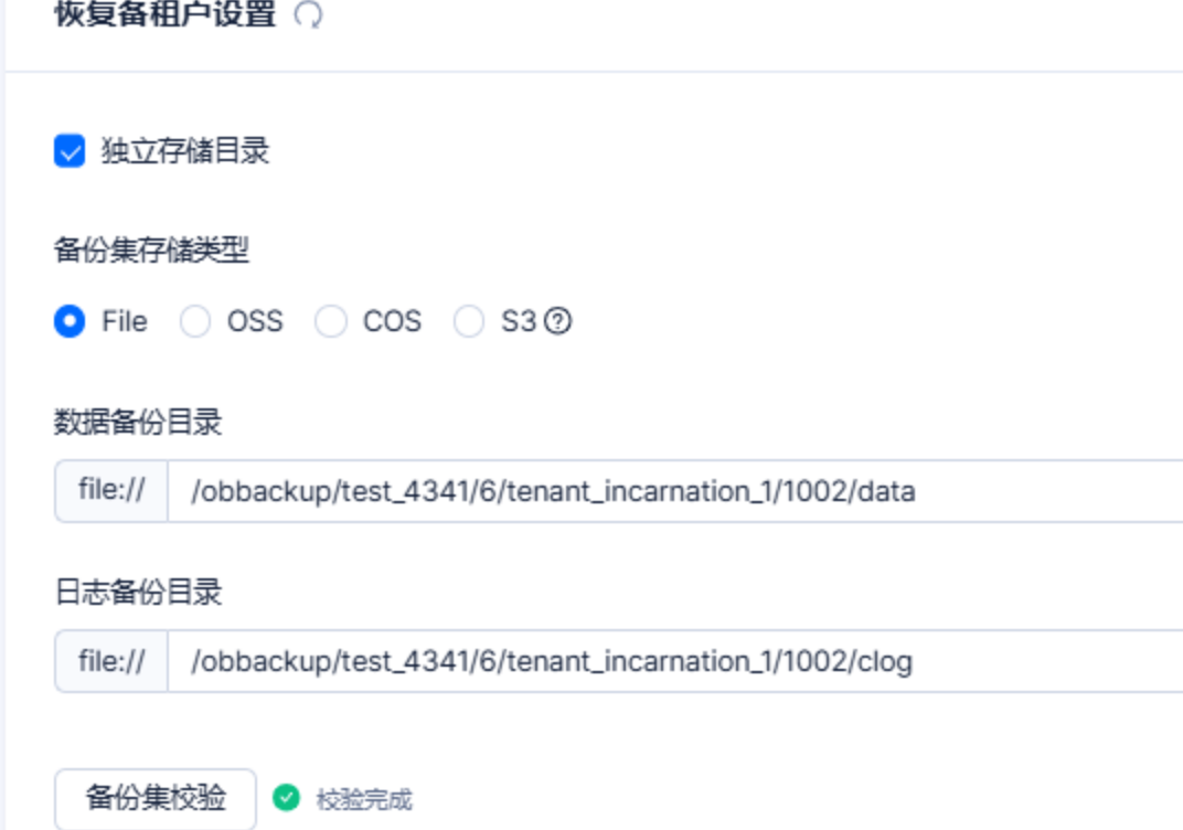

勾选独立存储目录,自行填入S3域,日志不再报 no such host 错误,OCP页面仍提示备份存储目录无法被主机 [xx.xx.xx.xxx] 访问

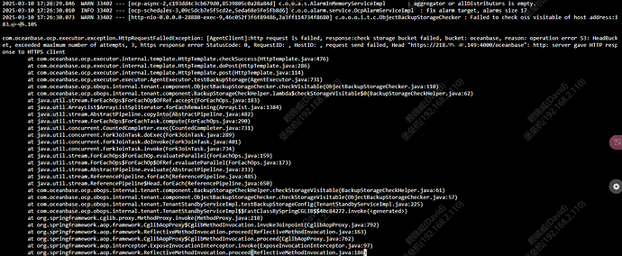

日志中报错:Failed to check oss visitable of host address:183.xx.xx.105
截取部分日志如下:

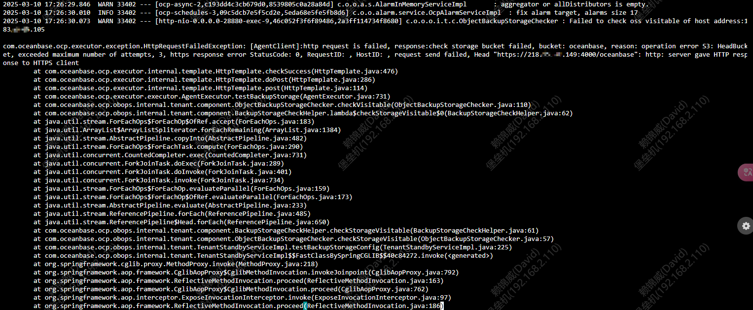

2025-03-08 10:42:38.109  WARN 33402 --- [http-nio-0.0.0.0-28880-exec-8,cd2ff14bb2b45570,0ea278e81860a9ee] c.o.o.o.i.t.c.ObjectBackupStorageChecker : Failed to check oss visitable of host address:183.xx.xx.105
com.oceanbase.ocp.executor.exception.HttpRequestFailedException: [AgentClient]:http request is failed, response:check storage bucket failed, bucket: oceanbase, reason: operation error S3: HeadBucket, exceeded maximum number of attempts, 3, https response error StatusCode: 0, RequestID: , HostID: , request send failed, Head "https://218.xx.xx.149:4000/oceanbase": http: server gave HTTP response to HTTPS client

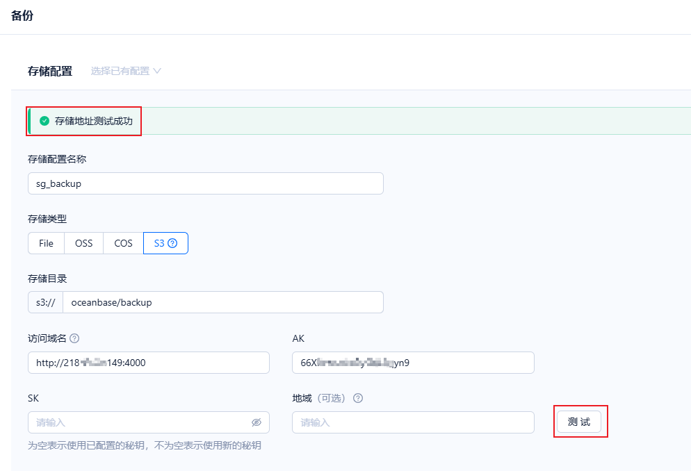

跟主租户的备份策略的路径、AK、SK 是一样的,下图是主租户的备份策略的存储配置

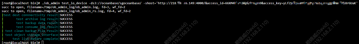

在预备建备租户的节点上测试也能连得上

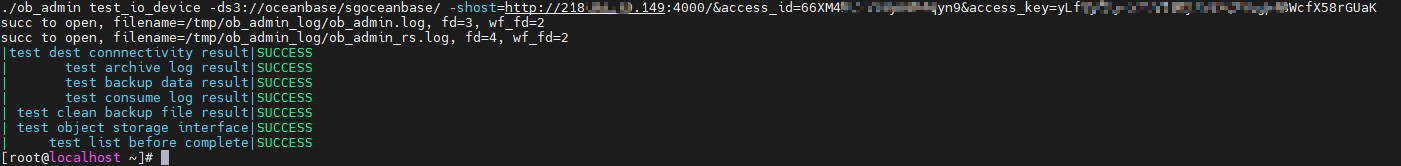

另外在这个主机上ob_admin test_io_device测试正常吗?
是的,日志里面确实是有两个http://
该节点上 ob_admin test_io_device 测试正常

  2. 选择独立存储目录,把具体的主租户数据备份目录(/data)、归档目录(/clog) 填到输入框里,类似
勾选独立存储目录可以选择S3类型吗?
我这边测试也是无法访问
再次确认了下目前OCP创建备租户不支持 http 协议访问 S3/COS,仅支持https协议,本周预计发布 OCP 4.3.5 bp1,会增加对 http 协议的支持
