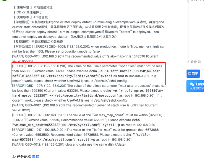

【 使用环境 】本地测试环境
【 使用版本 】4.2社区版
【问题描述】安装部署时执行obd cluster deploy obtest -c mini-single-example.yaml成功后,再运行obd cluster start obtest报错,具体报错参见下面日志,应该是配置文件有错误,配置文件修改成开发模式后再次运行obd cluster deploy obtest -c mini-single-example.yaml报错Deploy “obtest” is deployed,You could not deploy an deployed cluster,怎么重新加载配置文件让其生效?
【附件及日志】[ERROR] OBD-2009: (192.168.0.201): when production_mode is True, memory_limit can not be less then 16G, Please set production_mode to false
[WARN] OBD-1011: (192.168.0.201) The recommended value of fs.aio-max-nr is 1048576 (Current value: 65536)
[ERROR] OBD-1007: (192.168.0.201) The value of the ulimit parameter “open files” must not be less than 655350 (Current value: 1024), Please execute echo -e "* soft nofile 655350\n* hard nofile 655350" >> /etc/security/limits.d/nofile.conf as root in 192.168.0.201. if it dosen’t work, please check whether UsePAM is yes in /etc/ssh/sshd_config.
[ERROR] OBD-1007: (192.168.0.201) The value of the ulimit parameter “max user processes” must not be less than 655350 (Current value: 63336), Please execute echo -e "* soft nproc 655350\n* hard nproc 655350" >> /etc/security/limits.d/nproc.conf as root in 192.168.0.201. if it dosen’t work, please check whether UsePAM is yes in /etc/ssh/sshd_config.
[WARN] OBD-1007: (192.168.0.201) The recommended number of stack size is unlimited (Current value: 8192)
[ERROR] OBD-1017: (192.168.0.201) The value of the “vm.max_map_count” must be within [327600, 1310720] (Current value: 65530, Recommended value: 655360), Please execute echo "vm.max_map_count=655360" >> /etc/sysctl.conf; sysctl -p as root in 192.168.0.201.
[ERROR] OBD-1017: (192.168.0.201) The value of the “fs.file-max” must be greater than 6573688 (Current value: 6553500, Recommended value: 6573688), Please execute echo "fs.file-max=6573688" >> /etc/sysctl.conf; sysctl -p as root in 192.168.0.201.
[WARN] OBD-1012: (192.168.0.201) clog and data use the same disk (/data)
