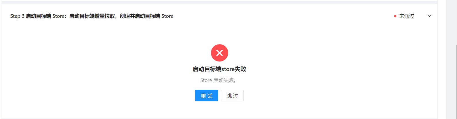

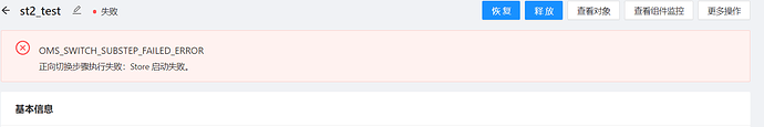

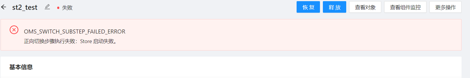

源端数据总共1272行,三张表,当结束正向同步启动反向同步时,报以下错误
日志报错
com.oceanbase.oms.cm.client.exception.CmServerException: CM response not success.
|- Supervisor failed to execute command: pull 192.168.128.210 log error. msg: Supervisor failed to pull 192.168.128.210 log. msg: not found file path:/home/ds/store/store7100/log/liboblog.log reason: Supervisor failed to pull 192.168.128.210 log. msg: not found file path:/home/ds/store/store7100/log/liboblog.log
在/home/ds/store/store7100/log/目录下,确实无liboblog.log日志

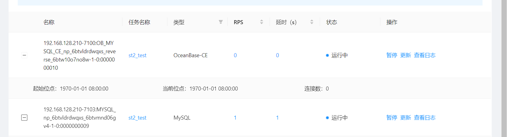

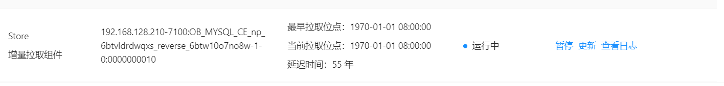

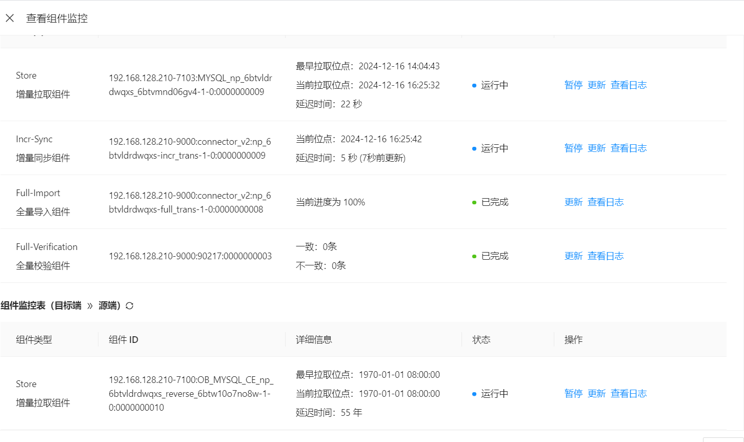

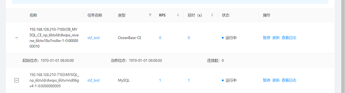

你把oms组件监控 截图看看
3.x是这个文件 liboblog.log
obstore(源库是4.x)目前是这个日志文件 libobcdc.log

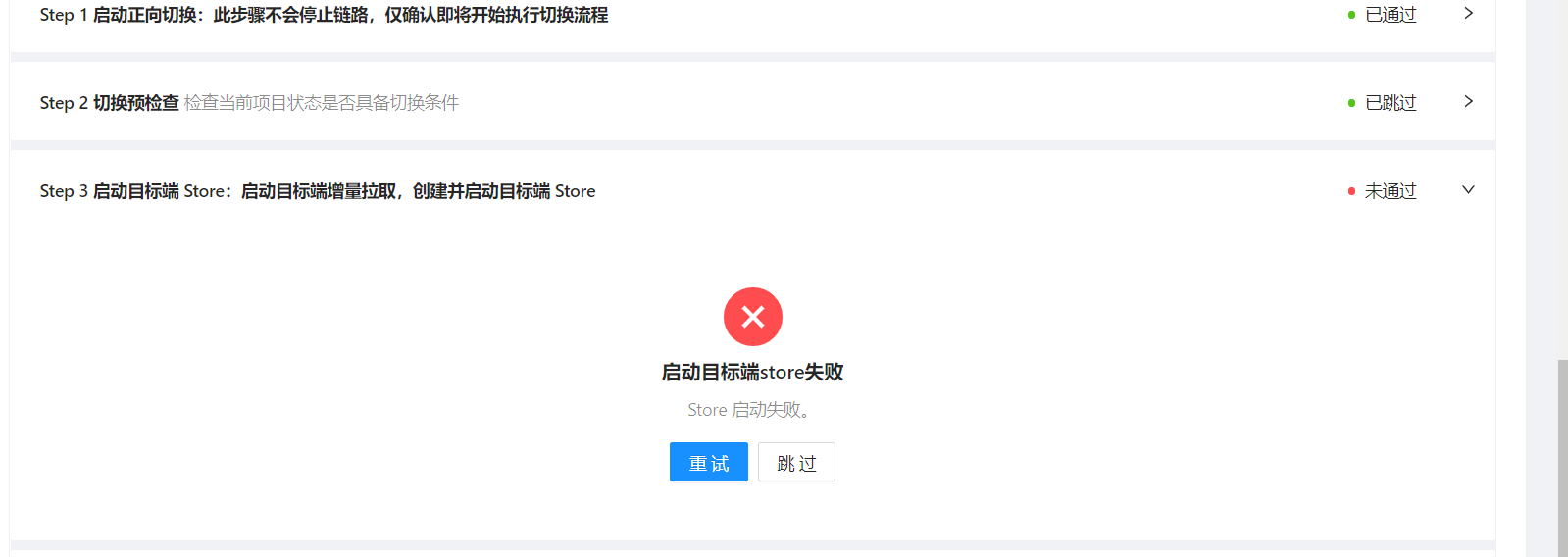

组件的名称怎么看不到呀 是增量拉取么?截图可以截取全点 如果好是 发一下这个文件 libobcdc.log
text (3).log (228.5 KB)
是的,到启动增量米标段增量拉去,创建并驱动目标端store这部报错

oms4.2.6ce不兼容ob4.2.5,建议升级一下obcdc的版本到4.2.5
https://www.oceanbase.com/softwarecenter
参考官网文档:https://www.oceanbase.com/docs/community-oms-cn-1000000001880592
或者升级OMS4.2.7CE版本
