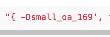

obdiag gather scene run --scene=observer.perf_sql --env "{ -Dsmall_oa_169', trace_id='E3E17471B60C1CDC709270A90AFE4FB9'}"
我执行这个以后,提示
ather_scenes_run start ...
gather from_time: 2024-11-20 16:31:10, to_time: 2024-11-20 17:02:10
execute tasks: observer.base
run scene excute yaml mode in node: 10.1.250.157 start
run scene excute yaml mode in node: 10.1.250.157 end
run scene excute yaml mode in node: 10.1.250.160 start
run scene excute yaml mode in node: 10.1.250.160 end
run scene excute yaml mode in node: 10.1.250.161 start
run scene excute yaml mode in node: 10.1.250.161 end
[ERROR] hard code scene execute failed, error :expected string or bytes-like object
Gather scene results stored in this directory: /root/obdiag_gather_pack_20241120165900/obdiag_gather_pack_20241120170110
Trace ID: fc7a0780-a71d-11ef-b074-246e9612af44
If you want to view detailed obdiag logs, please run: obdiag display-trace fc7a0780-a71d-11ef-b074-246e9612af44
这个错误是怎么导致的,我应该如何解决
这里格式不对,你参考下
https://www.oceanbase.com/docs/common-obdiag-cn-1000000001491226
